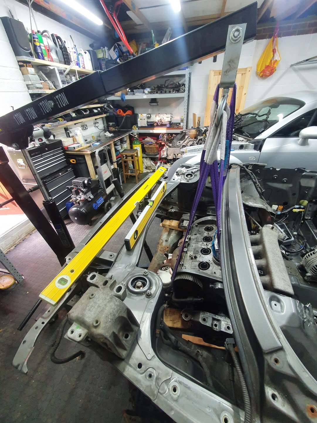

Apologies for the beginner questions, but I'm speccing up a small 1.2m by 0.6m plasma table for ~£2k at the moment, and have a few questions after reading the (excellent) primer, watching all of the
cymbal YouTube
, watching the
Making Stuff
series on it and the 'Everything in One Place' thread by Tommylight...
My current plan is
The (random) questions (so far!)...
Apologies again for the random questions, just formulating them as I go along...
I'm doing this as a means to design and make parts for my car (and engine swap!) addiction... See picture below of latest project!
Any help would be much appreciated!
Thanks all,
Chris.

It's an Audi TT 225 (VAG 1.8t) which I'm borrowing the whole lot out of, forging and big turboing (the standard K04-64 from E30 Golfs) to get a sensible, useable 350bhp / 350 lbft from, in the rear of the old (2006) Mk3 MR2 in the foreground!
Chris.

I use one THCAD10 for THC and one THCAD5 for ohmic sensing (still have not set it up Lol but its wired in) linuxcnc.org/docs/devel/html/plasma/plas..._with_a_mesa_thcad_5
Yes PlasmaC does have a synthetic ARC OK signal, Looking in the docs for PlasmaC I have found this, linuxcnc.org/docs/devel/html/plasma/plas...ide.html#reed-arc-ok , it outlines using a reed relay to generate a real signal. Might be worth looking into.
Like I said, my 7i76 have not given me any grief what so ever. Definitely worth the money!. I really have a soft spot for things that just work.
Sounds like a interesting project. When your plasma table is done, custom engine mounts and cross members will easily be within reach without having to pay large amounts for them. Explain that to the wife, it will save you money!
