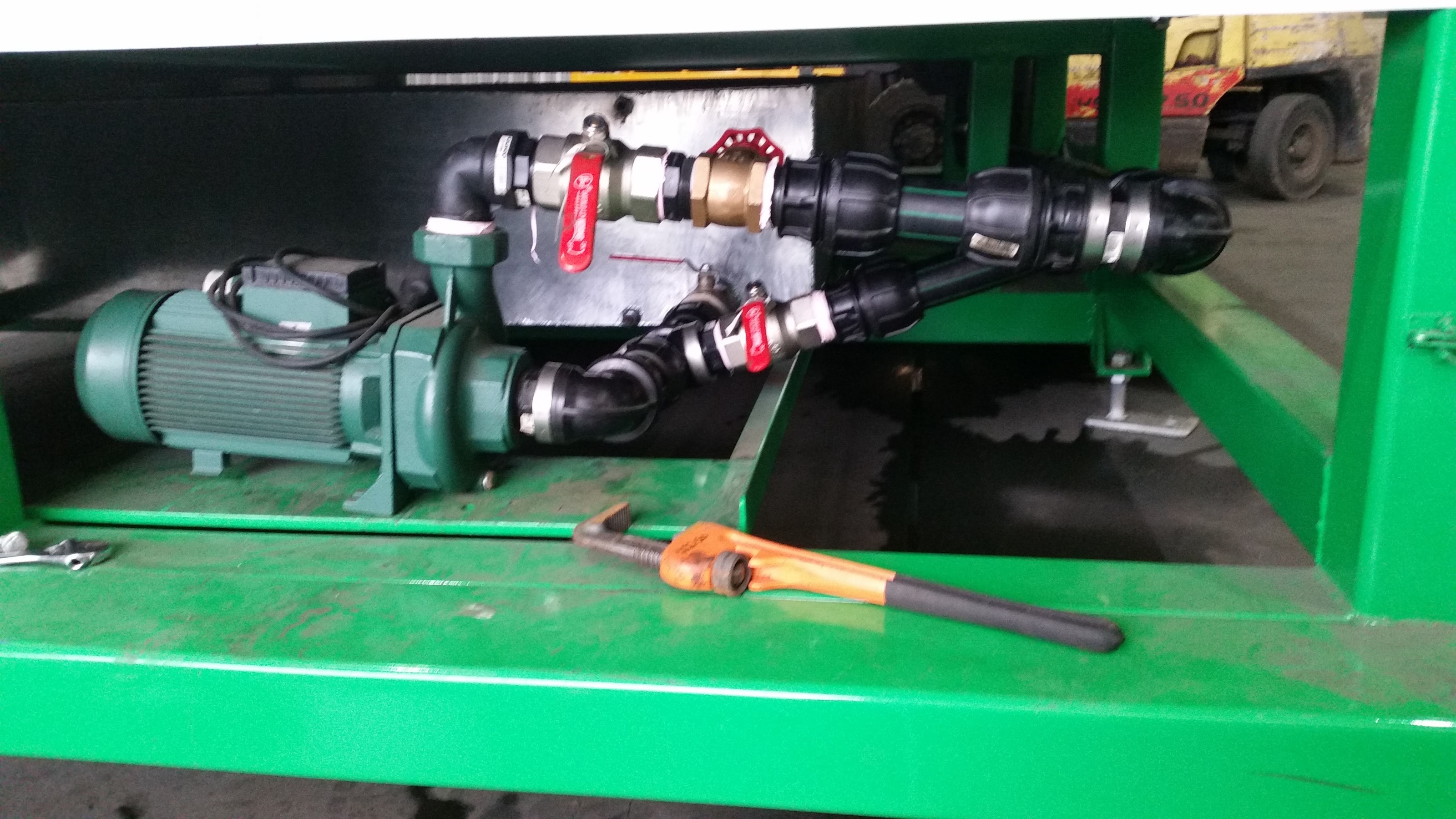

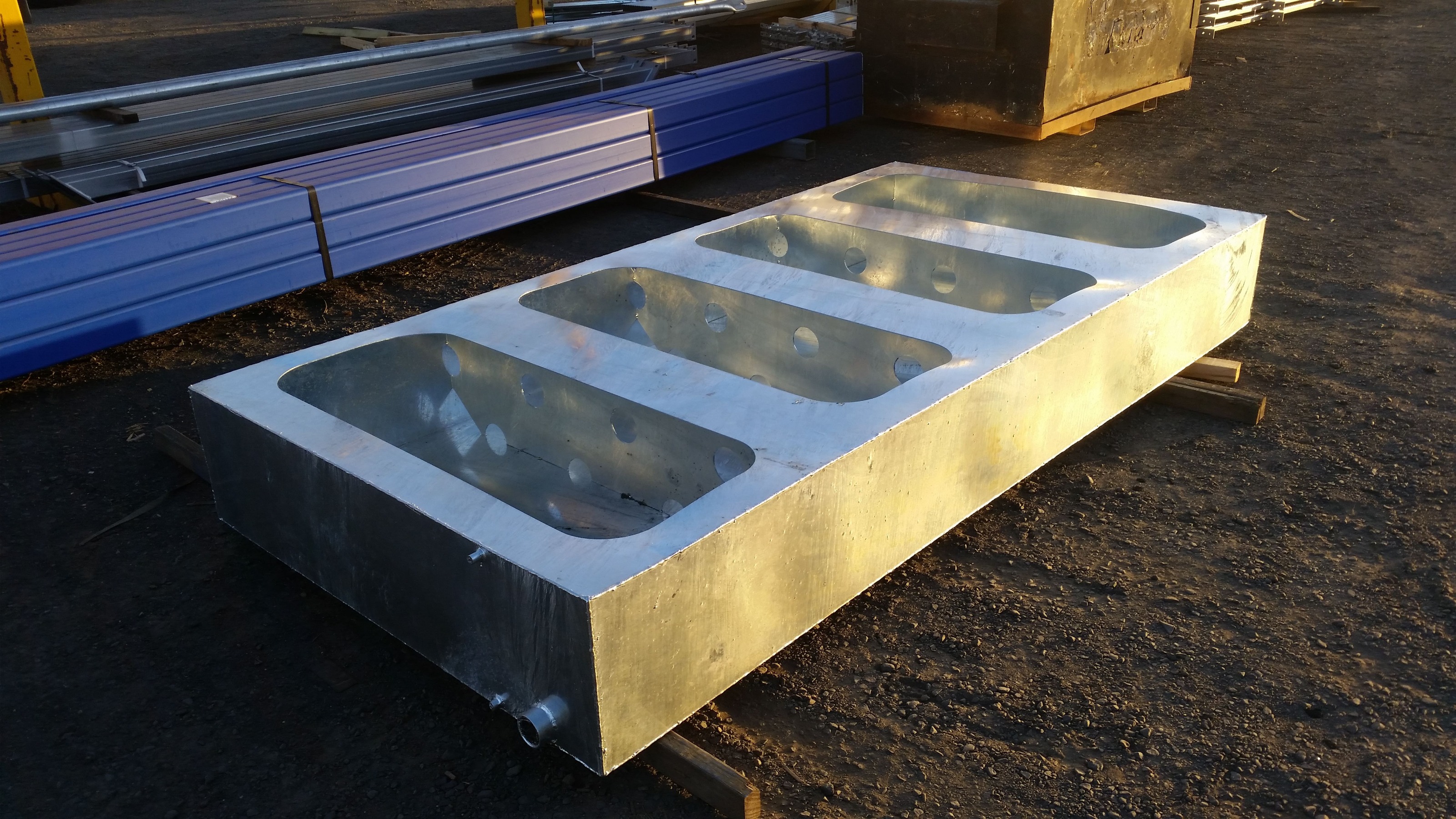

This is the tank I built for my table,
1000l/m pump to fill my water pan quickly.
But for a hobby machine as long as you can drain it when needed and fill it back up it should be fine without. Just make sure your draining it somewhere safe, the water gets pretty dirty. I would drain it out side and let it evaporate, although it will have a lot of steel particles in it.

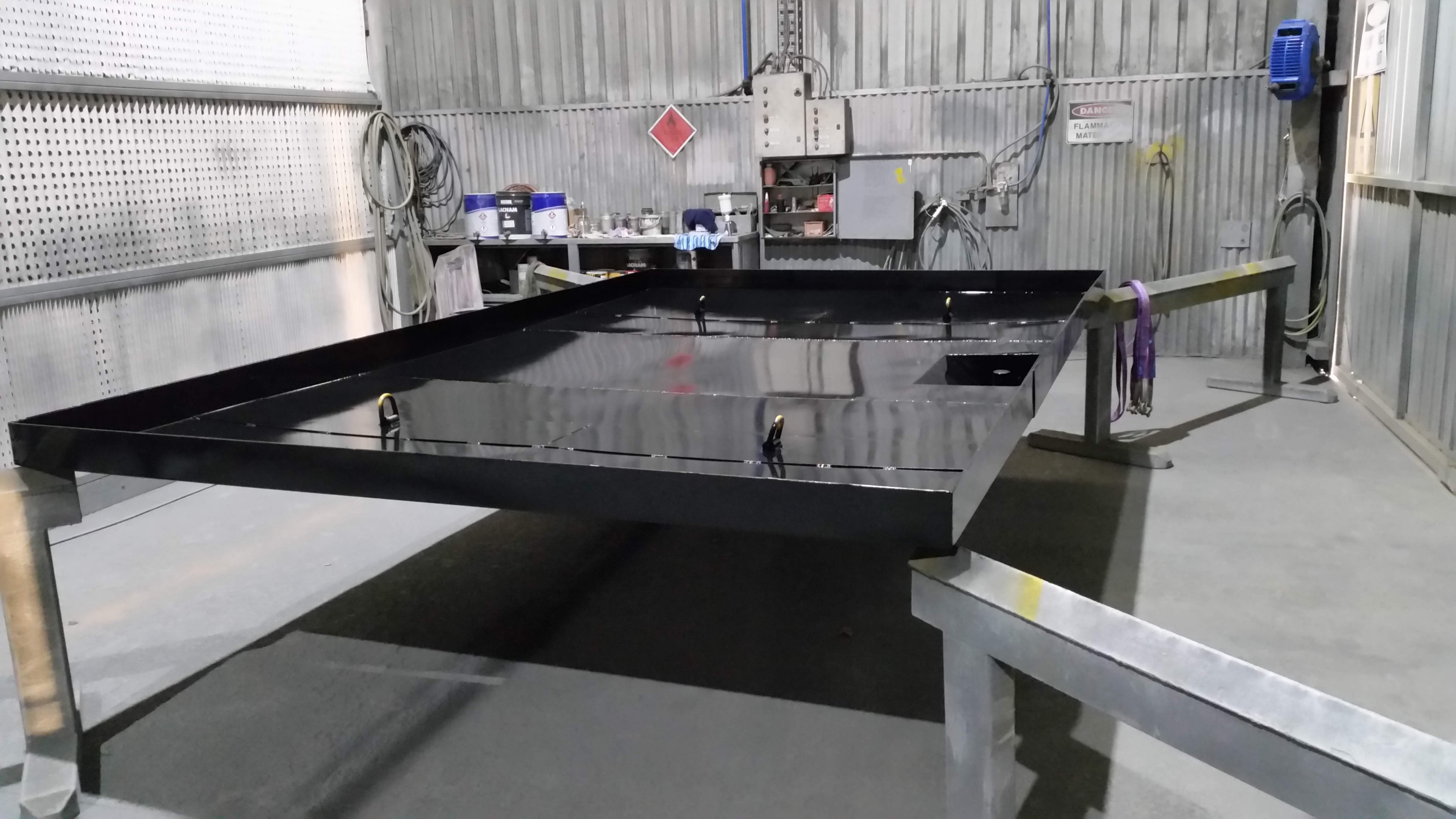

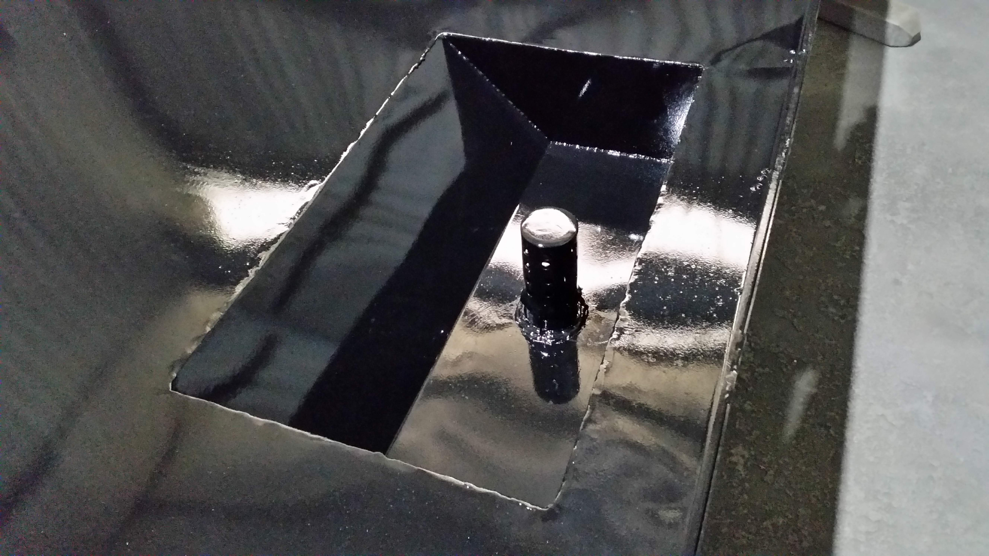

The pan is aluminium?
How does the pump survive when emptying all the fluid and metal particles?!
- thefabricator03
- Posts: 1130
- Thank you received: 531
05 Jun 2020 09:05 - 05 Jun 2020 09:06 #170217
by thefabricator03
Replied by thefabricator03 on topic 1.2m x 0.6m plasma, <£2k questions!:
No its steel and I had it hot dipped galvanized.
I have a filter on my pan output that filters the big chunks of steel. And when I drain it I have a pump bypass valve that the water goes straight into the tank. When I fill it the pump, pumps from the tank. I have not had any pump issues with this setup. Although the pump is an agricultural pump made for harsh environments.
The other option is to pressurize the tank and the air will push the water up. I dont like that idea as here in Australia the tank becomes classed as a pressure vessel and become a big pain in the ass to make and keep compliant. Also I just dont like the idea of having my guys using something like that in a workplace. To do a pressure tank properly cost a lot of money with testing certifications and such. If something goes wrong I could end up in jail. At least with the pump the worst that could happen is the pump breaks down or it leaks.

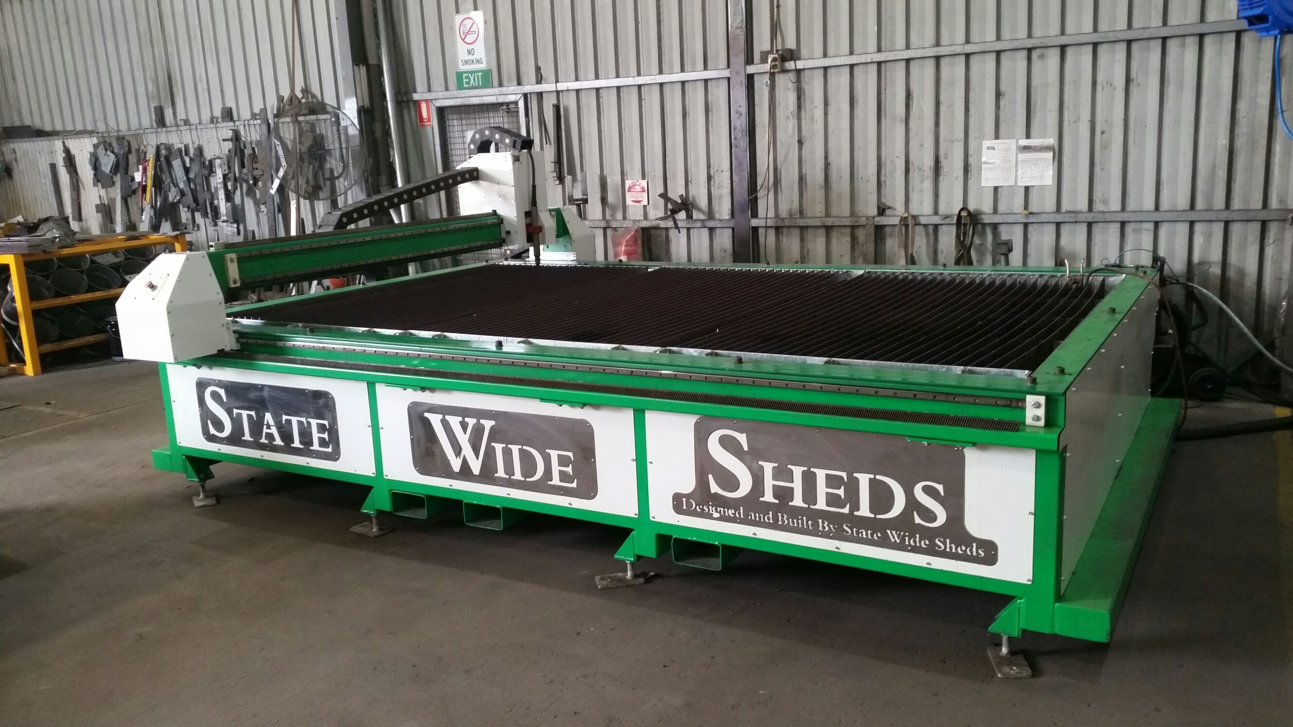

Stefan, I know why you won't trade it with me. It has to be the best made DIY table out there.

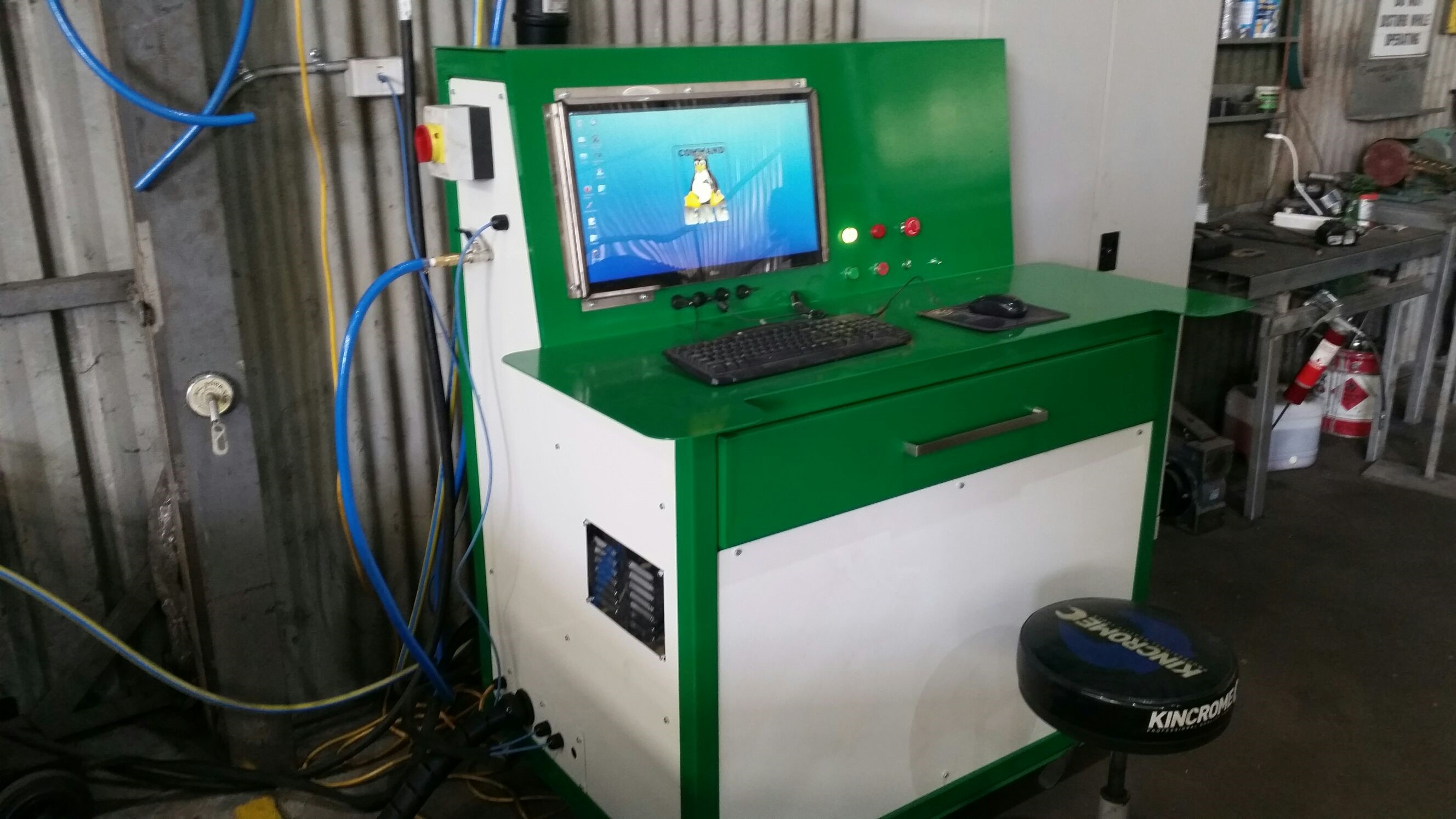

- thefabricator03
- Posts: 1130
05 Jun 2020 09:30 #170220
by thefabricator03
Not to hijack this thread but I am rather fond of my creation. All my years of fabrication experience came together to build it. My wife calls it my first born child Lol.

05 Jun 2020 09:34 #170221
by WinstonTodge
Replied by WinstonTodge on topic 1.2m x 0.6m plasma, <£2k questions!:
Looks fantastic! And massive... What rails did you use?
And what part of Australia do you live in? I lived there for 3 years a decade ago.
Just realised I need a new stool after that picture.
C.

by thefabricator03
I used HGR25's, duel on the X axis and single each side of the Y.
I live in a rural city called Dubbo in NSW.
And yeah the stool comes in handy.
