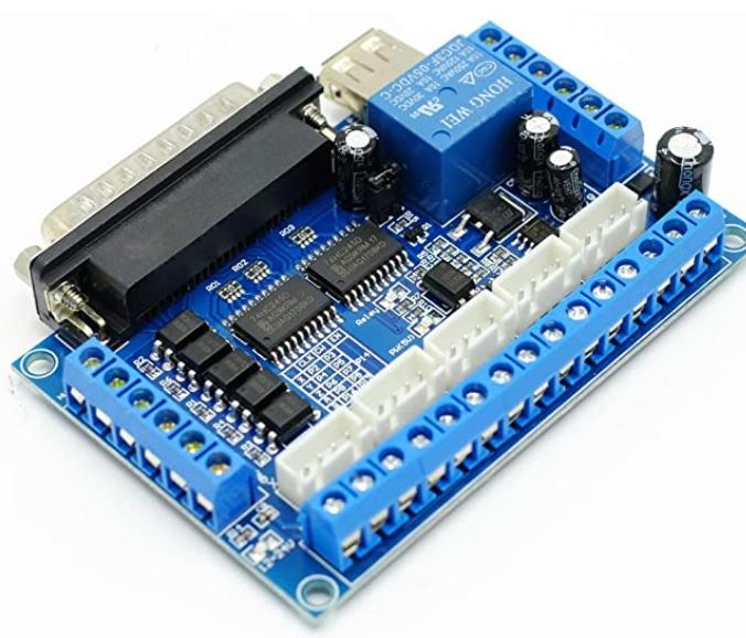

I need help with PWM configuration to control Sculpfun s9 laser.
I have MESA 7i76e with 5 axis breakout board and my intention was to use pin 1 on expansion header P1 to generate the signal.
I have flashed 7i76e_7i76x1_5abobD.bit file.
--readhmid shows
Module: PWM There are 1 of PWM in configuration
IO Connections for P1
Pin# I/O Pri. func Sec. func Chan Pin func Pin Dir
1 17 IOPort PWM 0 PWM (Out)
Changes to hal file:
num_pwmgens=1 (I understand this should enable hardware PWM)
setp hm2_7i76e.0.pwmgen.00.scale 100 (100% full scale)
setp hm2_7i76e.0.pwmgen.pwm_frequency 1000 (1 Khz)
setp hm2_7i76e.0.pwmgen.00.output-type 0 (I only need PWM signal)
This started 1st problem. LinuxCNC could not accept value 0 >> hm2_7i76e.0: switching to 1 (PWM & DIR)
How I can be sure the PWM singnal in on PIN 1 (P1) and not on STEPGEN pins?
The two below lines were accepted.
net laser_pwm_on => hm2_7i76e.0.pwmgen.00.enable
net laser_pwm_value => hm2_7i76e.0.pwmgen.00.value
I tried to test if I can change the values by linking pwm_on and pwm_value to e.g. halui.program.is-running, halui.spindle.0.is-on
without success.
Tried also
net halui.program.is-running => hm2_7i76e.0.pwmgen.00.enable
I received error message: signal name 'halui.program.is-running' must not be the same as pin. Did you omit the signal name?
On pin gpio 17 I measured 5v. Should the below be used in this instance?
setp hm2_7i76e.0.gpio.017.invert_output true
I have attached all relevant files.
Any advice is appreciated.

15 Mar 2022 23:11 #237405
Replied by PCW on topic MESA 7I76e + BOB - Hardware PWMgen configuration for laser control
"net halui.program.is-running => hm2_7i76e.0.pwmgen.00.enable"
needs a signal:
net laser-on halui.program.is-running => hm2_7i76e.0.pwmgen.00.enable
needs a signal:

16 Mar 2022 09:03 #237445
by Archidea
Replied by Archidea on topic MESA 7I76e + BOB - Hardware PWMgen configuration for laser control
Thank you Peter,
I got stuck on basic things. I should be ok now.
