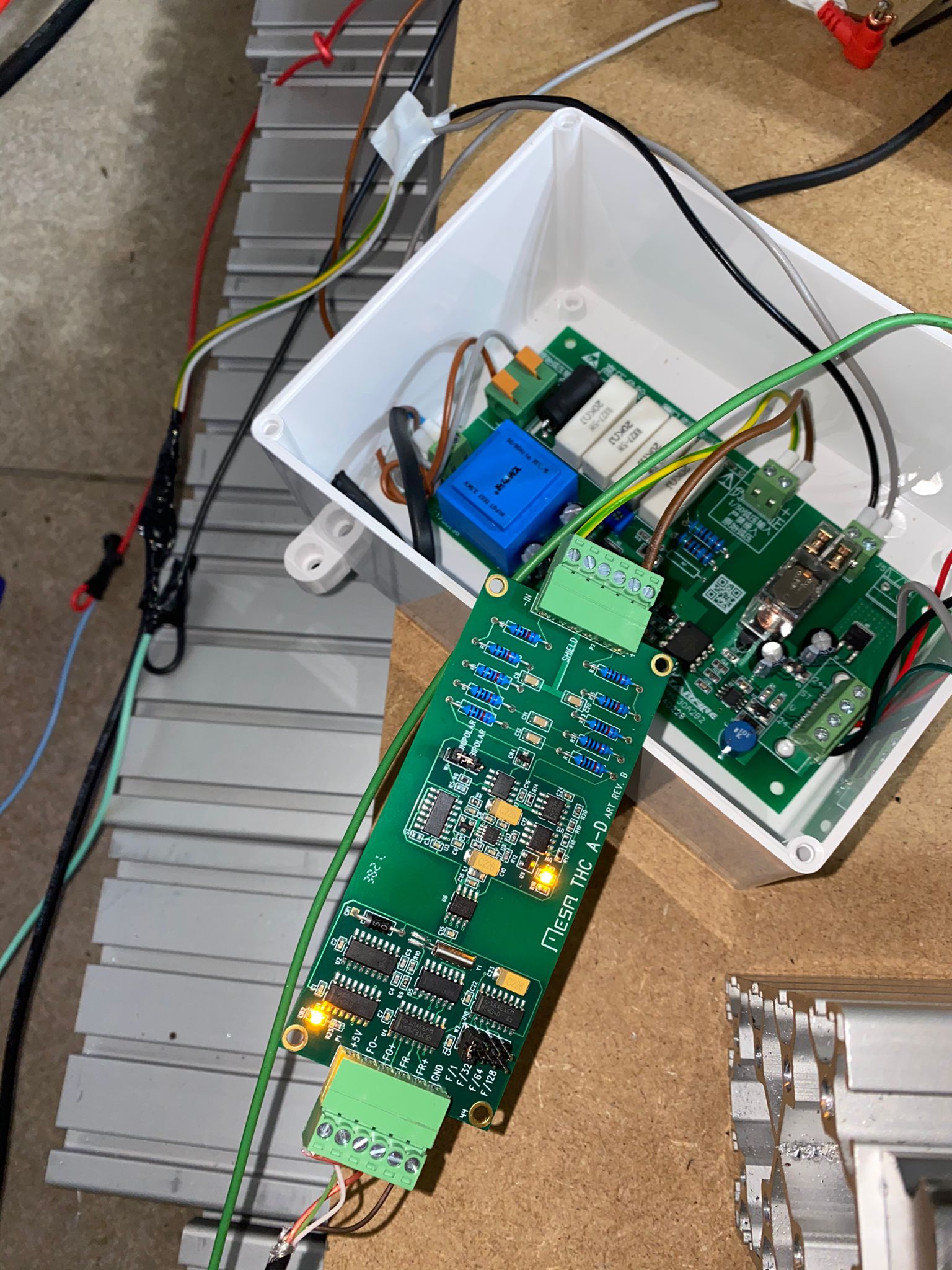

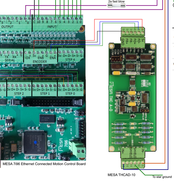

Hi everyone.
Im using PlasmaC and a Mesa 7i96s board to control a plasma machine, with type 1 THC Configuration (voltage for Arc Ok and Thc signals).
I manage to move all axis, probe, and activate the arc, but the THC has an issue.
My voltage divider has a built in relay for triggering the plasma, so i'm using that. It outputs a 1:50 voltage division, but i am not obtaining any values in the encoder value. What could be wrong?

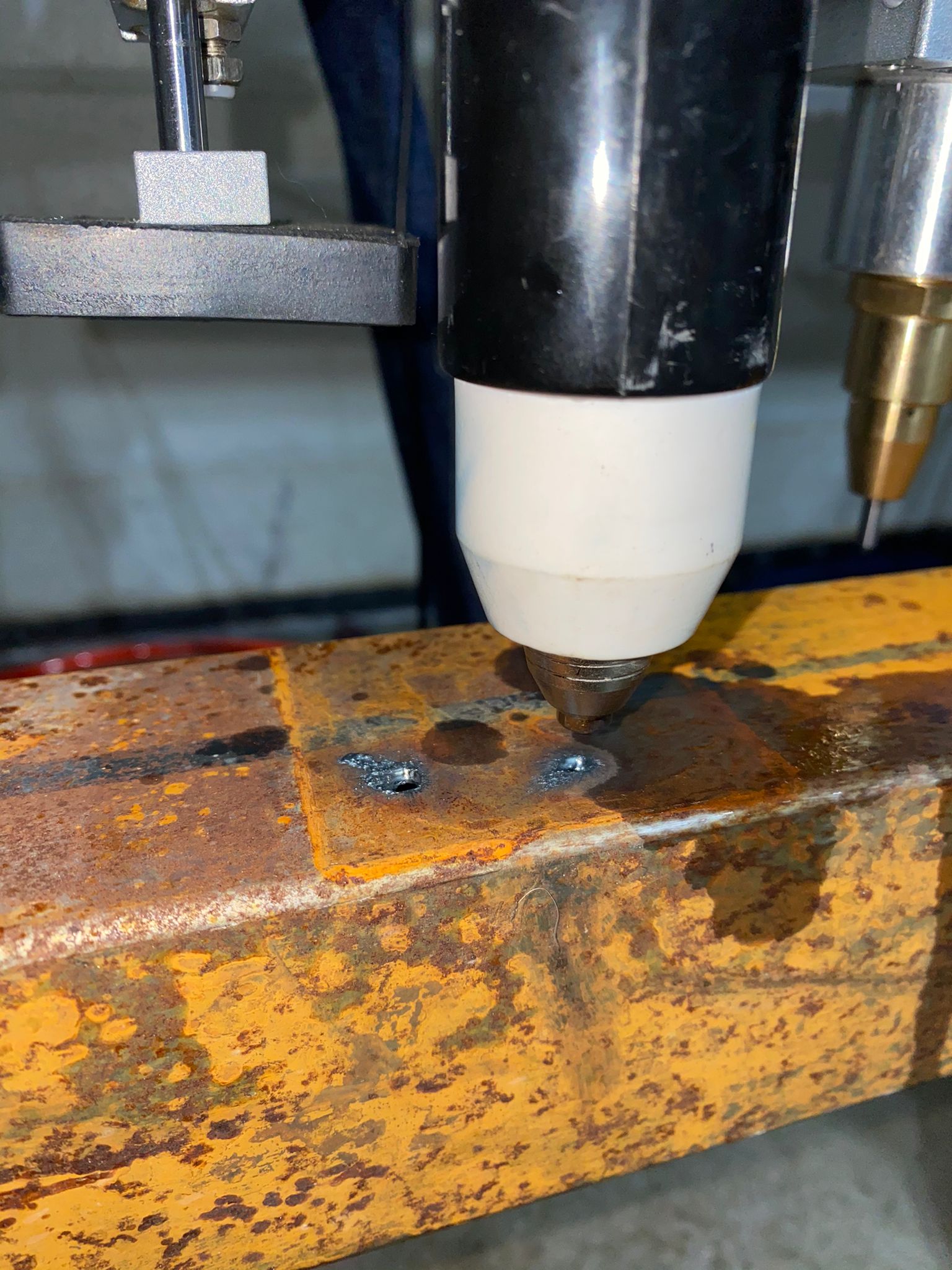

Also, im using sheetcam Plasmac post processor, and the "probe sequence" is performing 2 probes for each pierce. is this normal? can i reduce the number to just 1 probe?
Thank you!

Can you see a change in the THCAD blink rate with plasma voltage
on/off?
Have you tried the F/32 THCAD option
(you will not be able to read full scale input with default
encoder settings and the THCAD set for DIV1)

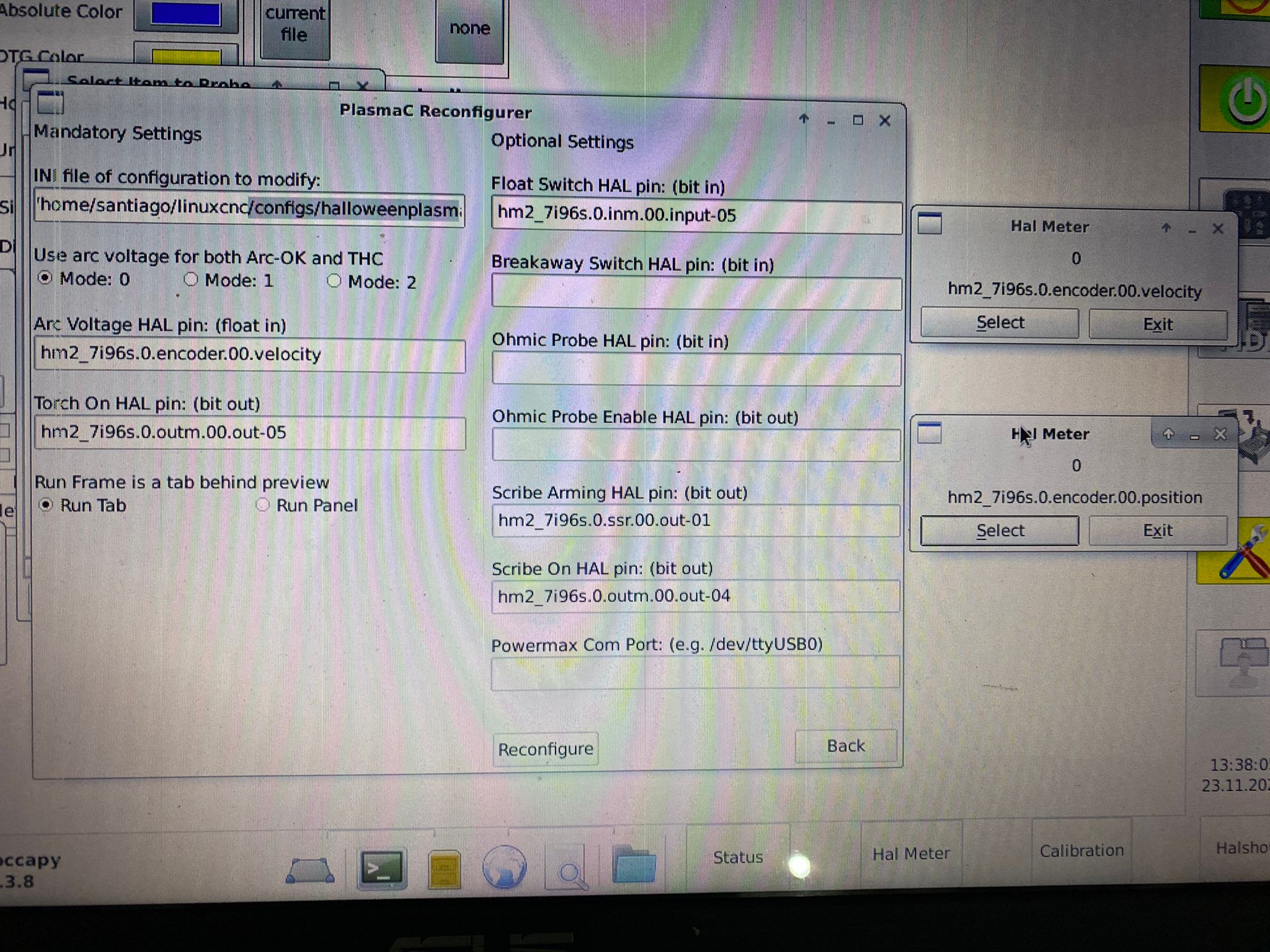

If you look at the encoder velocity in halshow and its not bouncing arround near 3800 (eg its static), there are some settings missing in your hal file. I think they are covered in the Plasmac docs.

You will get two probes if the probe height is below the top of the material.Also, im using sheetcam Plasmac post processor, and the "probe sequence" is performing 2 probes for each pierce. is this normal? can i reduce the number to just 1 probe?

i believe i might be missing the frequencies and some other values which are asked by a prompt in QtPlasmaC. But im using PlasmaC only, which only asks for the voltage encoder port.
i wouldn't know how to change these values in the hal file directly, so i am trying to switch to qtplasmac (which seems to have an even better user interface)
Tried running " qtplasmac-plasmac2qt " in a terminal to switch from plasmac to qtplasmac but the command didnt work.

Seems like you’re just starting out, so I recommend using pncconf and choosing qtplasmac as the screen which will do everything for you, including the calculations for the thcad.

guess i'll have to update from linuxcnc 2.8 to 2.9.
