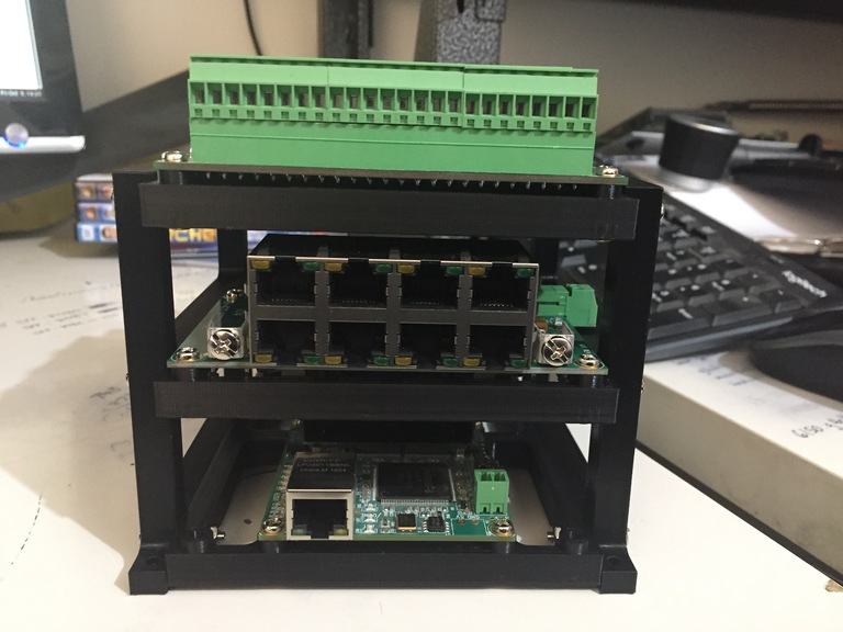

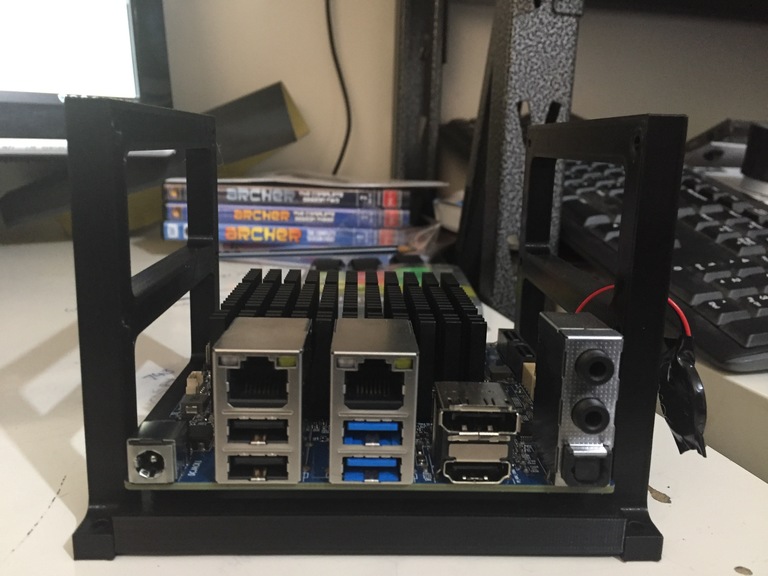

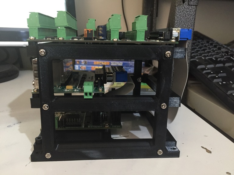

So it's about time to clean up the electricals, mainly due to having to house the electrics for the spindle controller & changing from a Mini ITX Board to the Odroid.
So I thought the best place to start would be with said Odroid and some where to put the Mes 7i92, 7i74 & &776. So this is the first prototype. Odroid still needs a mount for a fan and a holder for the battery. If the mill was going I may have made them out of Aluminium, but for now they are just 3D printed.

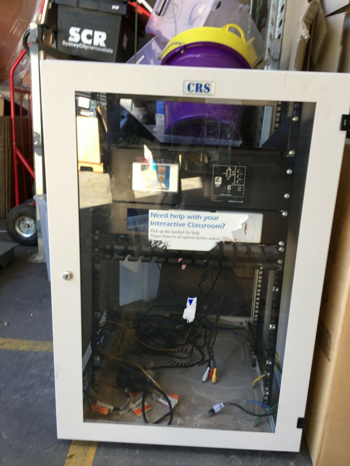

Also picked this up off ebay, size is 600x600x900. Is now on castors has been cleaned out and I need to pick up 2 small pieces of sheet metal to mount things on.

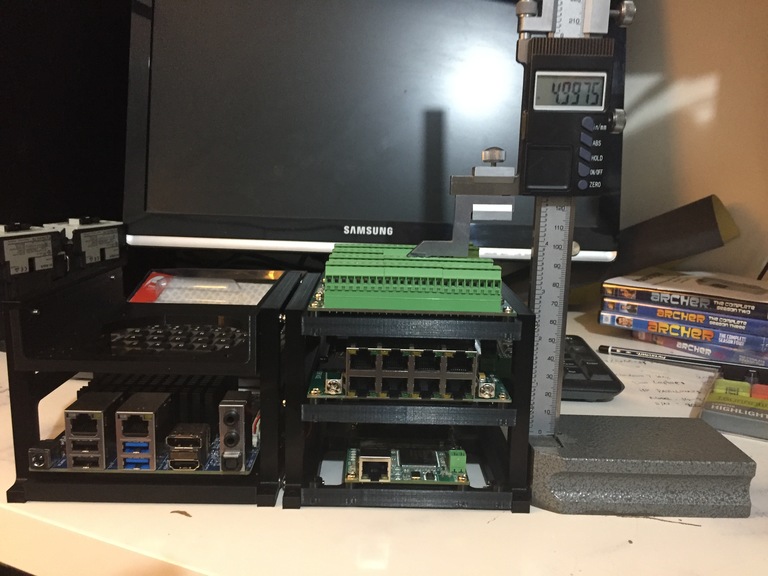

Looks good. It would be good to include a pic with a ruler so people get an idea how small your controller frame is!

Horizontal sleds mount on 1.75" centres. Overall height just a tad under 5". Would fit in a 4U rack case. Height gauge is resting on top of connectors.
Just for reference the Odroid is on a 110x110mm board, smaller in area than a 120mm pc fan. Overall hieght is 47mm that includes the Ram & NVME drive mounted underneath.
Frame for Odroid now has a prototype sled for a fan, it will need a bit of tidying up which I'll do once the fan arrives. The Odroid uses a 5V PMW fan so I had to order a Noctua fan from Amazon US.
Sorry about the crap photo.
Looking from front)
Mesa frames are 5 wide (incl uprights)x 5.25 deep, sleds are 4.250 wide (not incl uprights).
Odroid frames are 5.33 wide (incl uprights) x 5.25 deep, sleds are 4.580 wide (not incl uprights)
