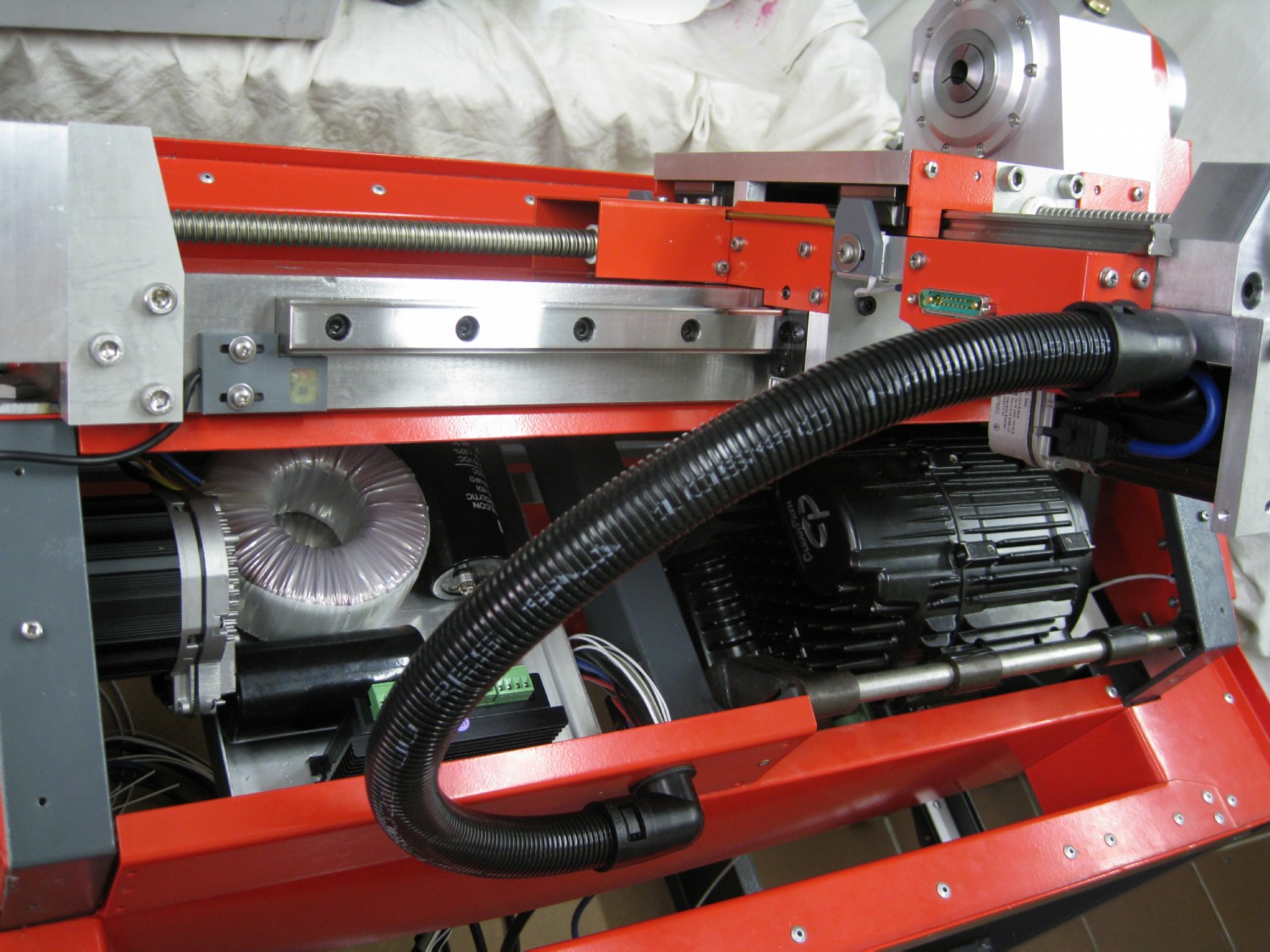

Home designed and built 5C CNC lathe with ATC and C_Axis
18 Mar 2021 15:30 #202749 by NoJo

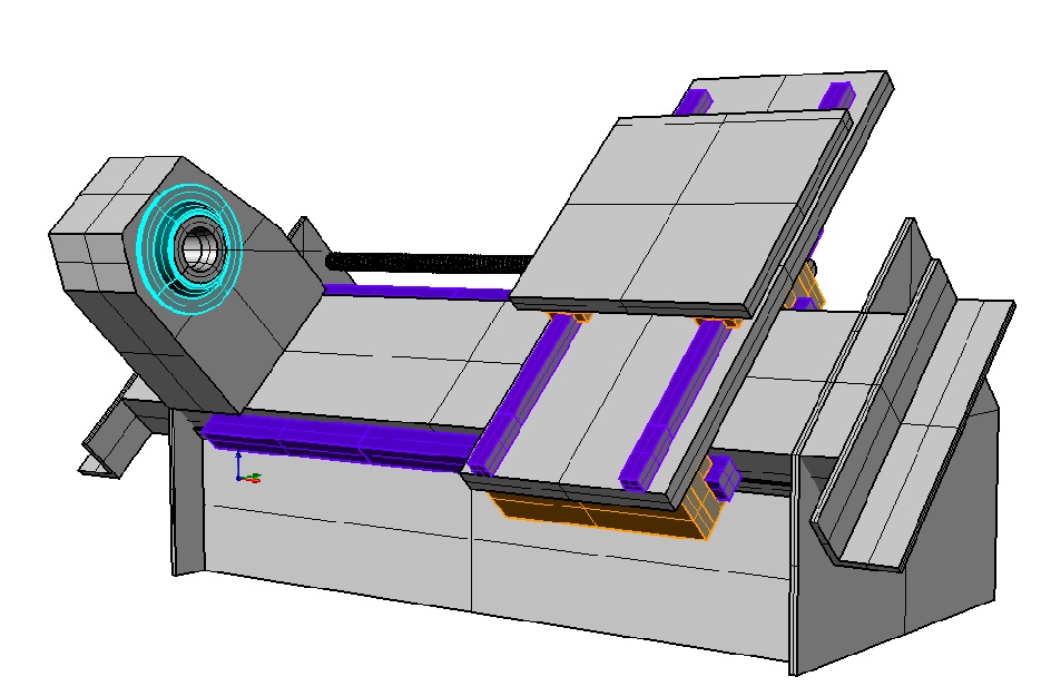

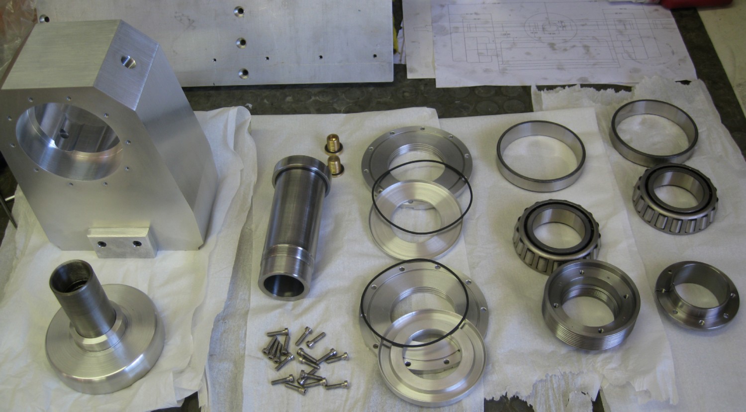

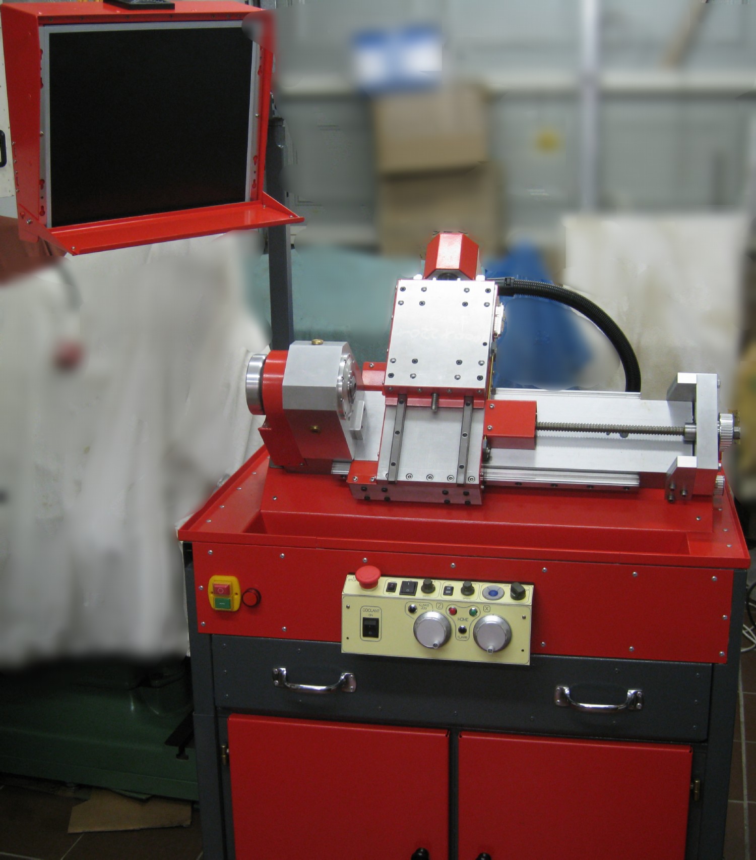

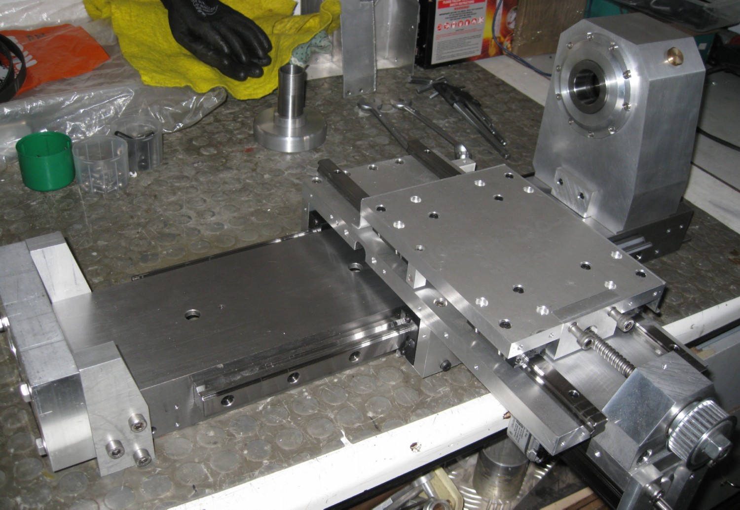

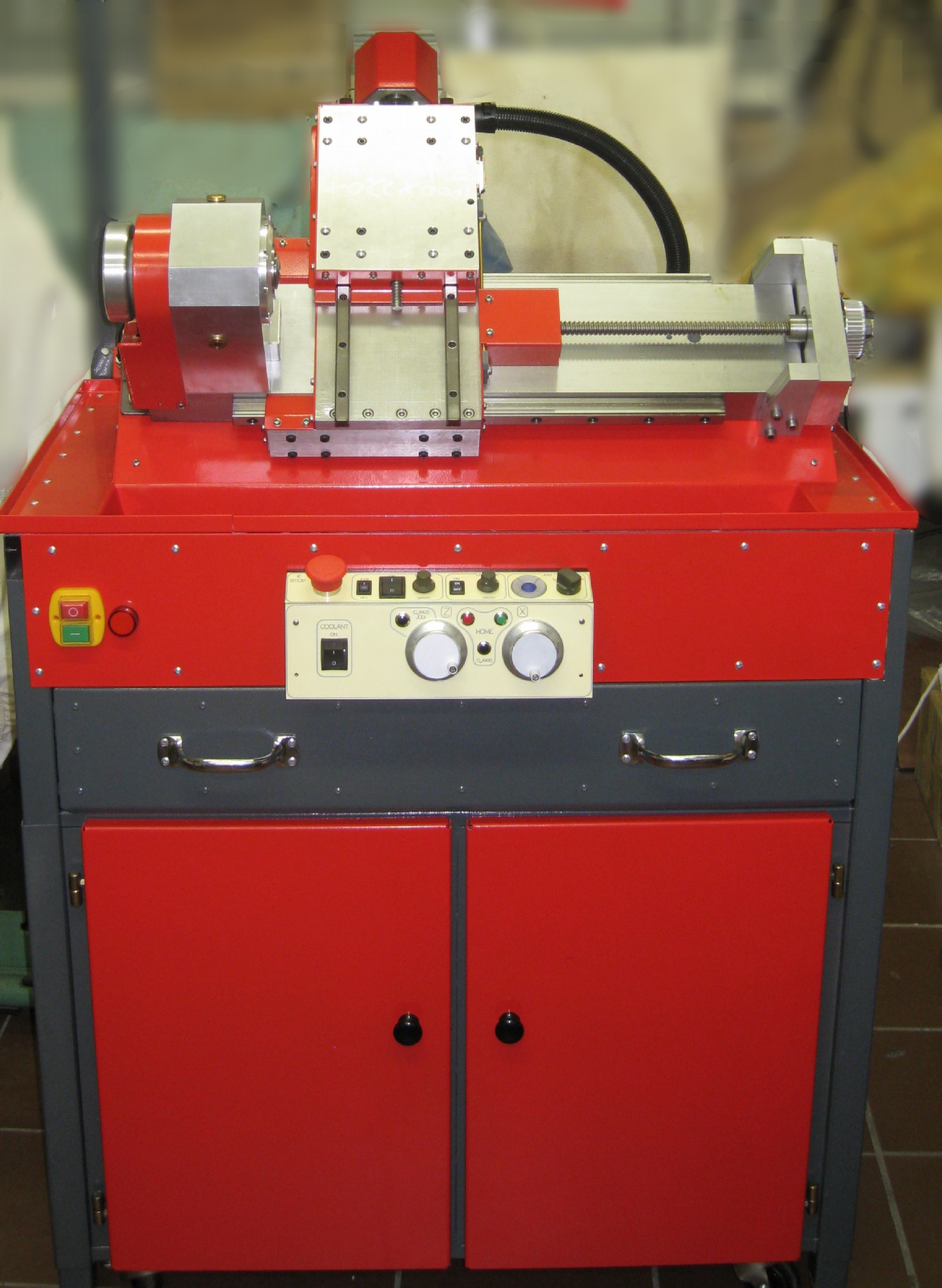

Hi Everyone, from Swakopmund on the Namibian West Coast!
I have built a number of CNC routers, engravers, converted some EMCO FB-2 Mini-Mills to CNC, all using MACH3, all working very nicely.
I have had a many year hankering to build a 'small' hi-speed lathe , with ATC, limited liver tooling and C_axis, and so last year the project started. The main lathe is complete, with ATC and Live Milling spindle still under design!
The lathe ( excluding cabinet, etc) weighs in at 67kg, so ended up not so 'small' !

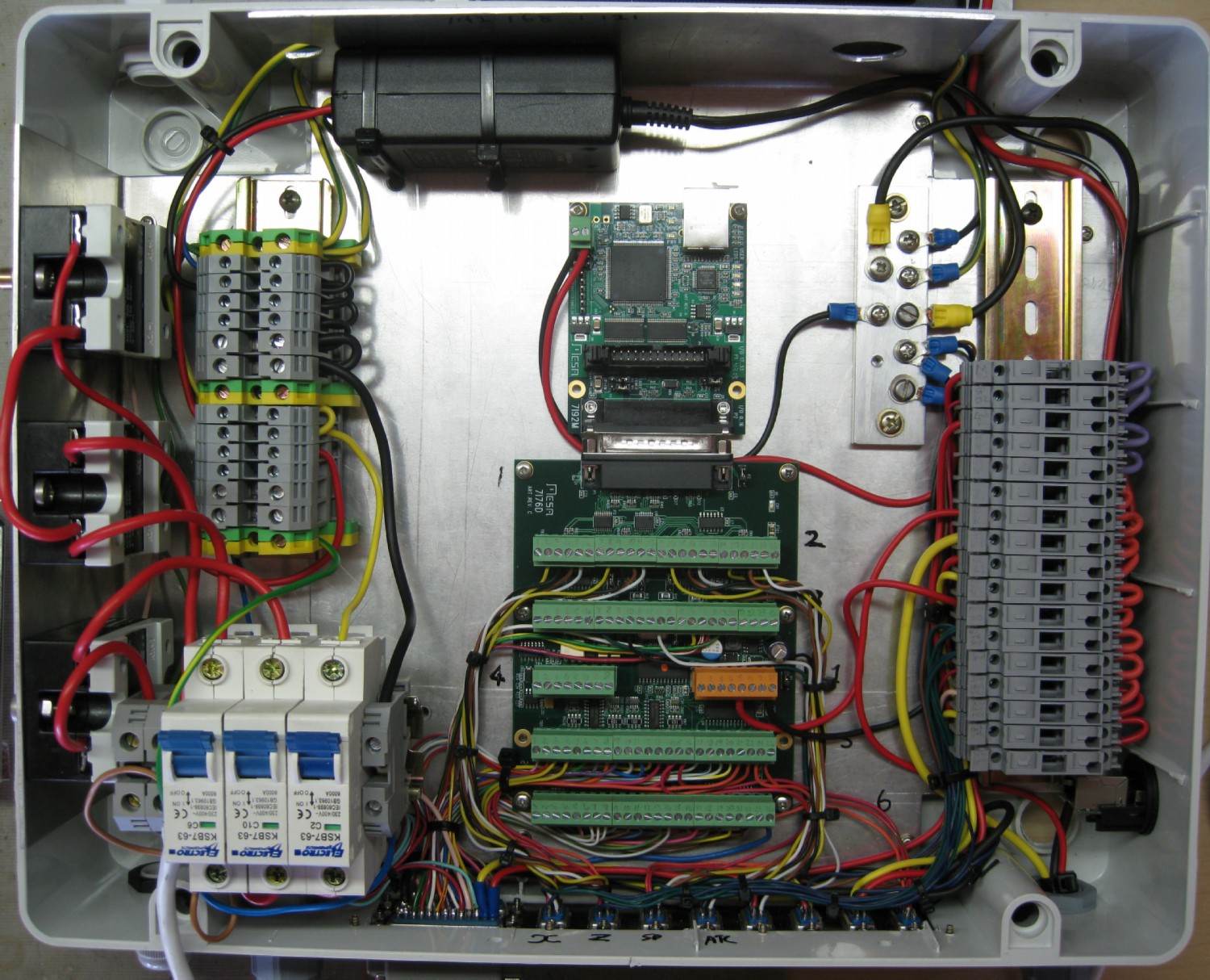

X and Z are driven by ClearPath closed loop brushless drives. The main Spindle is a 2KW ClearPath brushless drive as well, with 0.0225degree angular position accuracy.
25mm slides on Z and 20mm on X.
I/O cards are MESA 7i92:7i76:7i73.
The lathe was first developed on CAD - a full 3D model, and then machining drawings made and the lathe made from them.

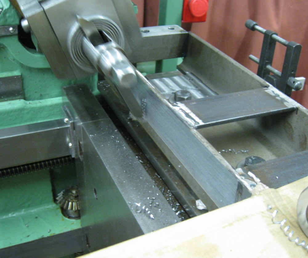

The lahe bed was machined on a 1954 ALBA Shaper, one I re-built and fitted with NC controls...
Some photo's show what happened...

I have not got the gubbins connected to the machines motors yet - its all on the bench in the study for convenience, but I can jog the displayed axes via the GUI mouse buttons, but the axes do not jog via the operator controls ( Jog buttons or handwheels) although Hal show/watch shows jog encoders counters changing, etc.

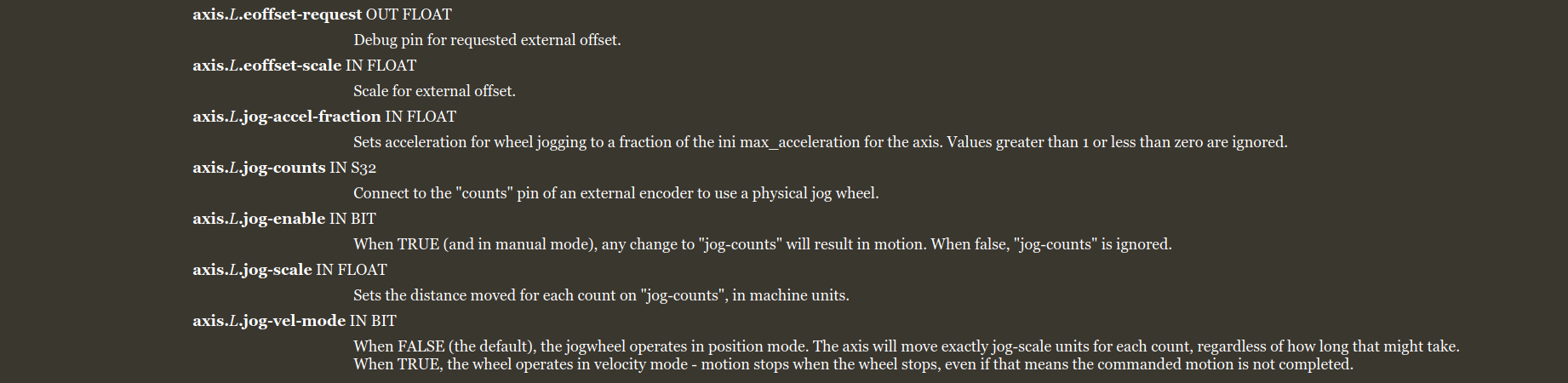

20 Mar 2021 08:52 - 20 Mar 2021 08:53 #202946 by Aciera
Nice machine.
Note that if your machine is not homed then it has only 'joints' as 'axis' are only created after the joints are homed.
As for HAL there are basically two ways to go about defining a signal: I call it Singleline and Multiline:
Singleline:
signal  <= out-pin => in-pin signal => in-pin
Multiline:
signal  <= out-pin
signal => in-pin
signal => in-pin
Of course you can also mix the two.
Note
1) that 'signal' is an arbitrary name you chose but is has to be unique for every signal defined (kind of like a variable name)
2) that the '<=' and '=>' are used for the human reader only to make it clear from which OUT-pin the signal is coming and to which IN-pins the signal is going to.
3) a signal can only come from one single OUT-pin but can go to one or several IN-pins
How do we know which pins to use? For that you can use the HAL-show list on the left side of the window. This you seem to have found already.
Or there are 'Man-pages' in the documentation here is an example for the 'motion'-Pins:
linuxcnc.org/docs/html/man/man9/motion.9.html
This gives a description for all the pins available

Linuxcnc makes a difference between joints and axis. Think of joints as motors and of axis as your cartesian axis X and Z. In your case the two are basically the same since you use 'trivial' kinematics but there are also other machines where the kinematic is 'non-trivial' as for 5axis machining or robotic arms for example. Suffice to say that for more complex setups joints and axis have been separated in LinuxCNC.
Joints CAN be jogged before homing but the pins used are different i.e. joint vs axis. LinuxCNC does have vast capabilities but I believe it would be unwise to jump in at the deep end. The PNCconf has been added to provide an easy first setup to get a basic machine up and running otherwise things can get VERY frustrating. That is why I suggest to do that on the actual machine and then get more fancy once the basic setup works.
