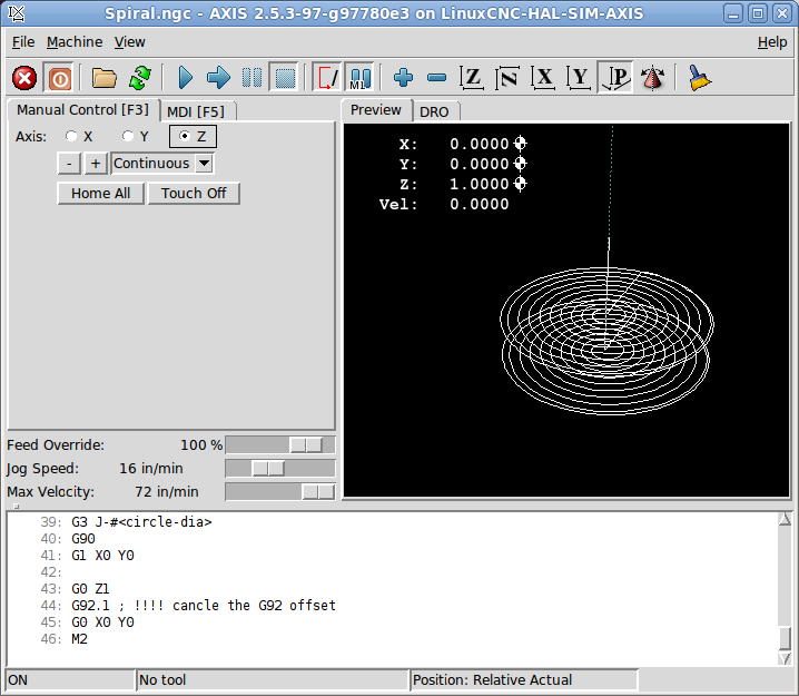

Here is an example of using polar, G92, incremental and named variables to cut a counter bore pocket.
JT
