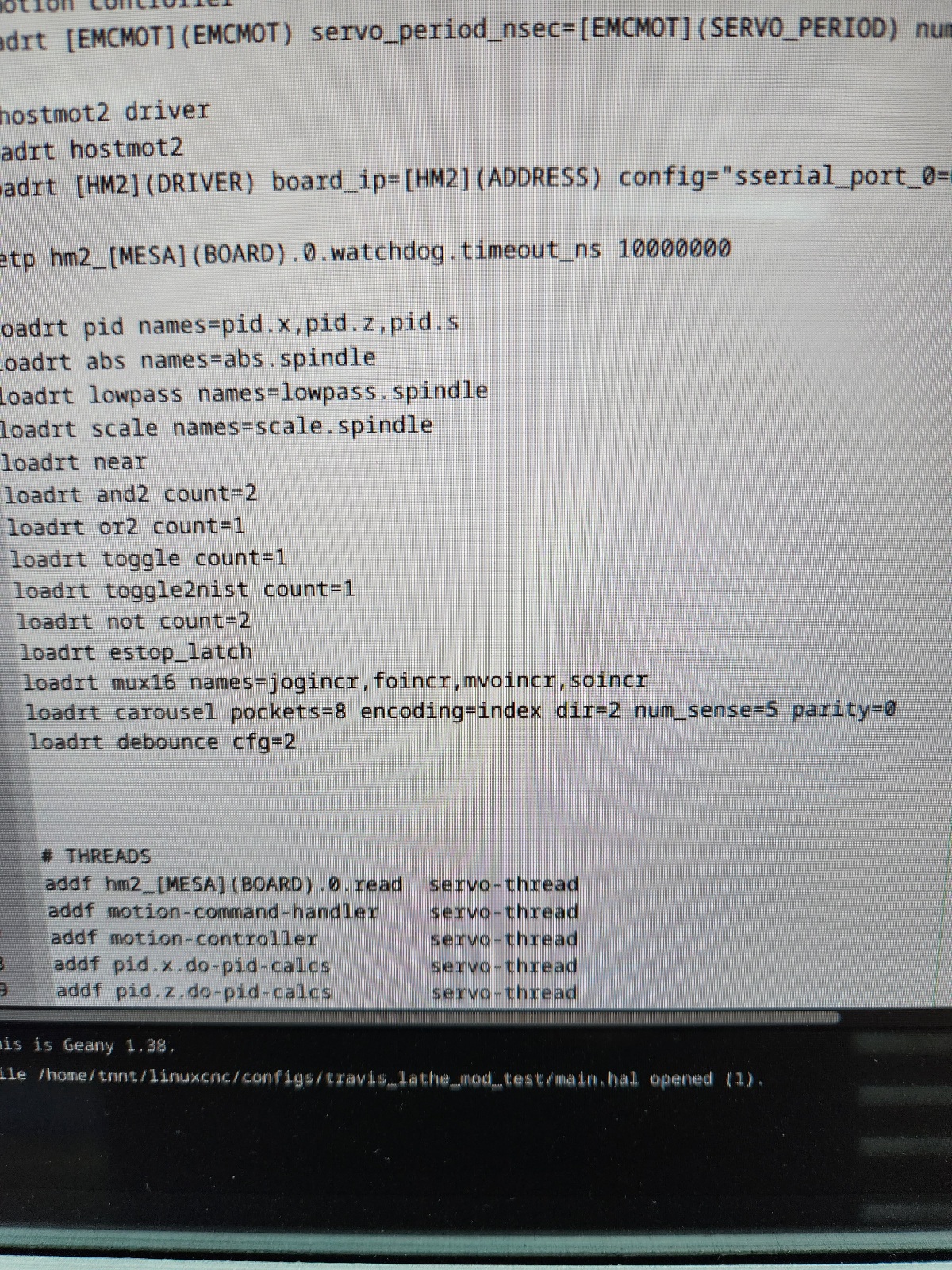

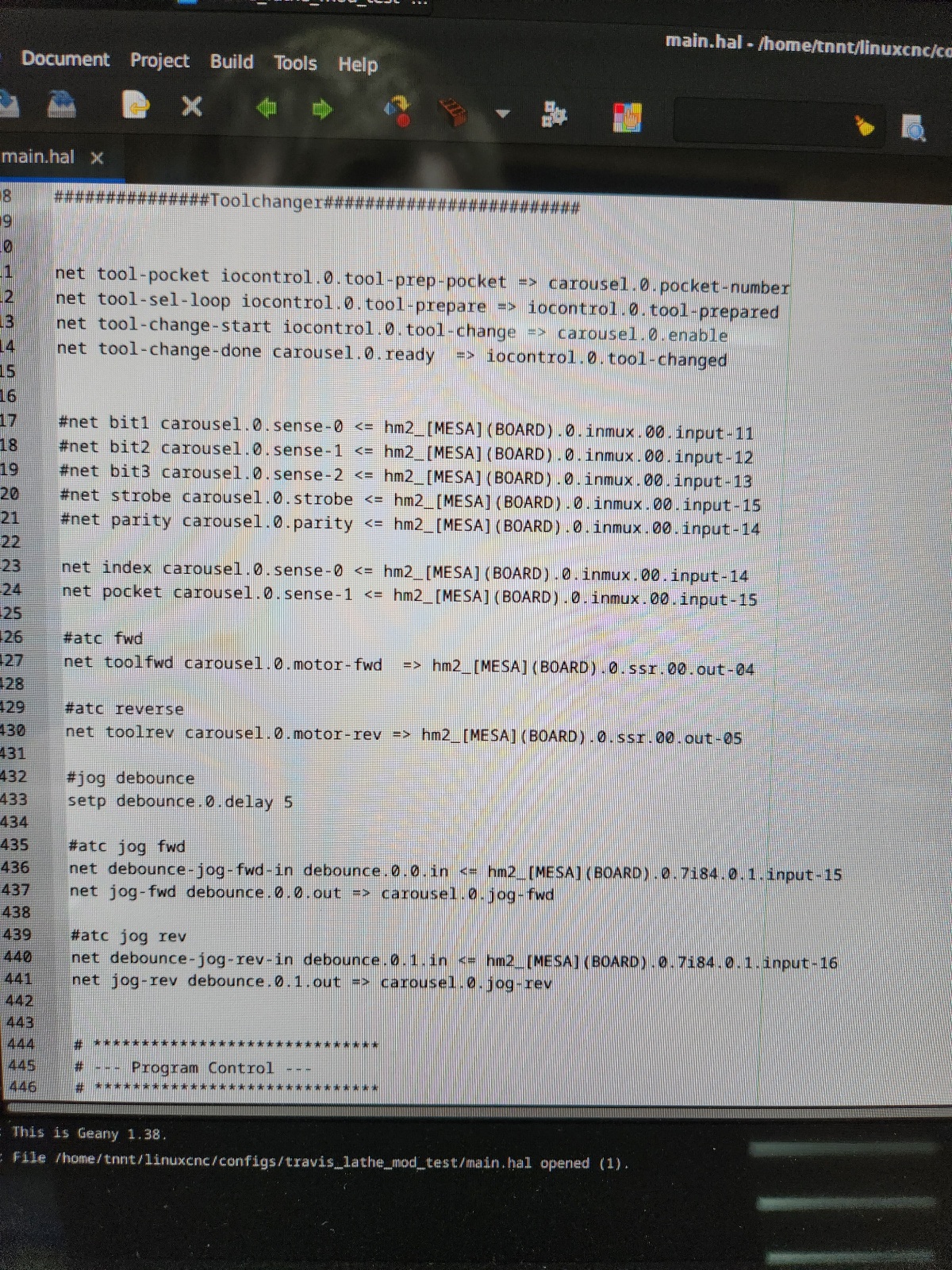

16 Oct 2023 22:37 - 16 Oct 2023 22:40 #283142
by Trav328
Replied by Trav328 on topic Lathe turret tool changer with absolute encoder
Here is a quick video that demonstrates my issue, hopefully something simple I missed.
Also some pics of my current tool changer in hal
youtube.com/watch?si=e2___Kt5mBWzWcxB&v=...mNo&feature=youtu.be
Last edit: 16 Oct 2023 22:40 by Trav328.
18 Oct 2023 16:34 #283243
by Trav328
i managed to get it selecting all tools last night , the problem was in my tool changer section , this is what wound up working if anyone else has a problem.
net tool-change iocontrol.0.tool-change => carousel.0.enable
net tool-changed iocontrol.0.tool-changed <= carousel.0.ready
net tool-number iocontrol.0.tool-prep-number => carousel.0.pocket-number
net tool-prepare-loopback iocontrol.0.tool-prepare => iocontrol.0.tool-preparedm6 remap
next onto the m6 remap and electronic "range" selection, i do plan on continuing to try and get that encoder working and i will update this when i do.
