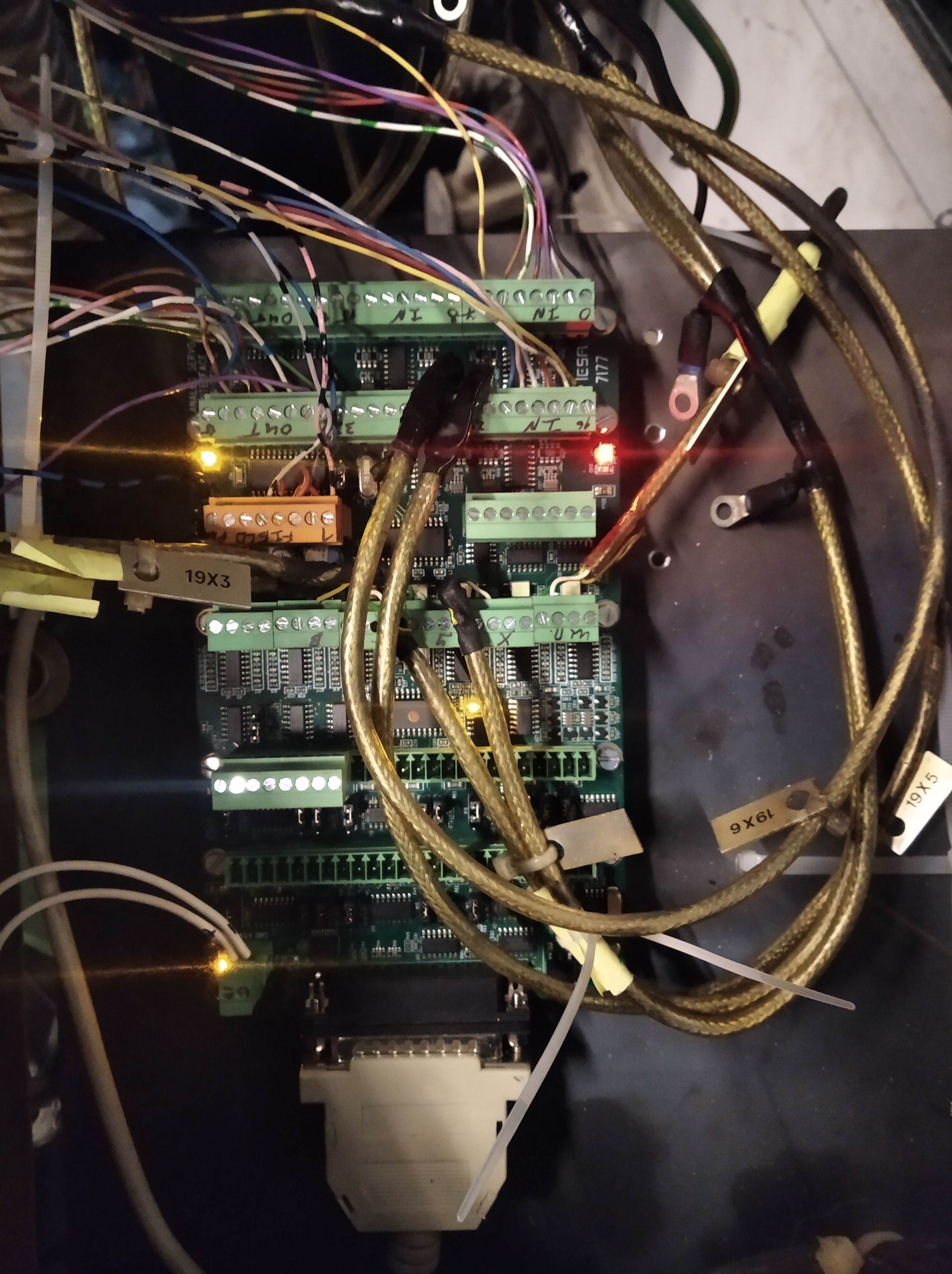

Hello,this is my first topic here and first touch with linuxcnc and mesa.
Two weeks ago my Philips CNC 432 system passed away .
After base wireing of the mesa cards the machine is almost alive....But i have some problems with the spindle drive adjustment.
The spindle is powered by a servomotor with Indramat TRK6U driver. First trials ,before the Classicladder for the gearbox change was ready ,there

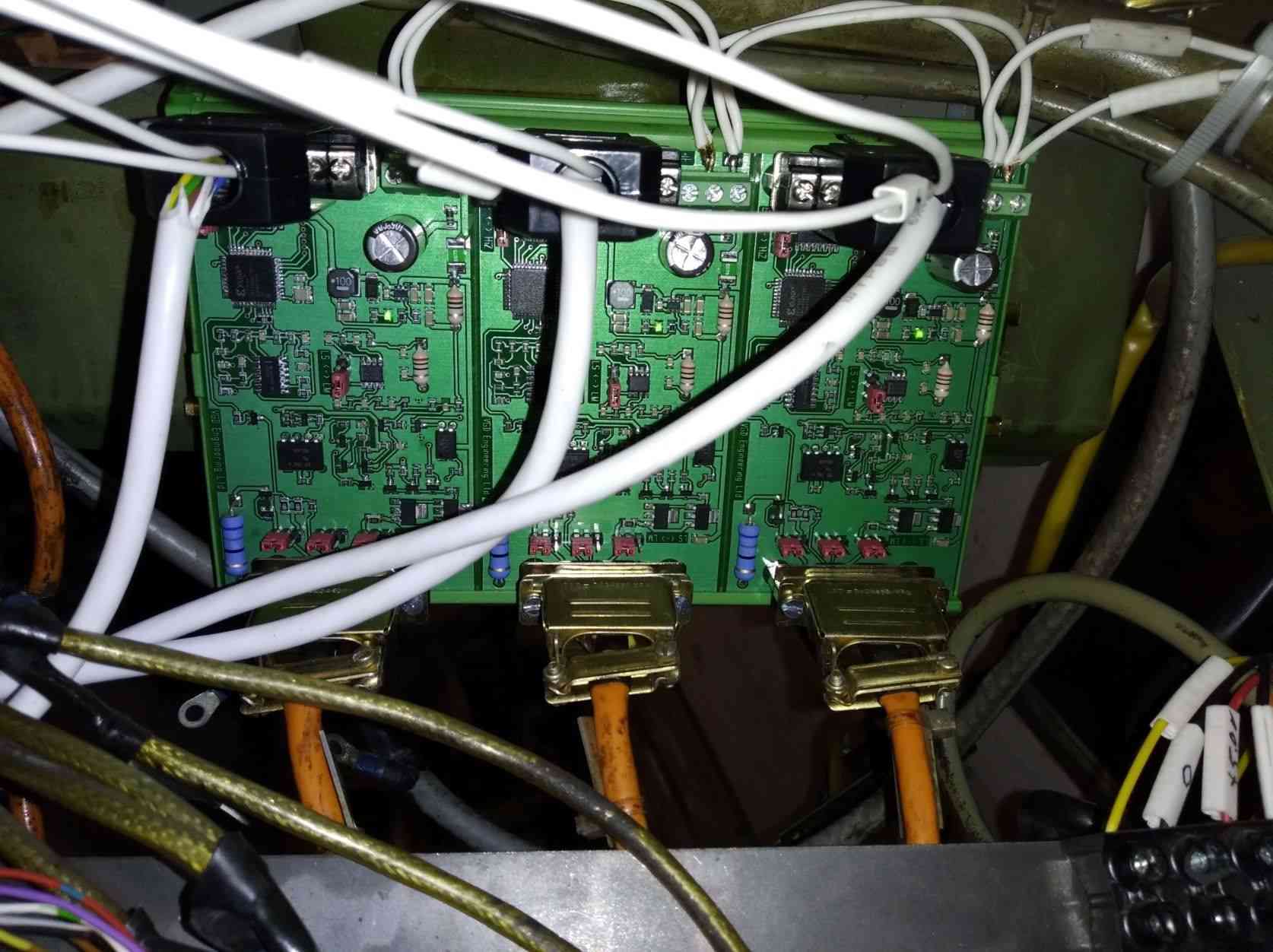

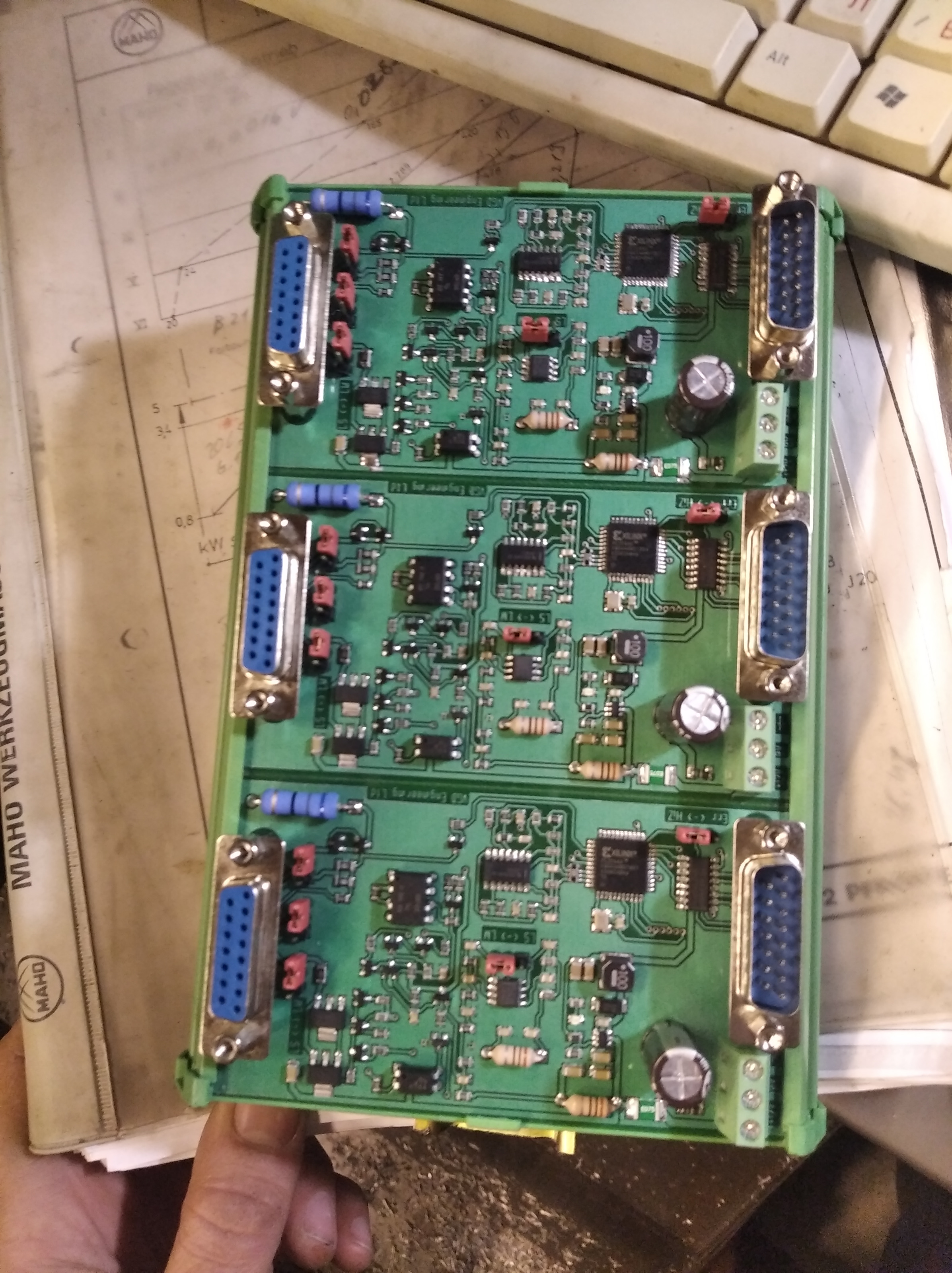

31 Jan 2022 20:36 - 01 Feb 2022 08:02 #233668
by Sando
Replied by Sando on topic Another one MAHO (MH600C) In the LINUXCNC club
Hi. The limit switches are connected in series with the e-stops so there is not a problem,and there is no need to connect with linuxcnc., It is possible other types linear scales to have integrated zero mark or something like that ,But in my case the scales and home switches are separeted. And as it is shown on the scheme in the previous post(8S2:8S5;9S2;10S2) are conected to 0V but there are a resistors 10KOm conect paralel to each switch (i think the idea here is to prevent the false triggering due to disconected cable),and i think it will be good to keep that system in that look and connect it to LinuxCNC and Mesa Cards. If it's possible of course.If it is not i will rewire whole system.
Now about the Phillips scales converters- it was quite easy in my case,without issiues .
The converters are produced by Bulgarian company ,and they are still in production, The conventors only needed 12V external power supply.
Afther some checks with dial test Indicator they seems to be accurate,i will observe them .
www.bulgarianindustry.bg/assets/cms/Imag...verter_datasheet.jpg
P.S P.S I will be grateful if someone wants to check the .hall and .ini files, and give me advice about the spindle section mess.
Greetings from Bulgaria!

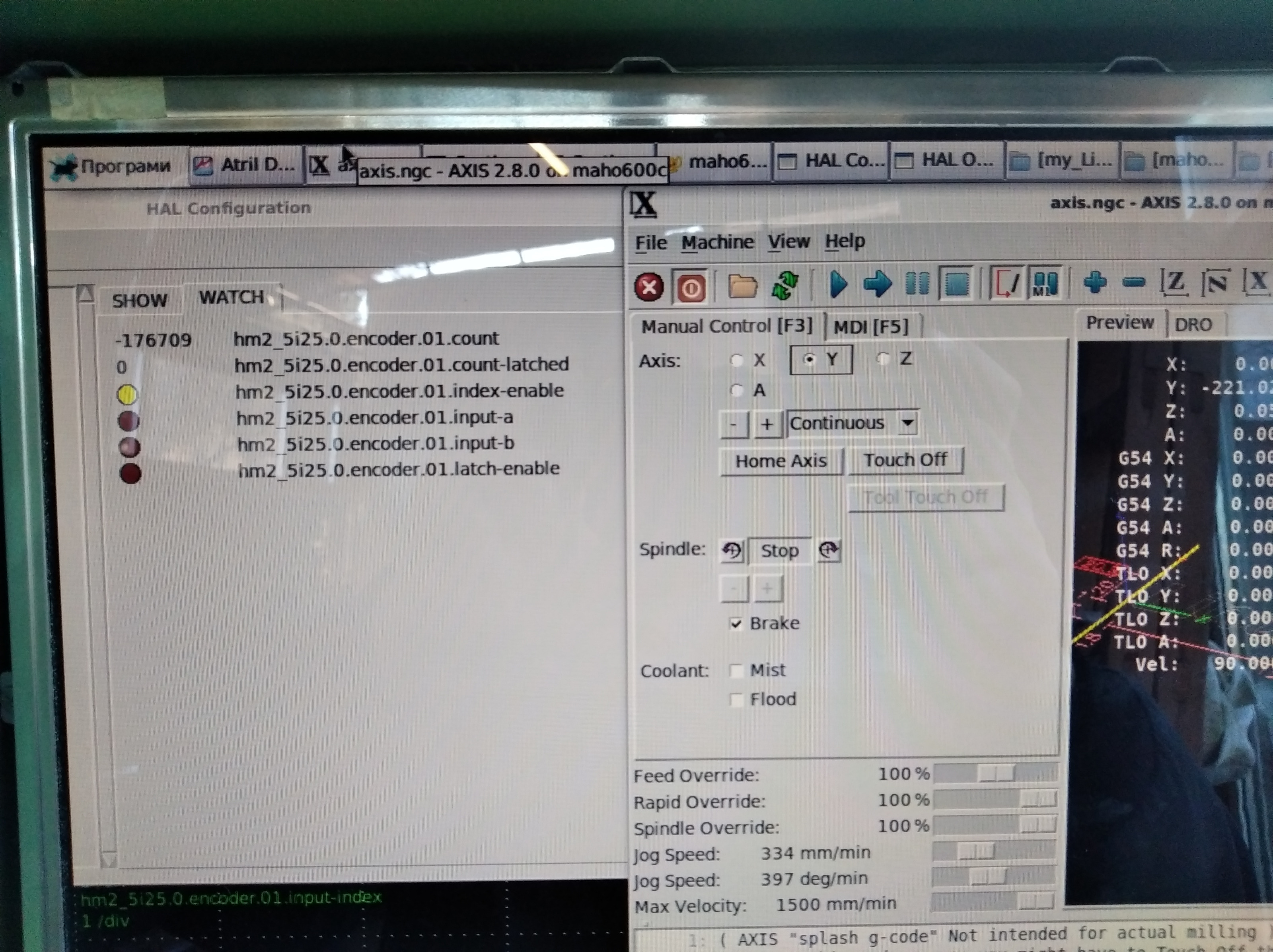

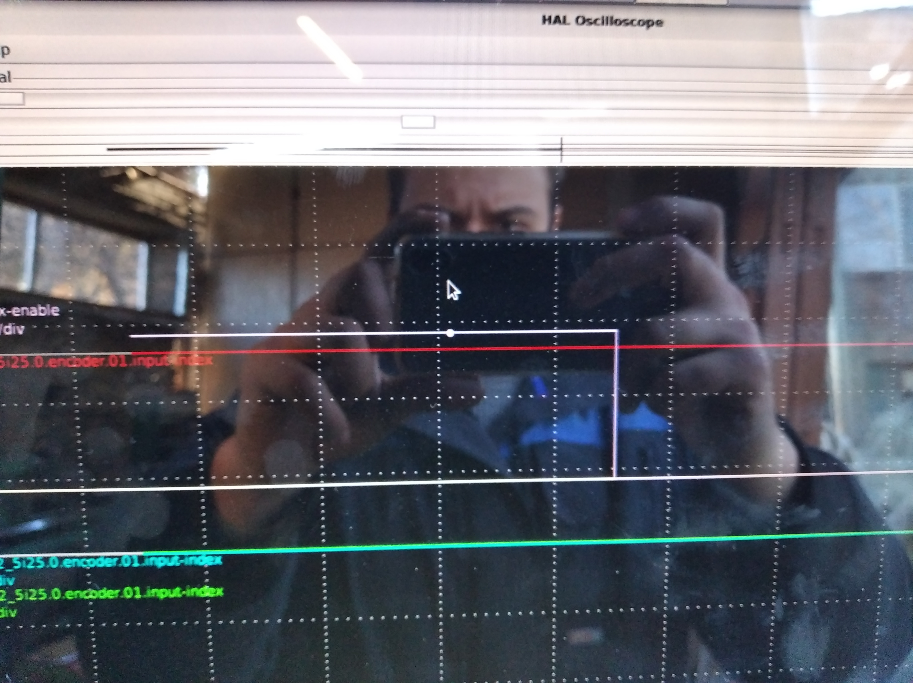

06 Feb 2022 13:59 - 06 Feb 2022 20:30 #234105
by Sando
Hello,again! Well ,i find a solution (almost ) for the home switches. Just net the switches to 24 V (to line 302).
Now they work and X ,Y, and Z axis can be homed. But for better accuracy i want to use option switch+pulse.
The Phillps scales have "measuring period" 0.635 mm between the pulses.
I was trying to make it that way but Linuxcnc cant find (may be?) the first pulse .
How to proceed?
How to proceed?
