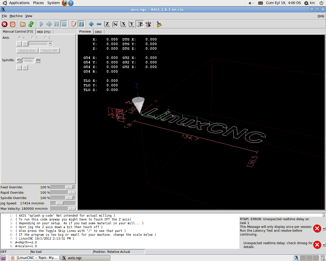

Hi everyone my names Furkan Karaca from turkey. i have a some problem about PIN number.. i want to move Linuxcnc our machine. i use to mach3 but ı dnt want to use it. so transfer linux... my system working with mach3 when i try stepcong linux never run motor.. weird. LPT pin number : LPT pin2 : X axis Step---Pin3 X DIR PİN4 Y step pin5 y dir pin6 z step pin7 z dır. pin 10 xyza home sensor pin 11 xyza limit sensor pin 12 auto tool zero probe pin 13 emergency. i dnt connect emergency snd limit etc. i only want to see motor working. what my problem i use to linux 2.6.3. why doesnt working ? where i wrong my card is working 220v and have a PWN..

You need to run the Latency test, then use those numbers to run Stepconf.
Application,
CNC,
Latency Test
Also post the results of your latency test.

in your screenshot you show error ... this must be fixed before anything else ..
this error will stop motor from running
you need to run latency test and post your answer
