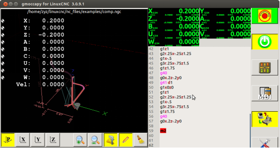

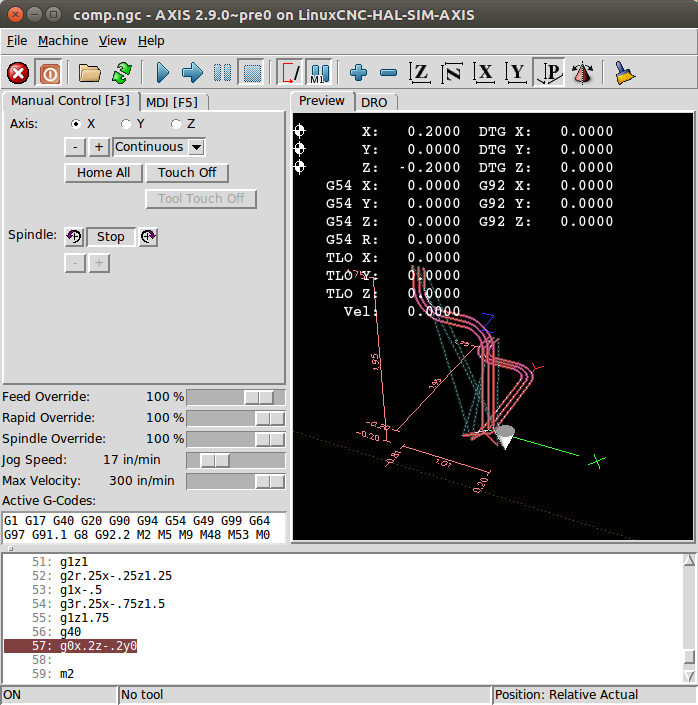

When I run NGC files in different configuration interfaces, I found that in some configuration interfaces, the G code program runs to the previous line of M2 and the cursor stops and remains, while in other configuration interfaces, the G code program runs to the previous line of M2 and the cursor stops and then disappears .
I want to realize the function that the M2 cursor disappears or the cursor stays in the line of M2, where should I look? Hope someone can give me a hint.

@chen I assume with cursor you are meaning the highlighted line in the G-Code?

Yes, what I want to express is G-code highlighting, I use Google Translate, maybe some words are not accurate, sorry.
I would like to know how to go about setting the G-code display line?
There is one more small problem. My custom code (M100-M199) and remapping code cannot be highlighted at runtime, how do I set this up?

I think this belongs to a general problem that G- and M-Codes which don't do any motion are not highlighted at all.
It is also an issue that bothers me.
Hans
