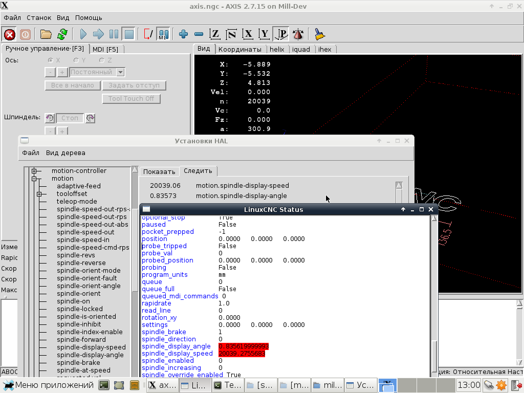

Does it make sense to add this mod to the LinuxCNC build?
21 Nov 2021 23:02 #227243 by andypugh
Replied by andypugh on topic Axis Modifications
I think that if you can format it as a pull-request on Github then there might be interest.
22 Nov 2021 08:58 #227282 by D.L.
Replied by D.L. on topic Axis Modifications
To build, can't use these hal pins(motion.analog-in-00, motion.analog-in-01) for user configuration compatibility.
Need to replace them with something else.
Maybe create a pair of dedicated hal pins(e.g. spindle.display-speed, spindle.display-angle) and add their values in linuxcnc.stat?
In creating a pull-request I do not see any problems.
23 Nov 2021 13:33 #227404 by D.L.
Today I did create these hal pins(motion.spindle-display-speed, motion.spindle-display-angle) and connected them to python interface:
25 Nov 2021 22:01 #227593 by D.L.
26 Nov 2021 15:07 #227658 by D.L.
And 2.8: github.com/ddotldot/linuxcnc/tree/2.8
Any comments, wishes and criticism are welcome.
26 Nov 2021 22:20 #227695 by cmorley
Replied by cmorley on topic Axis Modifications
Have you tested other screens? glcannon is used in other screens.
I personally don't think having spindle stats in EMC Stat is the way to go.
You can read spindle HAL pins directly in python - a much more flexible way.
26 Nov 2021 23:45 #227713 by cakeslob
Replied by cakeslob on topic Axis Modifications
yeah i wasnt sure why that was needed either,I agree, as i just connect mine to spindle.0.speed-out, and other existing motion pins
27 Nov 2021 10:00 #227727 by D.L.
cmorley post=227695 userid=482
Only gmoccapy, mod does not affect it.
How to read encoder position(for display spindle angle) hal pin directly in python, without python interface?
Need example.
cakeslob post=227713 userid=25269
It is necessary to transfer speed and angle values to the python interface.
Signal source will select the user in the hal file(e.g. spindle.N.speed-out-abs => motion.spindle-display-speed or from spindle encoder).
I think this(dedicated hal pins) is a more flexible solution.
About another way i know: use speed(commanded, not real) from spindle dictionary and spindle num(select spindle to display speed) from ini file.
27 Nov 2021 16:55 #227756 by cakeslob
Yeah, im using commanded speed as well
#####  Add spindle speed lable to axis                              ##########################################
#####  Figure out where you want to place it, we will place it in the manual tab for now.      ########################
# saves typing
W = root_window.tk.call
# this creates the spindle speed lable in the manual tab, with text SPEED
W('label','.pane.top.tabs.fmanual.spindlef.spindle-speed','-text','SPEED')
# this is where we put it
W('grid','.pane.top.tabs.fmanual.spindlef.spindle-speed','-column','0','-row','3','-sticky','w')
# we want it to update the speed more than once
def user_live_update():
  W('.pane.top.tabs.fmanual.spindlef.spindle-speed','configure','-text','SPEED %3.0f' % (comp['spindle-speed']))
# this makes it an offical axis hal pin and links it to spindle-vel-cmd-rpm
def user_hal_pins():
    # create new hal pins
    #mycomp = hal.component('feed')
    comp.newpin('spindle-speed', hal.HAL_FLOAT, hal.HAL_IN)
    hal.connect('axisui.spindle-speed','spindle-vel-cmd-rpm')
