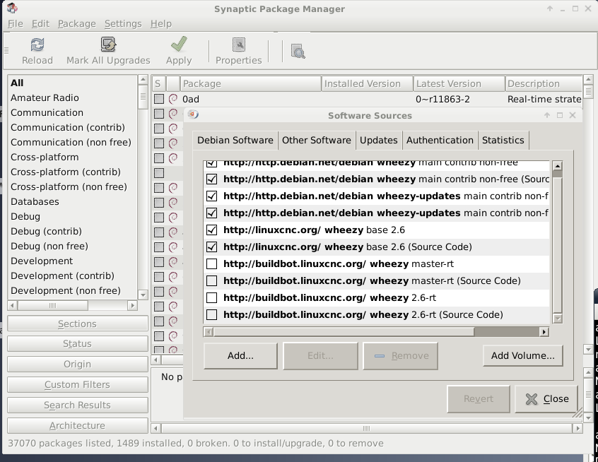

03 May 2018 17:40 - 03 May 2018 17:41 #110132
That should be fine.
buildbot.linuxcnc.org
Your kernel seems to indicate Wheezy and RTAI, so you would use:
deb buildbot.linuxcnc.org/ wheezy master-rt
deb-src buildbot.linuxcnc.org/ wheezy master-rt
You can do this in the GUI if you want.
System->Synaptic Package Manager
Settings->Repositories
Then click the "Add" button.
This is what mine looks like (as you can see I have set it to an old 2.6 version for testing, but Master is there as an option)
Replied by andypugh on topic Added A axis to XYZ mill, what can be done in AXIS?
OK,
I will try to setup a Master environment and see what happens.
Maybe I am currently running a too old release?
Linux debianRT 3.4-9-rtai-686-pae #1 SMP PREEMPT Debian 3.4.55-4linuxcnc i686 GNU/Linux
AXIS 2.7.12

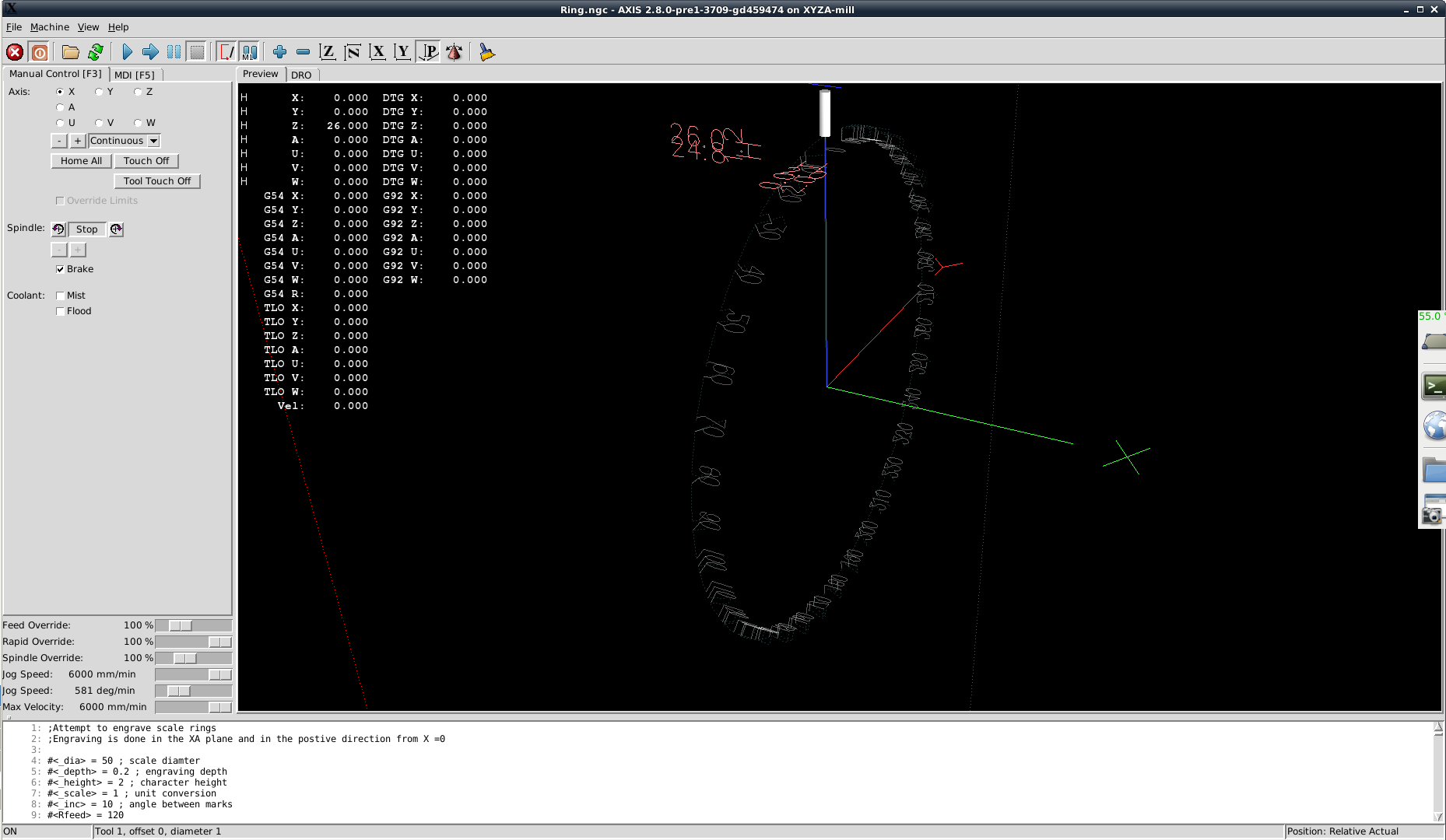

03 May 2018 19:47 #110141
by Wirewrap
Replied by Wirewrap on topic Added A axis to XYZ mill, what can be done in AXIS?
Installed master branch on a test machine that is identical to my shop machine but missing stepper motors and the cast irom of the actual mill.
At first Axis start I got an offer to convert my old setup to this new version. I accepted the offer.
This is the screen after start and load of the test program "ring"

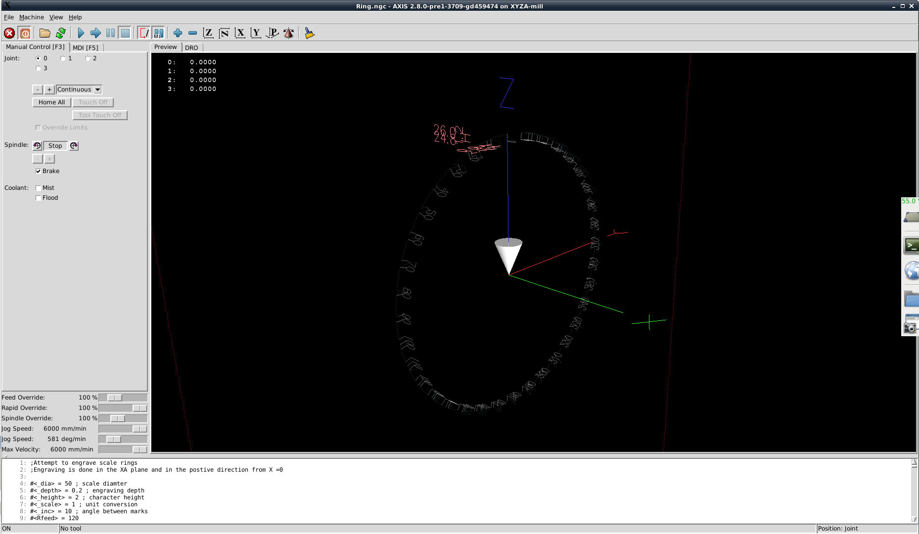

Screen after "home all", This is different from 2.7.12 in that axises are shown in manual mode

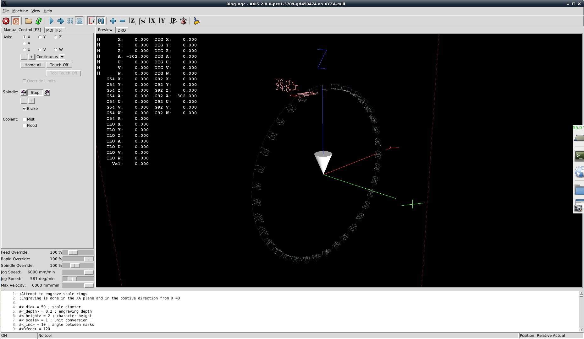

Here I tried to move the tool tip to the perimeter of the workpiece and touch off Z to 0. Seems to be a bad idea.
Funny that the diameter of the work piece changes.

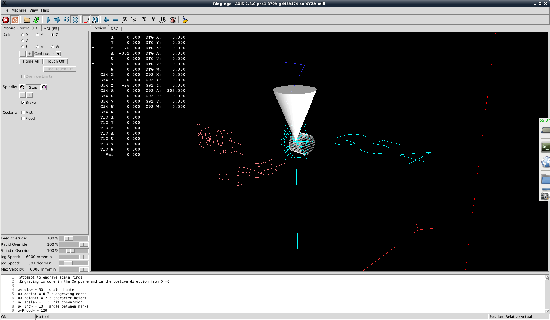

Then I tried to move the tool to the perimeter and touch off W. Now this seems promising. I will try it on the real machine and see how it works. Trying to test touch off without a real machine is very confusing to me.

09 May 2018 12:21 #110429
You can turn off the offset display in the "View" menu.
Axis doesn't actually know where the centre of rotation is, so the preview just assumes that it is at X=0, Y=0, Z=0.
We have discussed ways that the preview could "know" where the rotation axis was, but nothing came of it.
