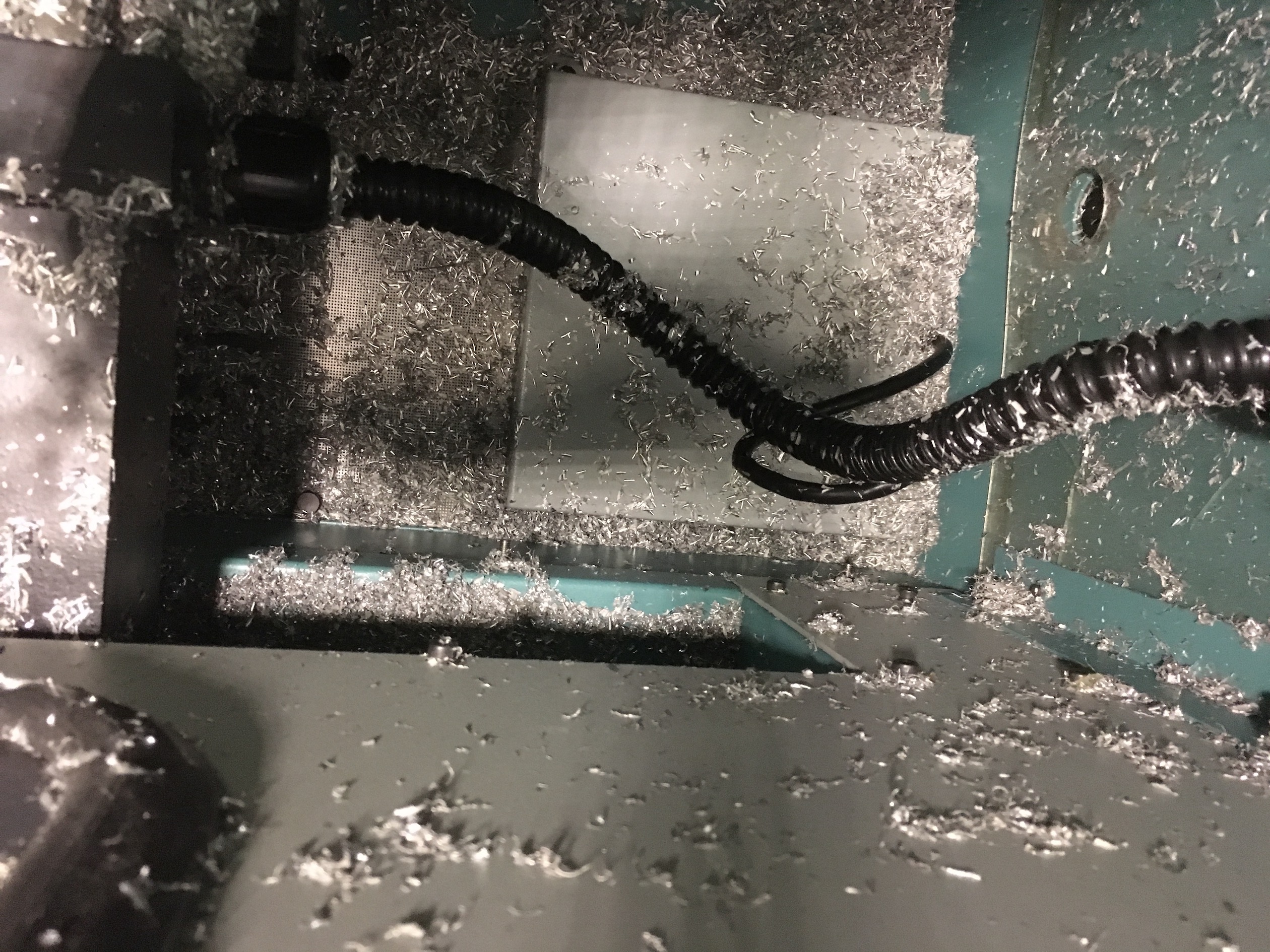

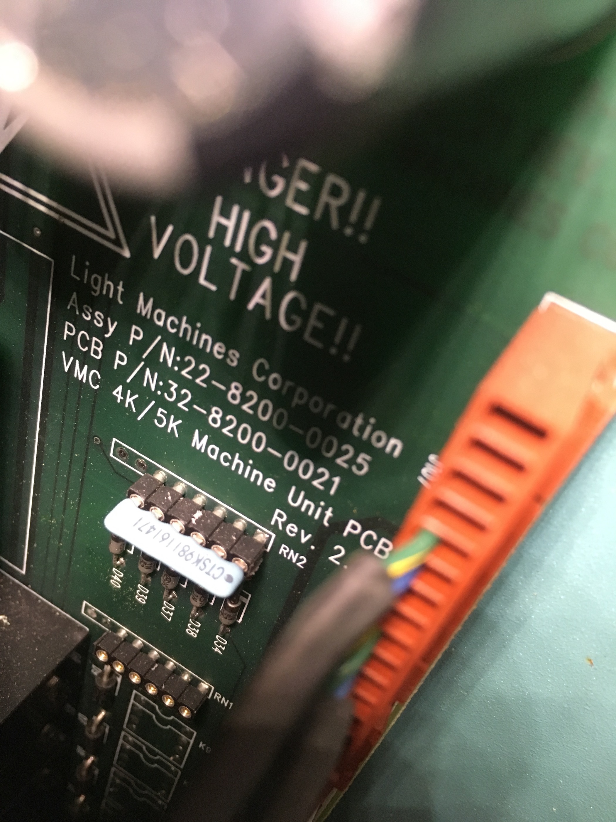

Replied by SOSMachining on topic Light Machine Corp. Benchman XTr (retrofit)
Hey Guys,
Newbie here but I love this forum. A few years ago I stumbled across a craigslist auction for two of these machines and have been tinkering with them ever since. After a couple of new parts to the old PC and some practice learning g-code on Youtube, I've been able to sling pretty steady aluminum chips from one of the machines so it's been a pretty cool project. I've attached a couple pictures of the machines with some upgraded aquarium lights below.
The one issue that I have is that it seems like my tool holders are struggling to repeatably get all the way up inside the drawbar. I've tried to do some aligning and re-homing of the ATC following the instructions in the manual but I still see anywhere between 0.004" and 0.020" variation between tool changes. I'll probably need to do some heavier dis-assembly and re-assembly of the ATC one of these weeks but I haven't made it there yet. Recently I've become pretty curious about the possibility of adding a tool-length offset probe inside the machine to verify the offset after a tool change but I'm not sure if my machine has the right main board to support a probe.
I've attached a couple picture that show the setup inside my control panel because it looks quite a bit different than the other posts in this forum. It looks like my main board on this machine is very similar to that of the ProLight machines and I have ASI motion controller card inside the PC rather than and PCI cards.
In looking I definitely don't have the wiring for the probe connector on the back of the front panel inside the machine like the probe-offset manual says I should. I can attach more pictures if necessary, but I guess my question is, does anyone know if this machine is capable of using a tool-length-offset probe, and if so, which pins input the signal from the probe?
Thanks, guys! This forum has been a huge help in getting my machines up and running!

- SOSMachining
- Posts: 7
05 Oct 2019 02:06 - 05 Oct 2019 02:08 #147153
by SOSMachining
Awesome! Thank you for the response. It looks like the J530 pin is right on the front of the main board but it's got 7 pins. Do you have any pinout schematics on what each of those 7 pins does? Also do you happen to remember the style of connector used on the board? I'd like to try wiring up a test to see if the pins are functional.
In digging through the Intellitek website it looks like the Benchman software is on there and available for download but I'm unable to install it in a way that allows it to communicate through the ASI slot. I'm thinking that I may try installing Windows NT on an extra hard drive and trying to boot my computer with Windows NT to install the software. My thinking is that maybe if I'm able to use a fresh download of the NT software that I can enable the probe functionality to test the pins since my Windows 98 doesn't seem to want to let the fresh install talk through the ASI slot.
I've attached a photo of the perforated material in the bottom of my machine above where the coolant pump is. It looks like the coolant pump is wired into J107 on the main board but I think if I had the opportunity to rewire I think I'd wire it separately from the machine controls because my machine sometimes faults out mid-cycle because of coolant pump issues. I haven't been able to track down exactly whats causing the issue so it's kind of a hassle some days. I've also attached a picture of a 2" face mill doing some passes in aluminum with the coolant on. I can see why the "waterproofness" of the panel was a concern as the coolant flies everywhere when she's on!
Thanks guys!
Thanks guys!

- x-Intelitek Engineer
- Posts: 113
- Thank you received: 22
07 Oct 2019 17:27 #147353
by x-Intelitek Engineer
Replied by x-Intelitek Engineer on topic Light Machine Corp. Benchman XTr (retrofit)
SOS:
Connector is Molex: 22-01-2077
Contact is Molex: 08-55-0105
Both available thru Digikey.
The circuitry for the probe on your machine is attached.
Try running the pump direct to the wall instead of through the machine.and see if the machine faults go away.
Let me know if you need further documentation or information.
