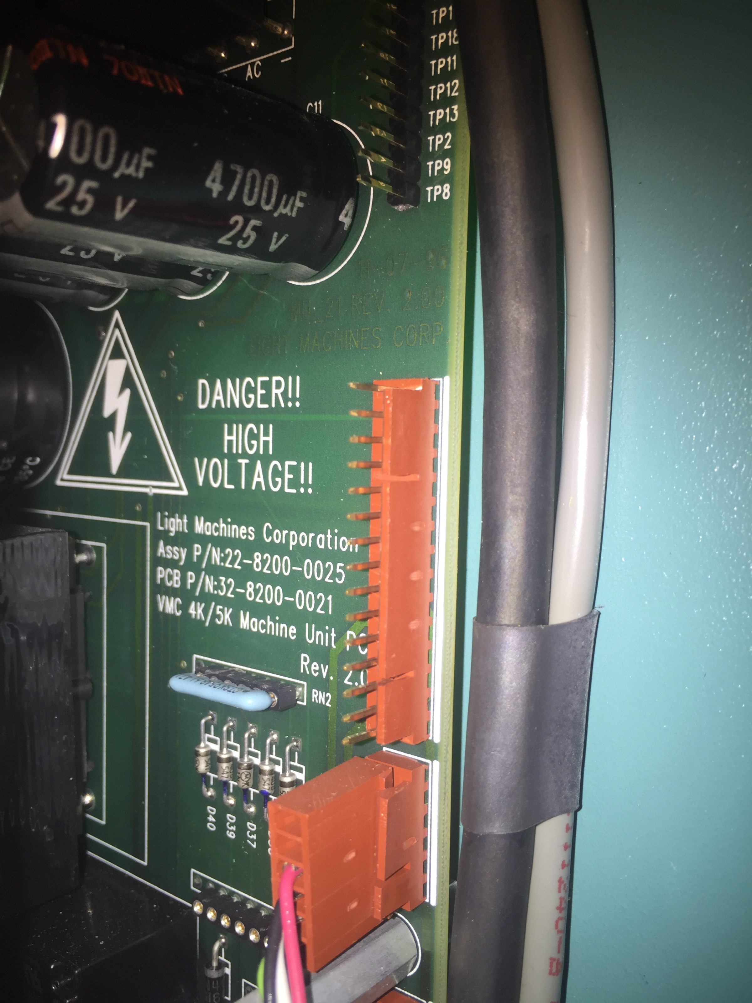

It has been a long time since I worked on a 4000. If you can give me the PCB numbers in the system, I may be able to help.

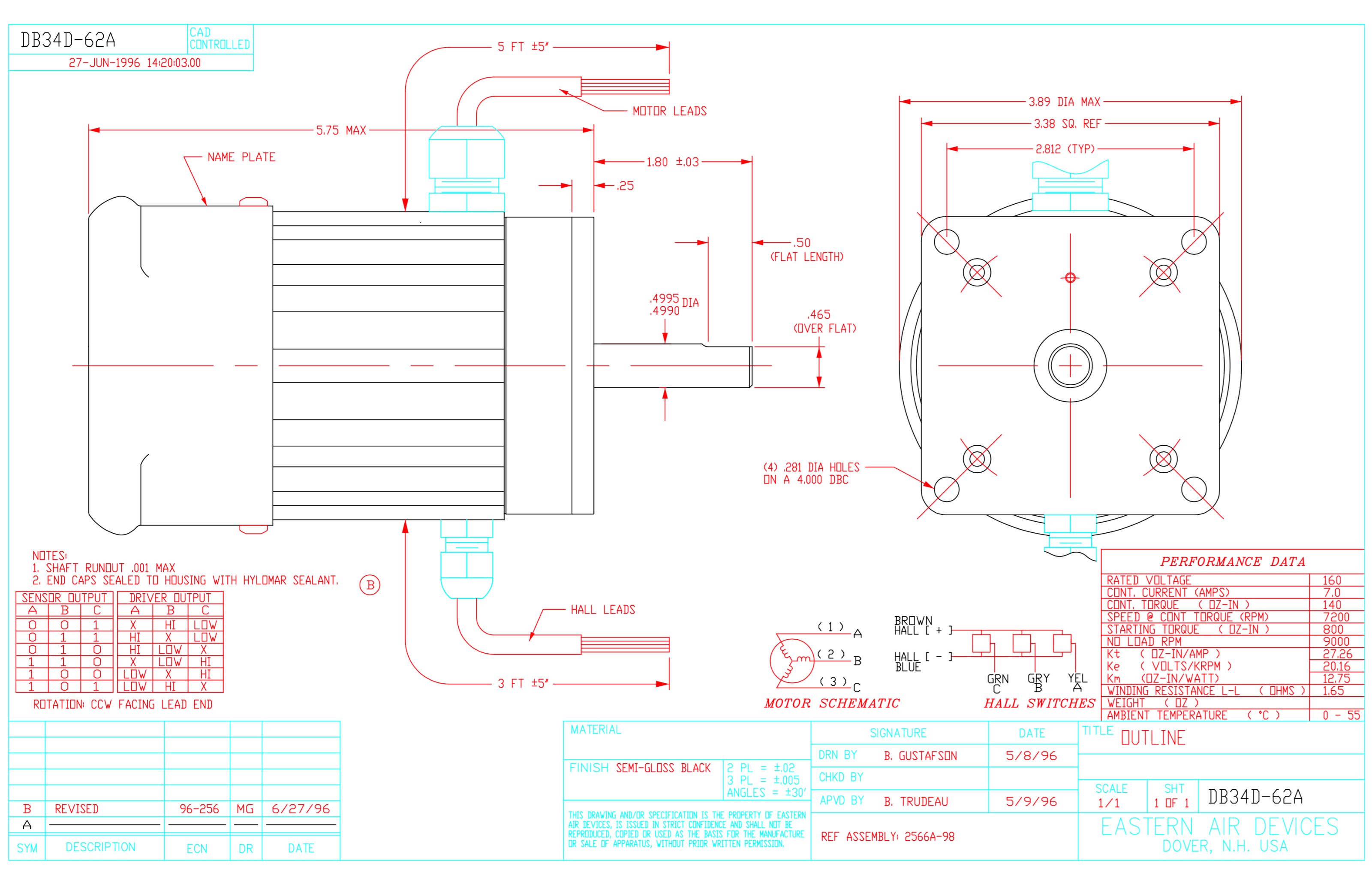

28 Jul 2019 18:11 #140828
Replied by andypugh on topic Light Machine Corp. Benchman XTr (retrofit)
If the hall sensors are in the wrong order then the motor will simply not run, or will run backwards.
You can just run through all 6 possible combinations to see which one works. The drawing shows which colour is which, and I would be surprised if they were not just ABC or CBA on the connector.

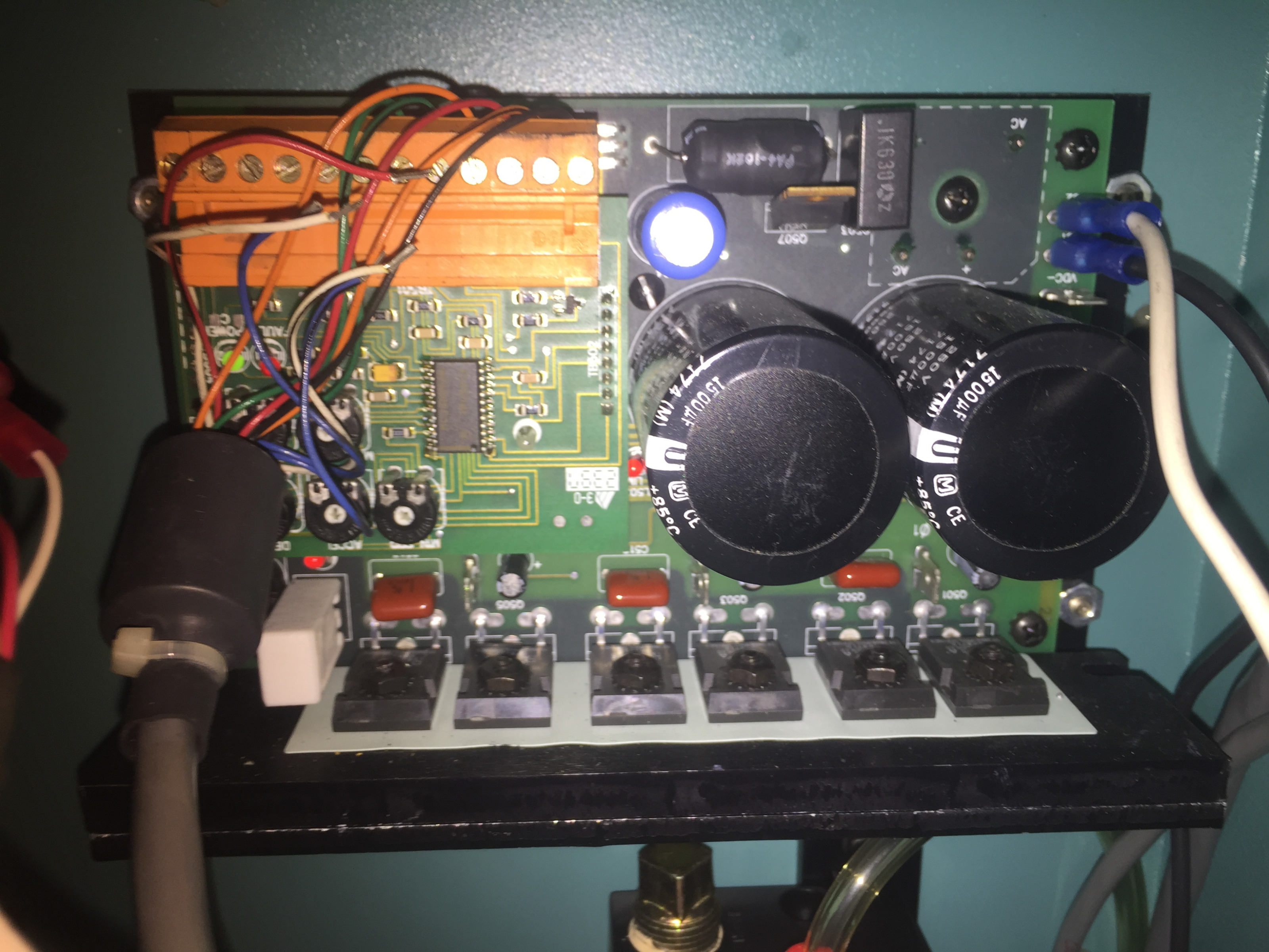

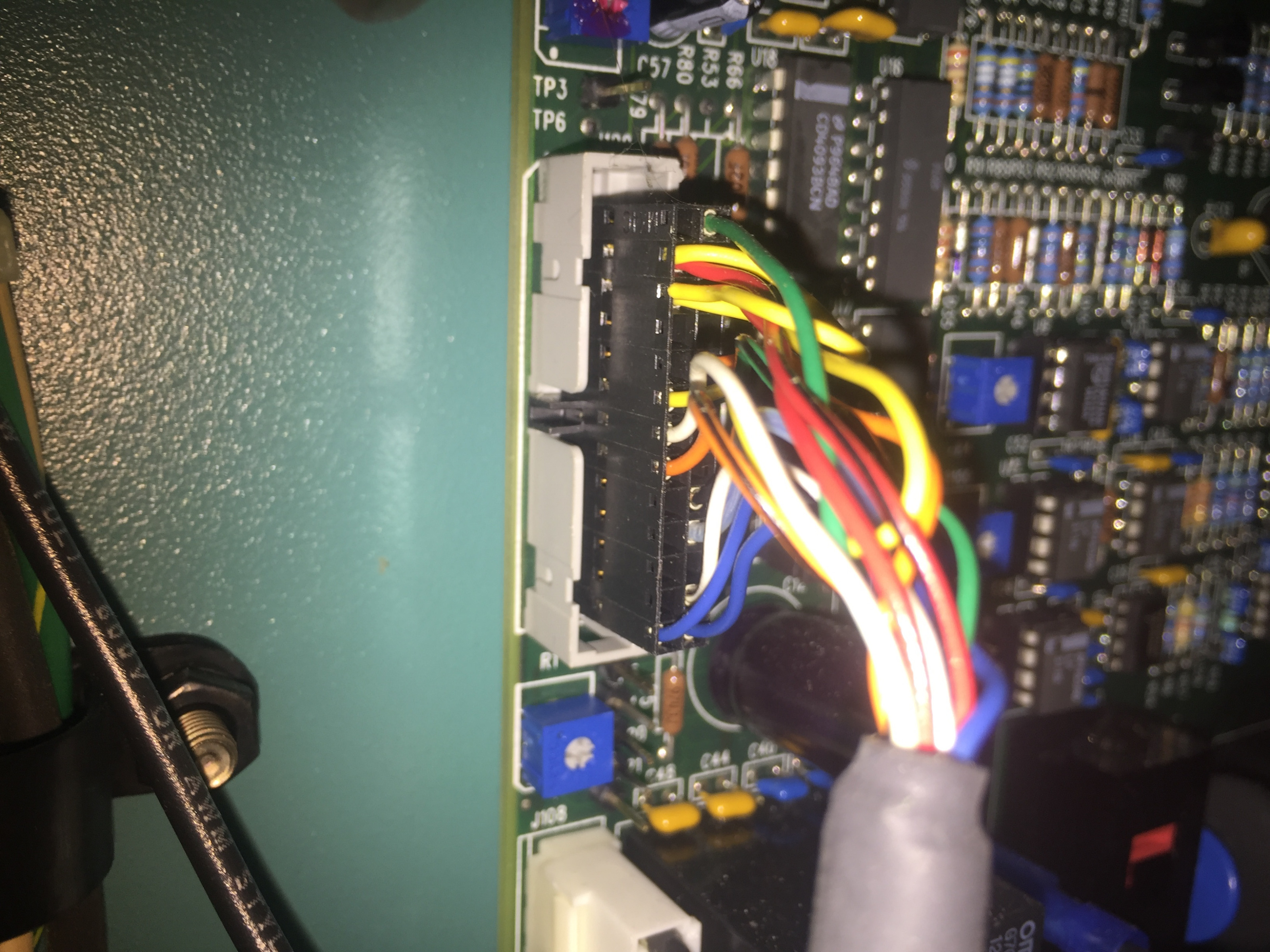

29 Jul 2019 02:13 #140859
by project-pegasus
Replied by project-pegasus on topic Light Machine Corp. Benchman XTr (retrofit)
Thanks for that advice, Andy. Here's the trouble I'm running into. It looks like there were several slots on the spindle drive board that had multiple wires inserted. Like a wire from the spindle's Hall leads paired with a wire from the main control board. You can see the loose wires from the main board in picture of the spindle driver board posted above. Those aren't the Hall leads. And then there's the two wires from the spindle that each terminate in a two-pin header connector (also pictured above). Not sure what those are. I really need someone with one of these machines to help me out. Thanks.

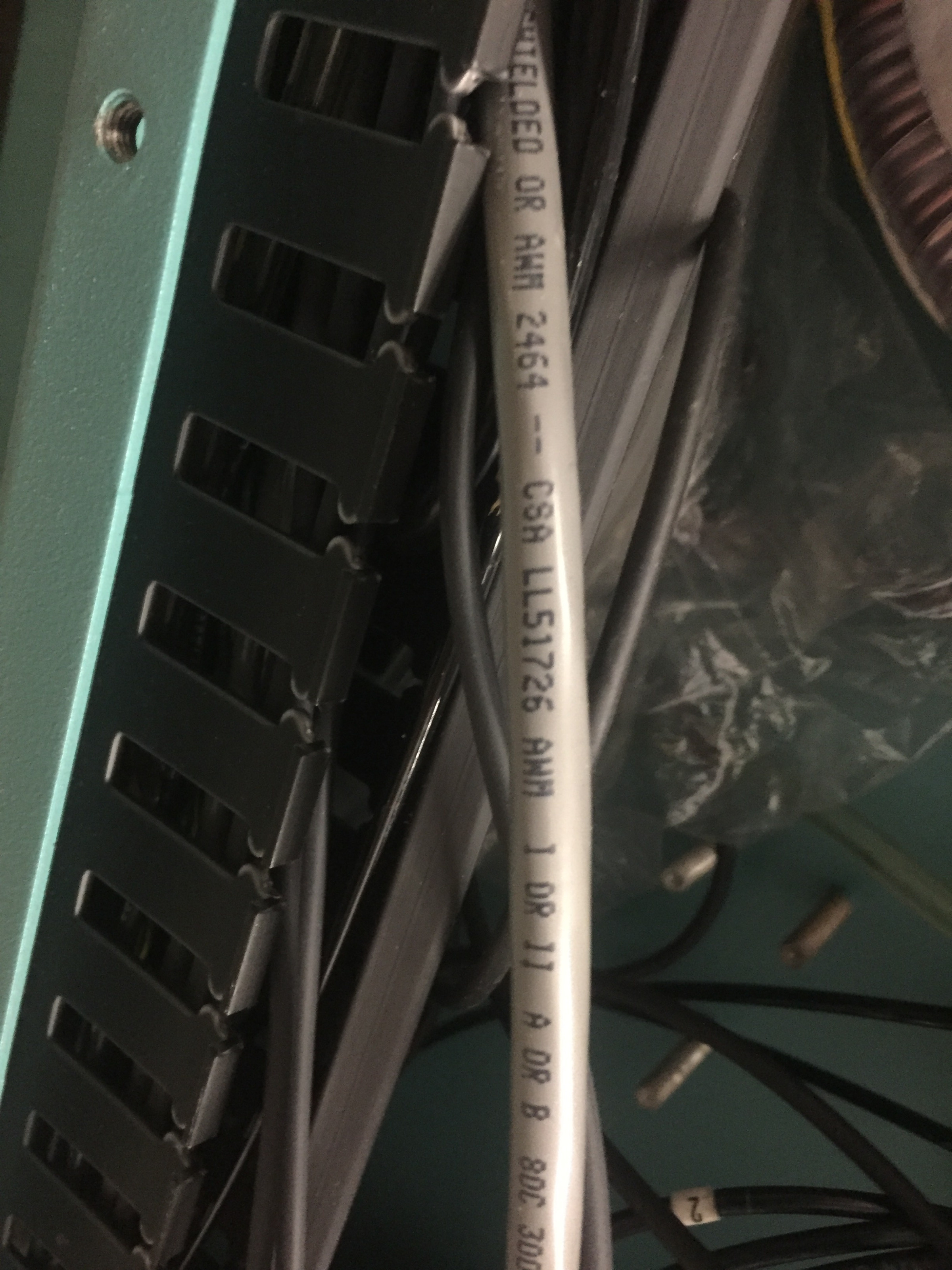

29 Jul 2019 13:15 #140884
by x-Intelitek Engineer
Replied by x-Intelitek Engineer on topic Light Machine Corp. Benchman XTr (retrofit)
Do you have the part number of the cable on the left side of the first photo? There should be a label with the part number attached. I have some connection diagrams and can check based on the P/N.

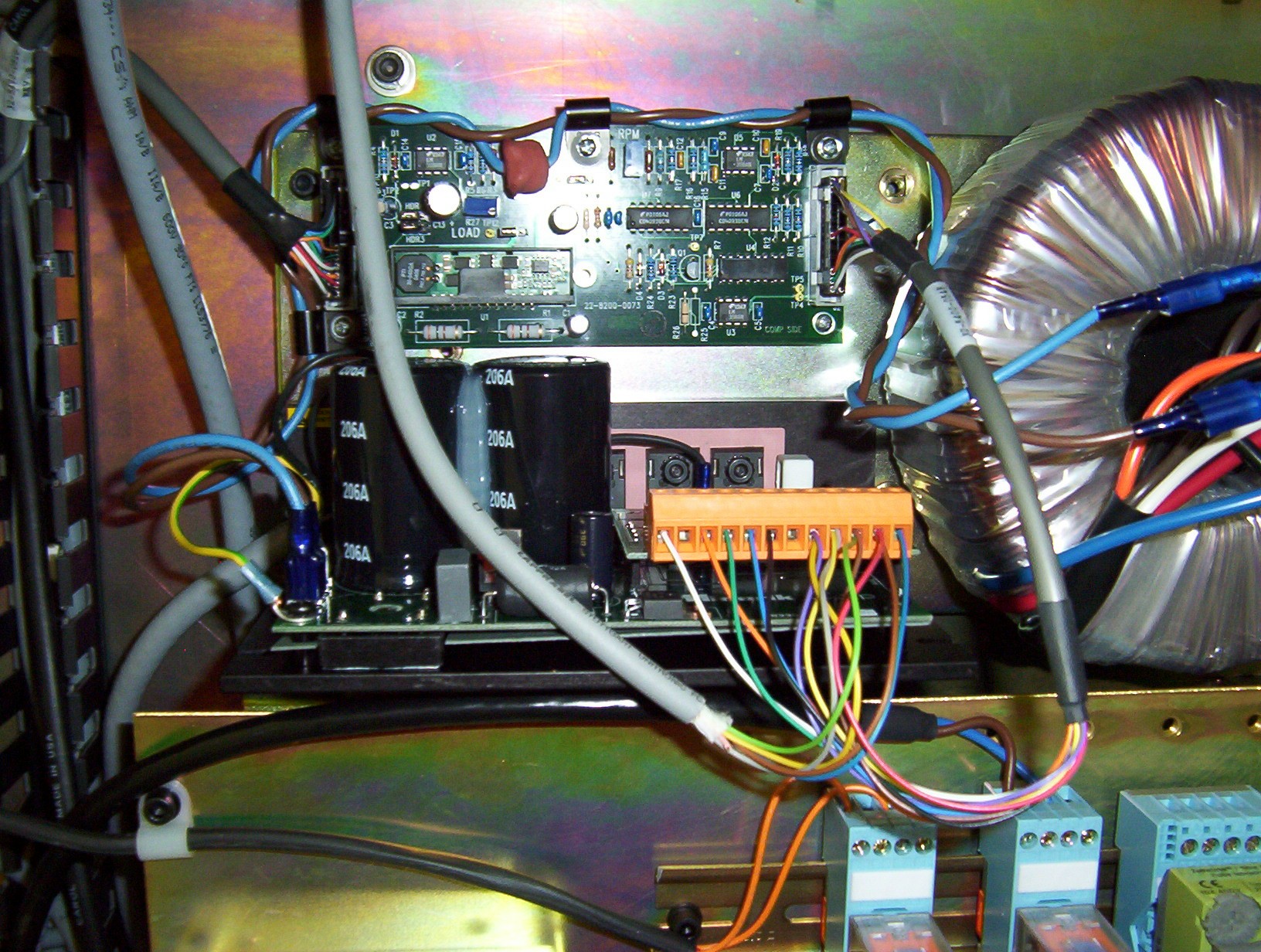

29 Jul 2019 20:07 #140916
I have attached a photo of another (differrent) installation of that speed control.
(This is not wired exactly like your machine, so DO NOT COPY)
You can see that there are several locations with 2 wires in them.
I have also attached an explanation of the connections.
This should explain the connections from the motor to the speed control as well as the connections (Halls) that go to both the speed control and the control PCBs.
Once you give me the cable #, I should be able to give you more information.

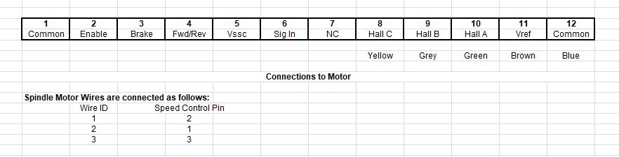

30 Jul 2019 14:07 #140951
Pegasus,
The attached file shows how to connect the motor to the speed control.
Pin 1 is the inboard-most location. It is the WHT wire in my previous photo.
The motor connects to pins 8-10 of the big orange connector and to the 3 male spade connections on the speed control.
The hall cells connect to the connector you show on pins: 24, 25, & 26. They are used strictly for determining spindle speed; whether it is turning or not and if it is at speed.
I am also attaching a copy of the schematic for your main control board (with the cuts and jumpers identified).
I drew this back in 1999 to develop a universal control board for next generation machine (Benchman XT).
I believe it is accurate, but please use it as a guide and not as 100% guaranteed fact.
Please let me know what else is needed.
