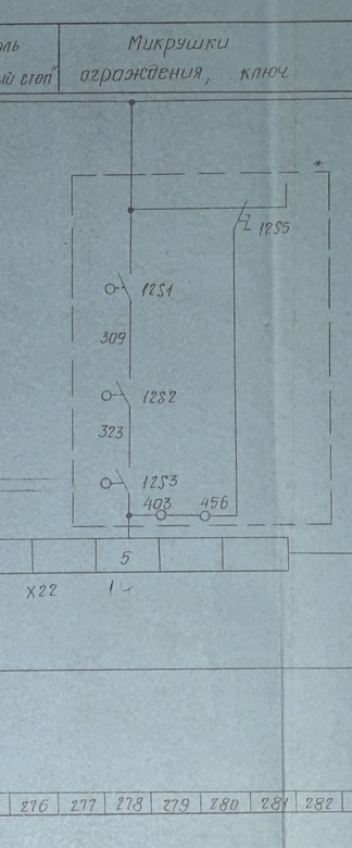

So I think what you suggest is correct, ie. this must have to do something with the inputs. The problem is that this part of the wiring differs from the schematics. For example at the column 278 here there are some switches that are described as "microswitches of the enclosure, lock":
so my first thought was: OK, maybe it's something as dumb as some kind of switch that checks if the enclosure is opened, but then I couldn't find any switch like that and it turned out that the points listed there (403, 456) are not connected to the input. Which looks like maybe on some machines there were switches like that, but not on that particular machines. I will still maybe go over some of the points that are in fact connected to the inputs over the weekend, but I agree with you - if it's not something I can catch quickly, it won't be worth it to debug the thing. Especially that I can probably sell the controller and the display/keyboard assembly for a decent price. One drawback of getting rid of the entire controller will be that I will have to give up the EXE components as they are integrated inside the controller, but there's lots of standalone EXE modules on Ebay and most of them are in 60-80EUR range, so that's not a big problem. And then the placement of the controller would work great for a motherboard with LinuxCNC, so again, I would prefer to get rid of it.
I would think that is why that part of the schematics is in a dashed box marked with an asterisk (*) in the top right corner. (ie. this part is optional)

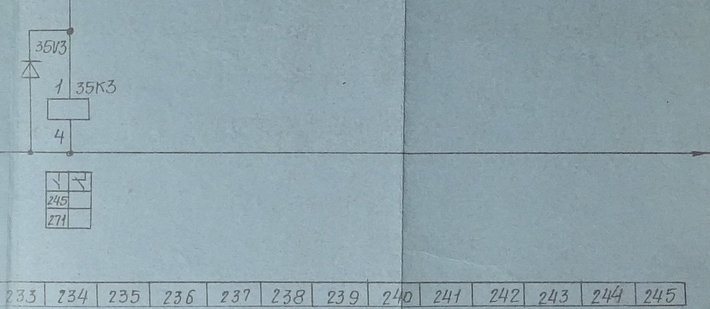

Not sure about 'M' and 'T' either, maybe gear-change and tool-change?
Just had a look, according to the schematic there is another contact of 35K3 but it clearly not at column 245 as indicated:

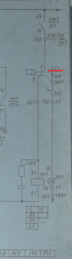

I think I'm getting somewhere. This whole time I was so focused on chasing the farther and farther contactors that I missed a mistake I made at the very beginning. At some point I mentioned the button that bypasses some of the contactors in order to start the hydraulic units (lubrication and power hydraulic). Back then I haven't thought about it that much, but now that I was going through the whole thing again I realized that I have never heard the hydraulic power unit to turn on *unless* I pressed the 3K1 contactor. So I looked at the schematics again and there's a 3F1 (fuse?) thing before the 3K1 contactor in the column 170:
So I checked the nodes 166 and 167 and sure enough there was 110V between 166 and the ground and no voltage on 167.

28 Jan 2022 11:32 - 24 Feb 2022 15:27 #233366 by drogus
I found such a device on an auction and it's apparently a pressure switch, which would make sense when looking at the schematics - whenever it reaches the desired pressure it will turn off the pump. And according to the schematics it's normally closed. The question is, why it's acting like it's open? Might still be some kind of level of oil measure connected with the switch, so I guess I'll buy some hydraulic oil (which I would have to do anyway I guess).
update:
There is something definitely going on in there. I unscrewed the top of the device to uncover contacts and there is a connection between the contacts when the machine is off. But then as soon as the voltage comes in the connection is closed. I thought that maybe the pump is getting up to the pressure too fast to notice, but that would be weird. Just in case I asked another person to hold the "hydraulics on" button while I was looking at the pump and it didn't move at all, so yeah, it seems that something is off about the pressure switch. I will buy the oil to top it up just in case, but if that won't help I'll maybe buy a replacement switch.

28 Jan 2022 12:55 - 28 Jan 2022 13:01 #233369 by Aciera
Yes according to the manual.
Page 105:
" The motor of the hydraulic system 3M1 is turned on if the pressure switch 3F1 switches on. Meaning, if the contact 3F1 (166-167) is closed and the starter 3K1 is turned on."
The fact that the contact is open could be to a malfunction of the mechanics of the switch or a bad electrical connection to the cabinet.
I would take off the connector cap and check the contact right at the switch with an ohm meter.
