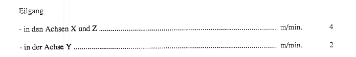

21 May 2023 16:29 - 21 May 2023 16:57 #271847 by petmakris
Another thing that confuses me is that, as is, it moves with a 2000mm/min velocity at 10V.  How can the product manual say the machine had 4meter/minute rapids?
It has 4meters in X,Y  and 2meters in Z (maho Y is normal Z)
I just measured that moving at 500mm/min takes 1.15V for X and Y while the on Z takes 2.3V
