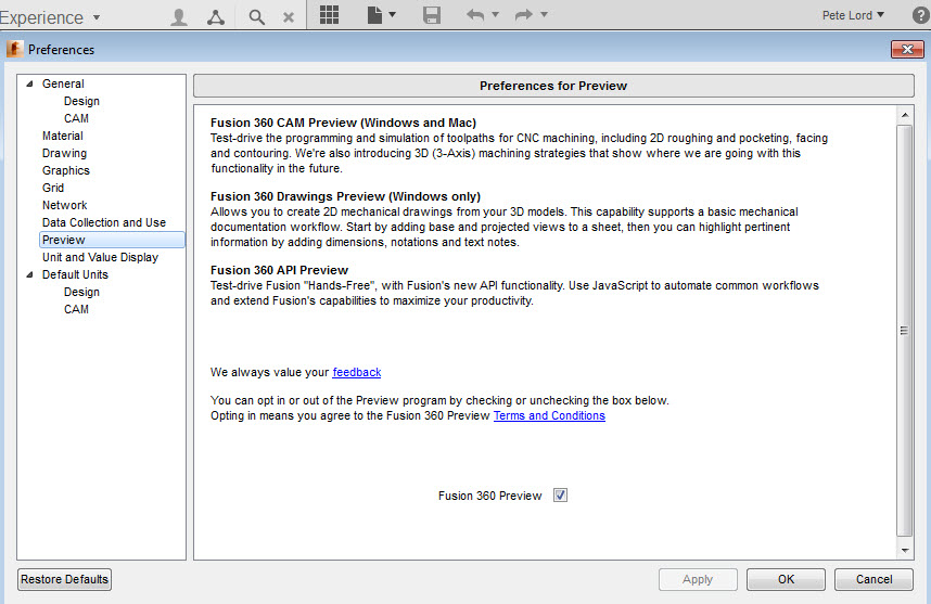

CAM Capability is available for Mac Users of Fusion360 as a Technology Preview.
To get access, select Preferences from the Pulldown associated with your name in the right hand corner of the Fusion screen.
Among the choices you will see Preview (for me it is 3rd from bottom). Select the Fusion360 Preview option, and the CAM capability will be displayed for you.
I've attached an image of the preferences dialog right under the name pulldown that you would use to access it.
Let me know if you need any more help with the CAM capability.
