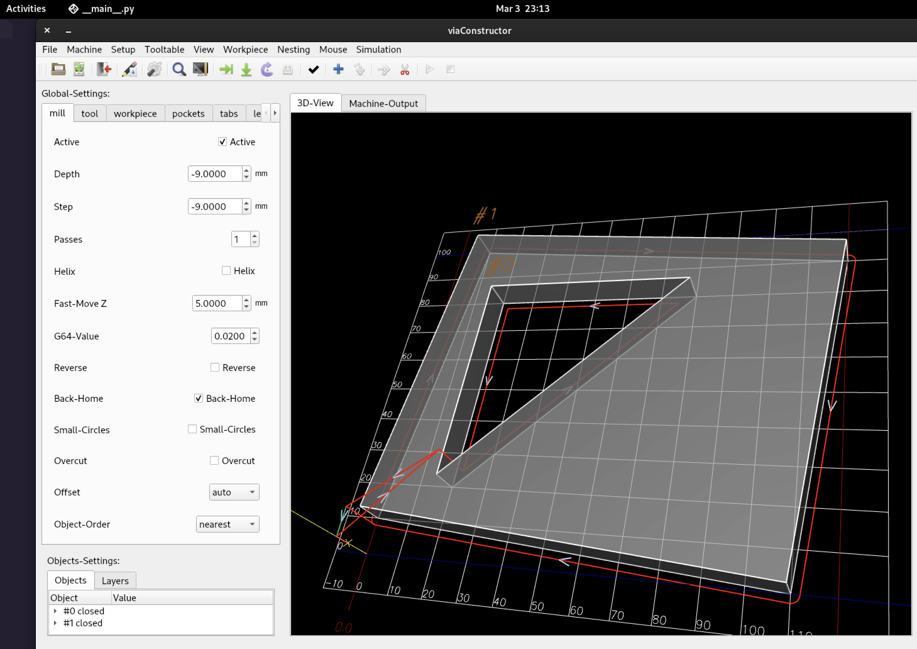

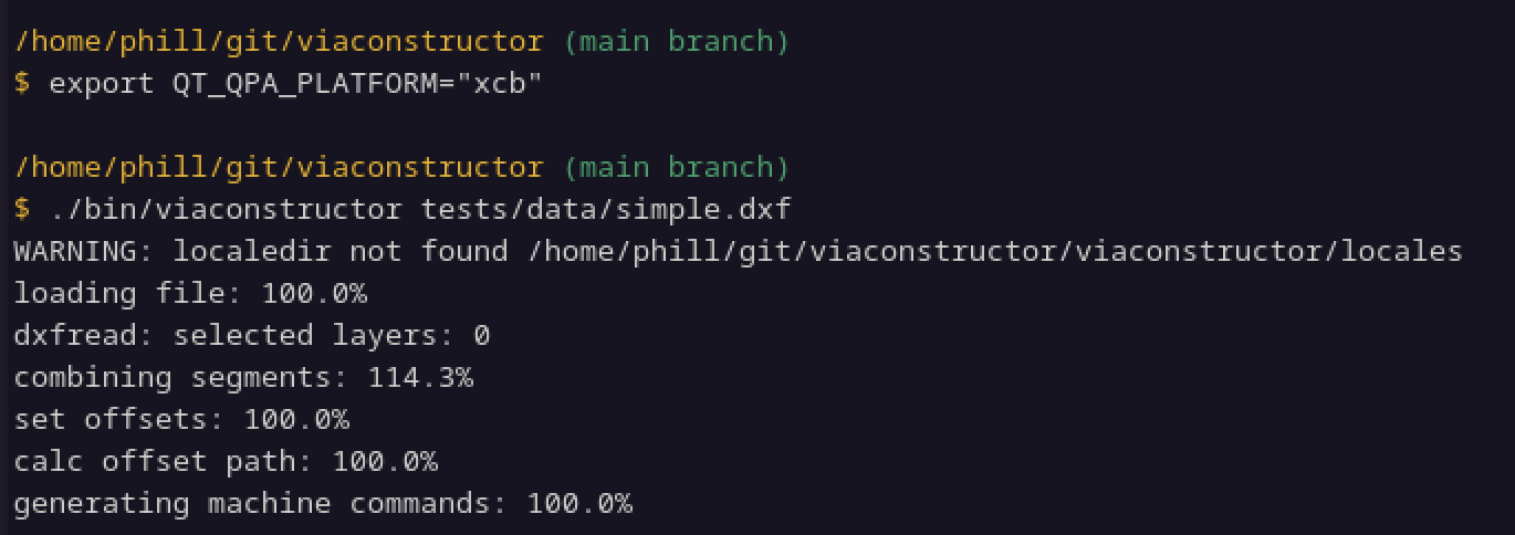

I just tried on Debian Bookworm running Wayland.
Without an export the 3d view is transparent.
I opened a teminal as a normal user and entered the following two commands and it runs successfully:
export QT_QPA_PLATFORM="xcb"
./bin/viaconstructor tests/data/simple.dxf
Warning: Spoiler!
Warning: Spoiler!

04 Mar 2023 23:13 #265873 by phillc54
I installed directly from git as I was unable to successfully install via pip on any of my machines.:
git clone https://github.com/multigcs/viaconstructor.git
cd viaconstructor
pip3 install -r requirements.txt

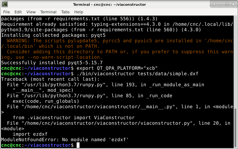

05 Mar 2023 20:32 #265939 by Dragonick
I receive this message:
Installing collected packages: pyqt5
  WARNING: The scripts pylupdate5, pyrcc5 and pyuic5 are installed in '/home/cnc/.local/bin' which is not on PATH.
  Consider adding this directory to PATH or, if you prefer to suppress this warning, use --no-warn-script-location.
Successfully installed pyqt5-5.15.7
cnc@cnc:~/viaconstructor$ export QT_QPA_PLATFORM="xcb"
cnc@cnc:~/viaconstructor$ ./bin/viaconstructor tests/data/simple.dxf
  File "/usr/lib/python3.7/runpy.py", line 193, in _run_module_as_main
    "__main__", mod_spec)
  File "/usr/lib/python3.7/runpy.py", line 85, in _run_code
    exec(code, run_globals)
  File "/home/cnc/viaconstructor/viaconstructor/__main__.py", line 1, in <module>
    from .viaconstructor import ViaConstructor
  File "/home/cnc/viaconstructor/viaconstructor/viaconstructor.py", line 20, in <module>
    import ezdxf
ModuleNotFoundError: No module named 'ezdxf'
how to fix it ?

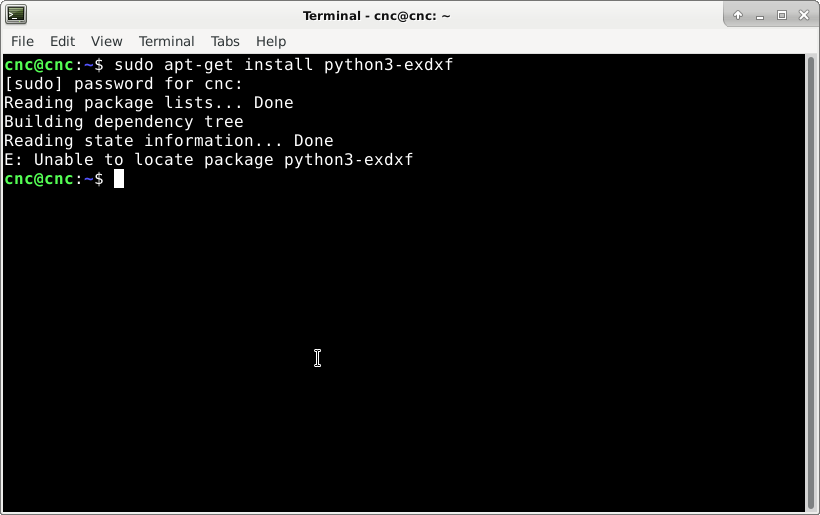

06 Mar 2023 21:06 #265978 by Grotius
ezdxf is a python lib. Maybe install it, my suggestion without checking it : $ sudo apt-get install python3-exdxf
07 Mar 2023 12:06 #266021 by Dragonick
receives this message:
E: Unable to locate package python3-exdxf
and I messed up everything. because now viaconstructor does not open for me at all
07 Mar 2023 23:44 #266084 by Grotius
O my god. Welcome to Linux.
snapshot.debian.org/package/ezdxf/0.14.2-3/
Then it would be : # sudo apt-get install python3-ezdxf (you did'nt see my typo?)
packages.debian.org/bullseye/qtcreator
Then it would be : # sudo apt-get install qtcreator
has libqt5core5a (>= 5.15.1)
Hope this helps.

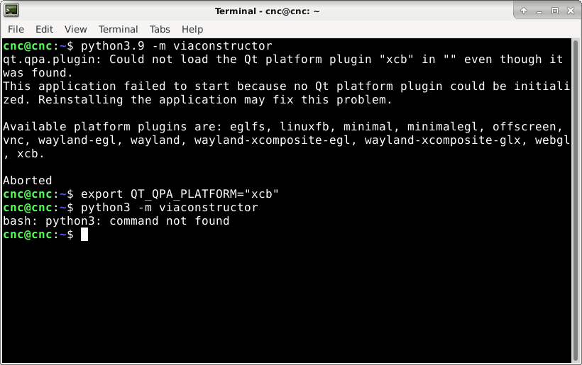

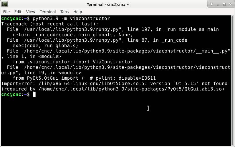

09 Mar 2023 18:41 #266226 by Dragonick
It still didn't work. Now I have this error
