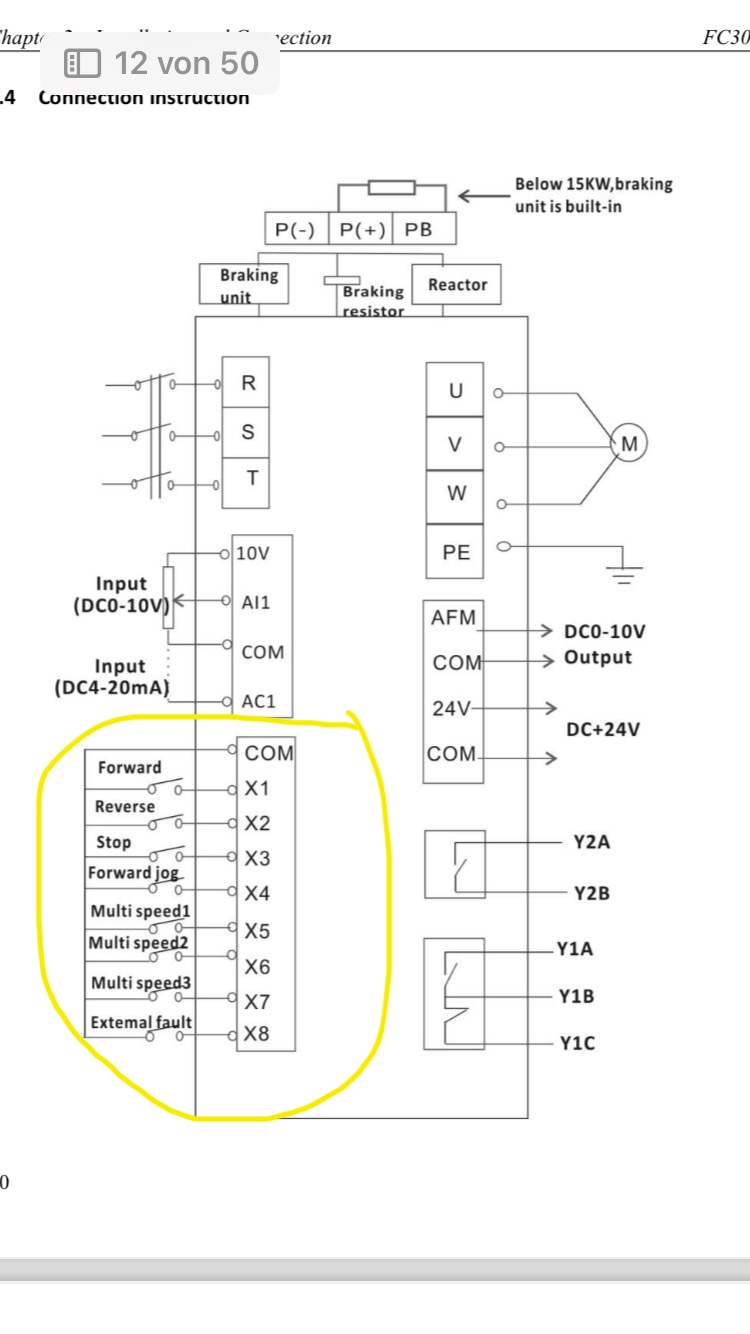

One interval function is nice to have. Reduced the coolant drag out.
I don't think so. VFD is an intelligent device. Usually you have three single inputs and could select motor speed over there and have a current control.
Replied by chris@cnc on topic writing chip conveyor component , user input wanted
are there any features I am missing ?
Adding a VFD "can" not change anything, set the speed manually and use it just as run fwd/rev, so the component sees it as two relays.

All VFD i have worked with can be set to be controlled just by fwd/rev pins, at whatever speed you set them on the VFD panel.
You seem to be thinking of the option on some VFD's to also choose a preset speed, but that is not a feature on all VFD's.
Replied by tommylight on topic writing chip conveyor component , user input wanted

Reading this again, i really hope you are not thinking about the analog control inputs with 3 wires and 0-10V or 0-5V or 0-20mA ???I don't think so. VFD is an intelligent device. Usually you have three single inputs and could select motor speed over there and have a current control.
