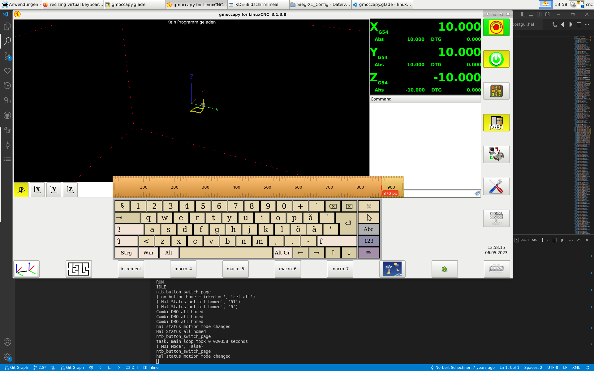

Does anyone knows how to resize the virtual keyboard (onboard) in Gmoccapy? I have a 16:9 touchscreen screen with the Gmoccapy running in full screen. The virtual keyboard gets unusably large and I can't find a way to make it smaller.

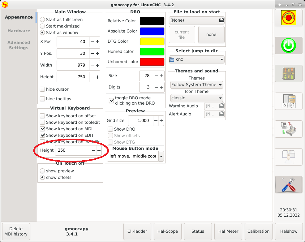

If you are using LinuxCNC 2.9 / Gmoccapy >= 3.4.0 it is right here:
[linuxcnc.org/docs/2.9/html/gui/gmoccapy.html#_appearance]
If not, you have to edit the gmoccapy.glade file in /usr/share/gmoccapy

The width of the keyboard will expanded to the window width. But a good hint, I will try to add a setting for that to 2.9 as well.
Fir the height you can search the glade file for:
<object class="GtkNotebook" id="ntb_info">
and add a line like this below:
<property name="height-request">200</property>
Not tested, but it's may worth a try.

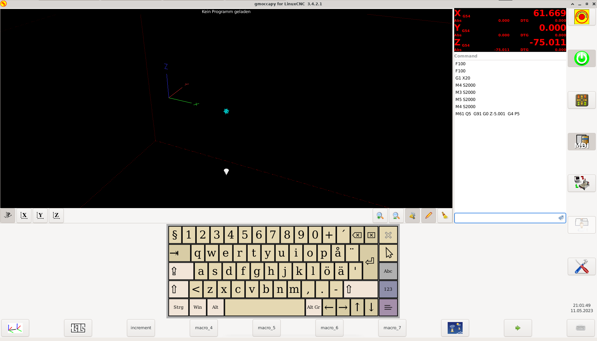

Is the height ok or should that also be reduced? Even with 2.9 it's only possible to increase the height currently.I have a 16:9 touchscreen screen with the Gmoccapy running in full screen. The virtual keyboard gets unusably large and I can't find a way to make it smaller.

Spot on! This is exactly what I think would be nice and useful to have. The height was ok in my case but the keyboard is such an important input feature that should be adjustable both in height and width.
