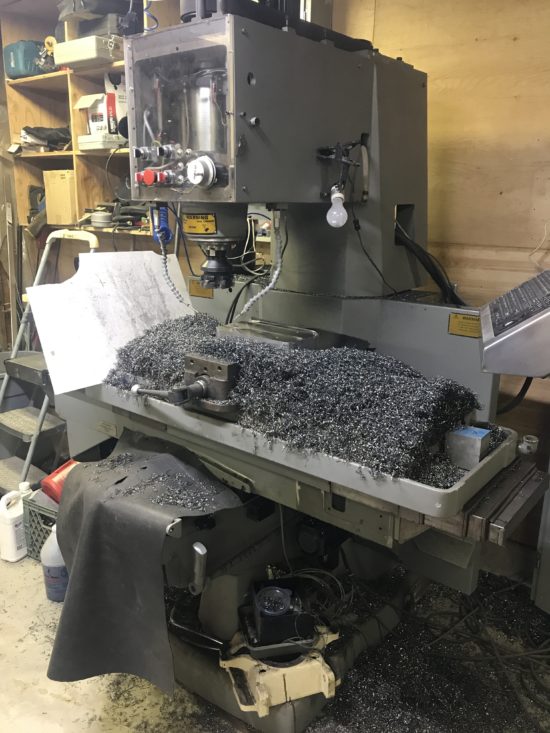

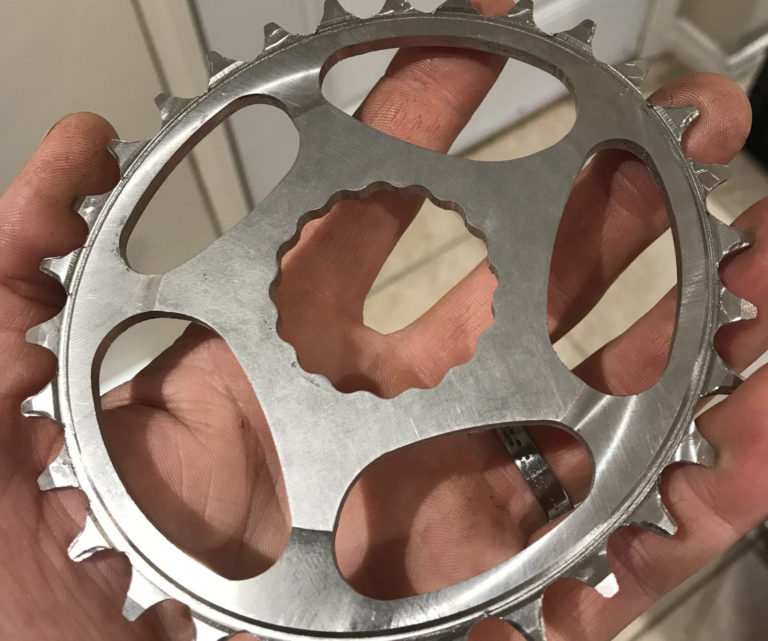

Hi Everyone,
Wanted to share my project of 7 years which is my bridgeport series 2 interact 4. Bought in 2015 as a half done retrofit and "temporarily" put it all back together with a mach3 setup to get it all running and make some parts for friends with the intention of doing a linuxcnc setup. After 7 years of it running reasonably and earning its spot in my backyard machine shop the time has finally come to switch. In 2020 I moved my machines from Canada to New Zealand where I live permanently now and the mach setup has never been quite the same (probably due to the dirtier power here), so time to add some robustness.
I have had a 5i25/7i76 setup sitting around for a hitachi seiki lathe project (to be coming soon) so decided to wire that in. It was working very well until it wasn't. Long story short it seems I have shorted something on the 7i76 and I can no longer connect to the card, getting the "output-00 not found" error on startup (I'll probe around later and see if I can repair the board). Luckily before Christmas I bought the same setup that RotarySMP has been working with for his schaublin 125 in hopes that I could copy his HAL and get the lathe with analogue servos running easily!
I have started to port over the cards to replace the 7i76 setup and luckily my servos (Allen Bradley Ultra 3000i) are step/dir as well as 10V compatible. I have been connecting all of the boards up for testing, the setup is: 7i92/7i85 with 7i83,7i84,7i73 serial boards. I have flashed the 7i92_7i85xD.bit file with mesaflash (thanks again to RotarySMP for going through that for me already!) and have the watchdog light working on the 7i73. Next is to get a HAL file together to test some digital in/outputs and then the analogue output with encoder feedback.
