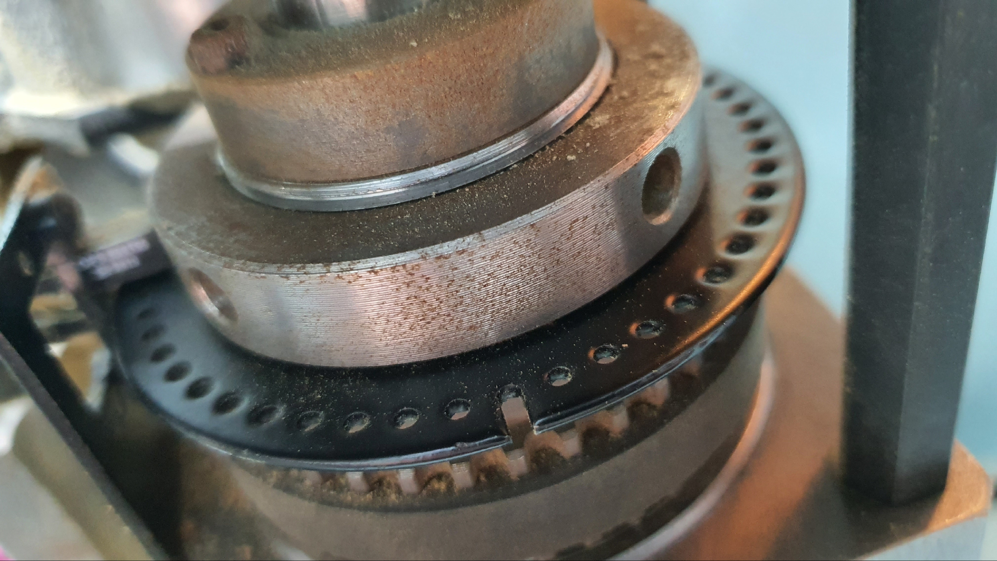

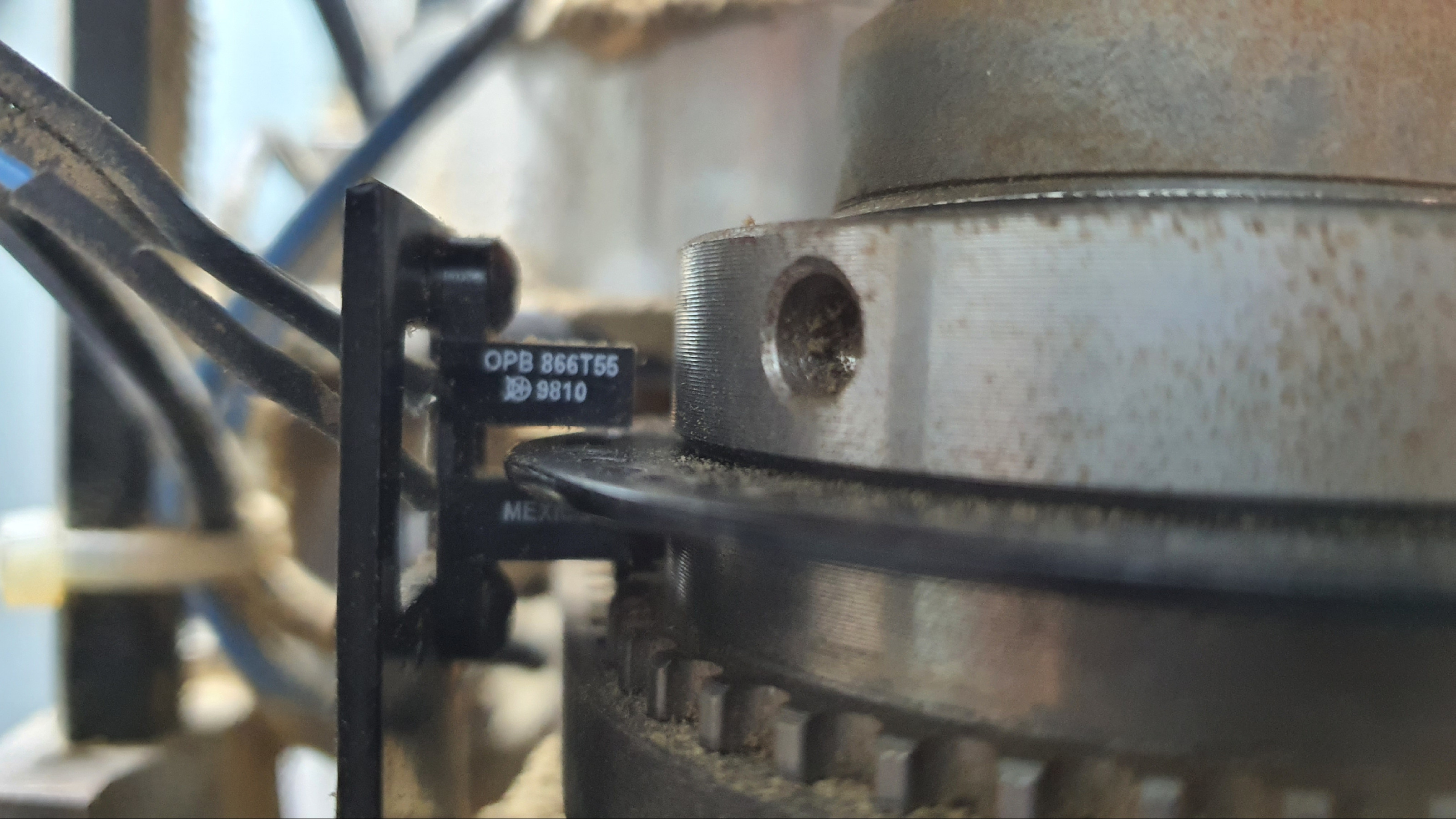

26 Jul 2023 00:13 - 26 Jul 2023 00:26 #276275 by --Matt--
Replied by --Matt-- on topic Boxford 190VMC conversion with Mesa 7i96S
A bit of an update...
The XYZ steppers are working well (using the original drivers).
There are homing switches for each axis - also now working.
The spindle is working (including stop, variable speed and direction changes).
I've connected up the lamp relay and made a custom pyvcp control for it.
This has been enough to do a couple of little milling/engraving tests under linuxcnc control. (The original manual buttons are currently disabled).
The next thing to tackle is probably the spindle encoder. The machine currently has a single slotted switch (TT OPB866T55) but has a wheel with both holes and an index slot. I guess it was intended to function only as a tachometer in this version but the manufacturer offered upgrade options.
The existing slotted switch plugs into the original main control board (which is going to be removed). So this means that the encoder will lose whatever circuit it currently has to work. I'm not sure if this switch can function directly with the Mesa card or what circuit it would need.
I'm considering replacing that single slotted switch with 3 of the TT OPB900 series as I think these can give TTL level outputs that might have a better chance of working with the Mesa card. Two would be for the quadrature signals, the third for index. I might need to make a little bracket to mount them (although it looks like the existing bracket could already mount 2 slotted switches).
Obviously it would be nice if the mill could tap holes but the spindle control seems fairly basic. It has a relay to switch the direction polarity, an enable/brake relay and a 0-10v analogue signal for speed. It probably won't ever be able to change direction quickly - it has to be stopped before it can engage the other direction.
What do you guys recommend?
I'm leaning towards slotted switches over a stand alone encoder as that will allow me to use the existing drilled wheel. Are there particular models recommended here? Also, are there any ready made pcb's that I can use to wire the slotted switches to and get a more standard encoder output?

26 Jul 2023 17:03 - 26 Jul 2023 17:05 #276317 by PCW
If you use opto-interrupters on that disk you will probably need to make them adjustable
to get decent quadrature, so a pre-built PCB is unlikely unless you make it yourself for
the specific pitch of that disk.

26 Jul 2023 21:00 #276324 by depronman
Replied by depronman on topic Boxford 190VMC conversion with Mesa 7i96S
if you are trying to achieve rigid tapping then forget it, the spindle does not have enough torque at the speed that you would use for tapping.
This is the reason that the VMC190 only had the index signal on the spindle so it would know spindle speed.
The ring that as the slot and holes is a common Boxford part hence it is fitted to the VMC190
