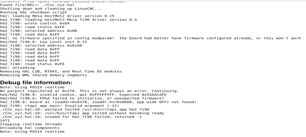

Hi, i have motherboard asrock n100dc-itx, setup Parallel port to ecp+epp v1.9 but start lunuxcnc i get error invalid cookie, got 0xffffffff, expected 0x55aacafe, please help me. Thanks.

3 months 4 weeks ago #347515
by telmoram
Replied by telmoram on topic Motherboard asrock n100dc-itx no connection with 7i90hd
hi, i have this error.
- Posts: 17533
- Thank you received: 5334
3 months 4 weeks ago #347516
Replied by PCW on topic Motherboard asrock n100dc-itx no connection with 7i90hd
Can you post your hal/ini files?
The IO addresses (ioaddr and ioaddr_hi) are crazy

- Posts: 17533
3 months 4 weeks ago #347522
This is particular is quite weird:
hm2_7i90: selected address 0x8100
Not really sure whats going on
Does the port at 0x378 work as a normal parallel port?
