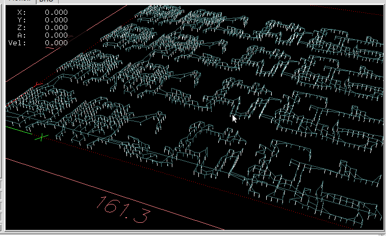

I add decimal point in Calc, and auto-replace some codes according to G-code rules in Writer (a bit tricky: '\n' acts as line delimiter in RegExp autoreplace mode). Only i add to g-code are header, footer and small routine to place paste pieces. It was quick and conforms to KISS rule B) Drop me a line if you need details.
But the result i still can't use due to too many long X-Y jogs present (i.e., components not grouped). I will try to solve it... But i hope it is already very useable for people who has air compressor and electrical valve for control of paste flow - you just place valve relay control in subroutine.
Please see example picture :-)
(example output)
X178.054Y135.382
O100 call
Y137.922
O100 call
X186.690Y121.920
O100 call
Y119.380
O100 call
Y137.160
O100 call
Y139.700
O100 call

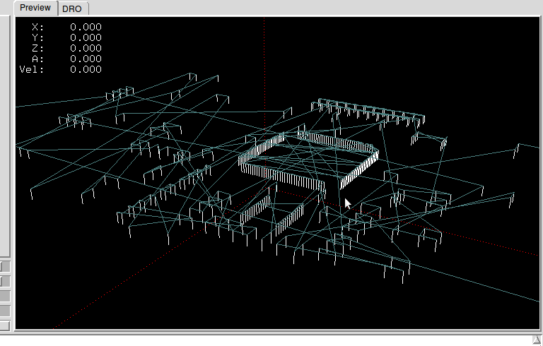

This sort (grouping of components to limit max jog length) is looks to be required for me, because i have free-running solder paste flow from needle. It is may not required for people who use switched paste flow.
So i now start C programming. While writing in C is a headache for me, hope results can be useful in community. Maybe real programmers can help me with two tasks:
1. Take Gerber string like X248920Y120650D3*, Y123190D3* and pull one or two values from it into float variables;
2. Has anyone an idea about minimizing jog paths algorithm? It is like a task about tourist's shortest way?

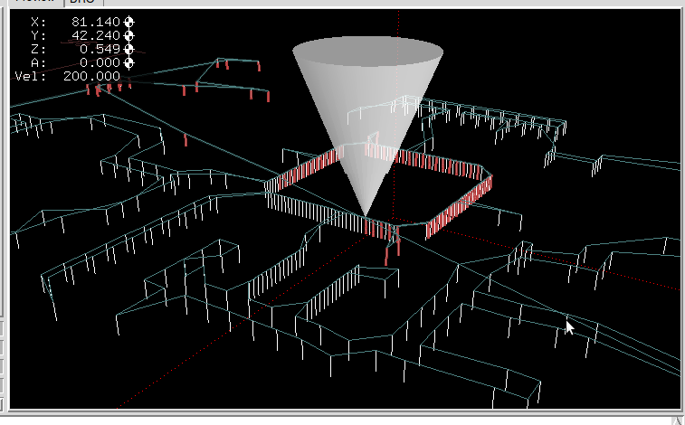

I almost done a small C program to optimize jogs a bit. While C programming is a big headache (>90% of time is hair tearing solving tasks like why strcpy not work or why variable named 'mm' works like null device), i still get some useful results. It contain Gerber parser also, so i not need anymore to turn Emc2 to work with microns. (How to mark topic as [Solved]?) I keep the code as simple and small as possible, so i hope it will be useable by others for paste or even drilling the PCB. The optimizer must minimize total path length (it's what others want), but, as side effect, result shows almost all individual jogs good enough (it's what i want).

I also test it on other pcb's and get very nice results, these are production-quality and quantity, i already put these pcb's in my radio stations and turn it on. (pick'n'place was done too and it of course EMC-controlled; there is not too much of programming because of optimizing almost not need; if anyone need then i publish my C code.) I was impressed how quality and precise is EMC-controlled hardware work! Thank you developers for such a quality software suite! :silly:
