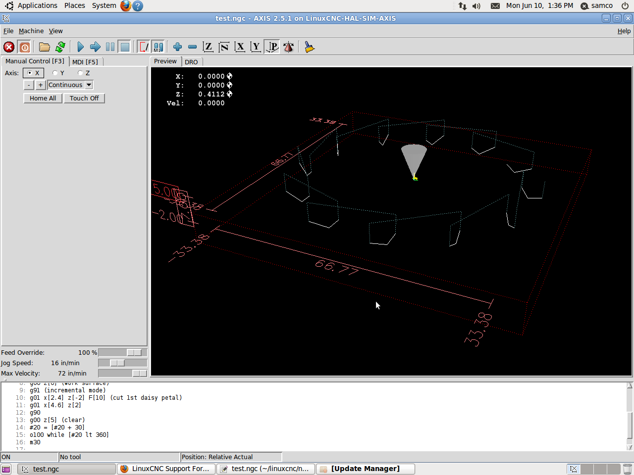

10 Jun 2013 20:37 #35500 by skunkworks
Replied by skunkworks on topic Rotating a profile - 'flower arranging' !
do you mean... The g10l2p1r[whatever] rotates around the current coordinate system zero.
#20 = 0
g00 x[0] y[0] z[5]
o100 do
G10l2p1 r#20
g00 x[20] y[20] (1st daisy petal, location of outer tip)
g00 z[0] (work surface)
g91 (incremental mode)
g01 x[2.4] z[-2] F[10] (cut 1st daisy petal)
g01 x[4.6] z[2]
g90
g00 z[5] (clear)
#20 = [#20 + 30]
o100 while [#20 lt 360]
m30

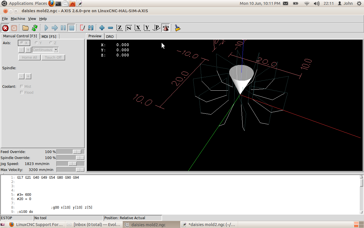

10 Jun 2013 21:27 #35503 by grey1beard
Replied by grey1beard on topic Rotating a profile - 'flower arranging' !
Thanks skunkworks, that's very close.
I can see the principle, though I'll have to tease it apart to see how to use it, never having come across it before.
The 'petal' is not pointing to the centre, but curing that will teach me how to produce a universal method.
Thanks again, and if I get stuck, I'll give you a shout.
Regards,
John

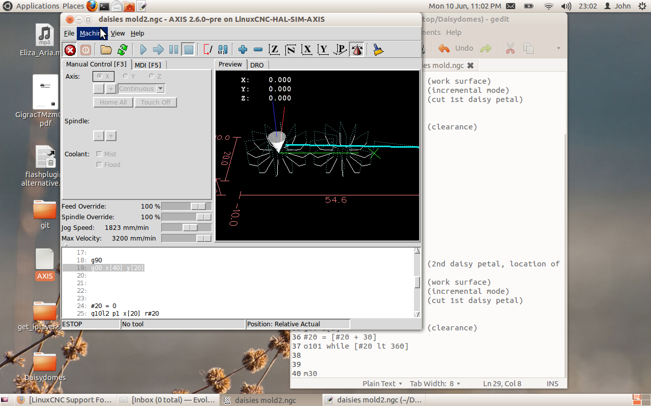

10 Jun 2013 23:13 - 10 Jun 2013 23:17 #35505 by grey1beard
I think I've now got the hang of it, so this is the desired code -
G17 G21 G40 G49 G54 G80 G90 G94
#3= 600
#20 = 0
o100 do
g10l2p1 r#20
g00 x[10] y[0] (1st daisy petal, location of outer tip)
z[0] (work surface)
g01 x[-2.4] z[-2] F#3 (cut 1st daisy petal)
g01 x[-4.6] z[2] F#3
g90
g00 z[5] (clearance)
#20 = [#20 + 30]
m30

10 Jun 2013 23:58 - 11 Jun 2013 00:01 #35508 by grey1beard
While you're in a good mood, how do I step the coordinate system in the x axis sideways, so that I can start to build up a matrix of the daisies ?
I thought g92 x- might do it, but doesn't seem to, even after moving the position of the tool first, then setting g92 to the same value.
John
Hang on, I think I've got it.
Last edit: 11 Jun 2013 00:01 by grey1beard.
11 Jun 2013 00:04 #35509 by grey1beard
Seems to be the method - left the x axis value out of the new g10 line :blush:
11 Jun 2013 00:21 #35510 by grey1beard
Final question on this topic - is it possible to nest the complete g10 instruction 'block' into a repeat loop, so that I can reduce the length of the code for a 54 set matrix ?
John
