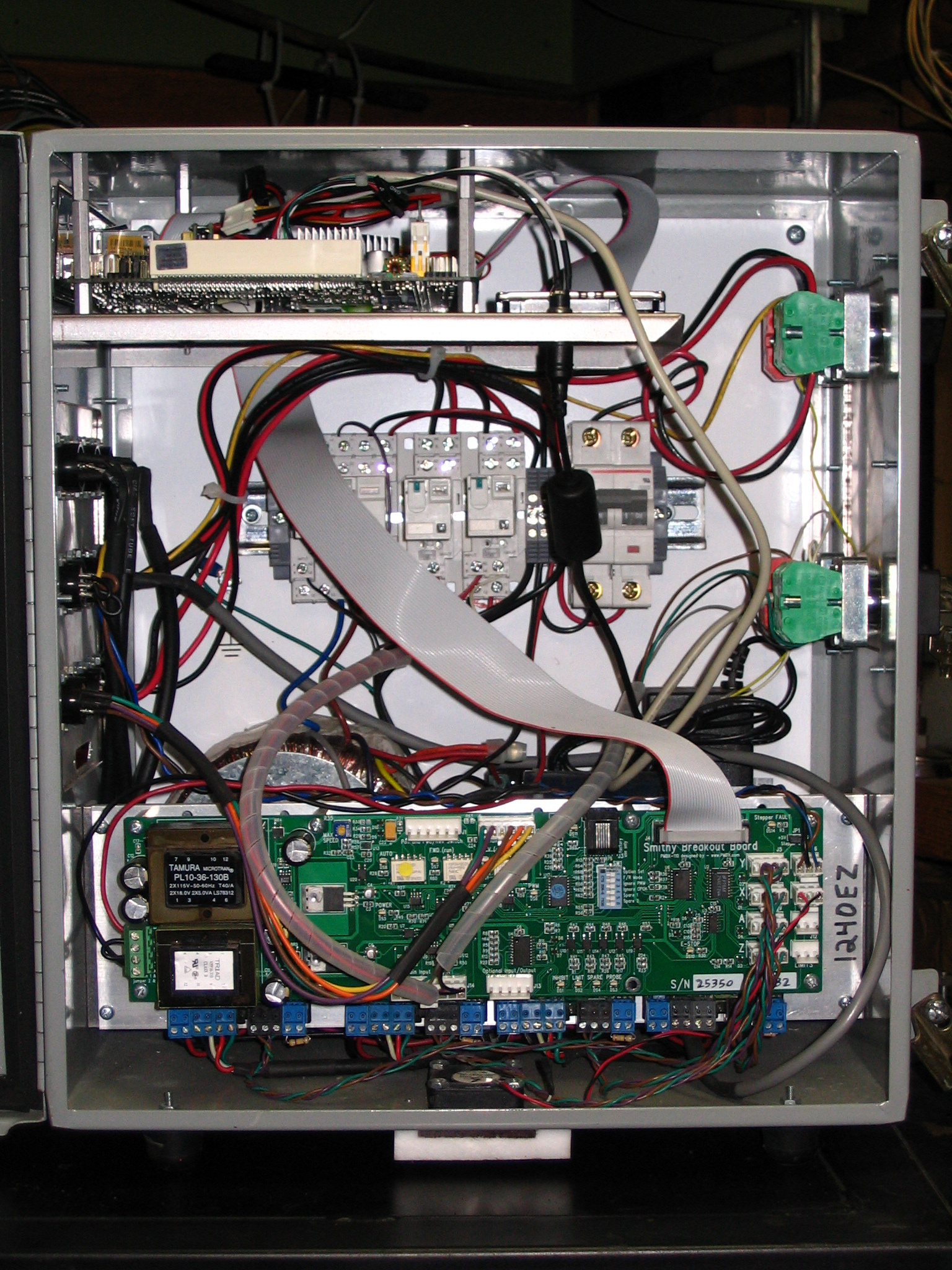

06 Aug 2020 17:50 #177533
by fc60
Replied by fc60 on topic Machine stopped and Computer froze
Greetings,
Some progress...
I opened the door of the electrical cabinet and directed a small fan into it.
CPU temp went from 125F to 95F. The CPU is the only device that has a sensor.
I also ran the machine for two day without failure!!!
Since the stoppage always occurred during a Z-axis move I now suspect the Gecko card.
What happens when a stepper card fails? Does it lock up the computer?
I plan to buy some heat sink paste and remount the Gecko boards.
Cheers,
Dave
PS The photo attached shows the control cabinet contents.
Some progress...
Cheers,
Dave

06 Aug 2020 18:15 #177535
The picture explains a lot, the pc board is mounted horizontally at the top so there is no air movement to help with cooling and the processor nor the northbridge have fans as far as i can see. Fanless pc boards are to be mounted vertically with the cooler fins also vertically.
Replied by tommylight on topic Machine stopped and Computer froze
It will have to fail miserably to do that, so no a failed stepper drive usually does not cause the computer to lock up.What happens when a stepper card fails? Does it lock up the computer?

06 Aug 2020 18:25 #177536
by Mike_Eitel
Replied by Mike_Eitel on topic Machine stopped and Computer froze
How is the orientation of this cabinet. Standing on a small side or laying on the big area.
And be carefull sink paste is not very heat conductive. A lot only makes heat transfer only a lot worser.
The small vent on the lower part will not bring out alot of heat.
Do you have some kind of dust problem. If not place a big vent in the middle of the door and have holes leave air good positioned near to mobo and driver..
Mike
Mike

06 Aug 2020 21:49 #177557
by fc60
Greetings Mike,
The cabinet stands vertical.
I thought about adding some ventilation holes. Need to sort out a way to avoid getting metal chips where they do not belong.
I did converse with Gecko. They said my issue is with either the "motion controller", motherboard, or software.
Thanks to all for your insight.
Cheers,
David
