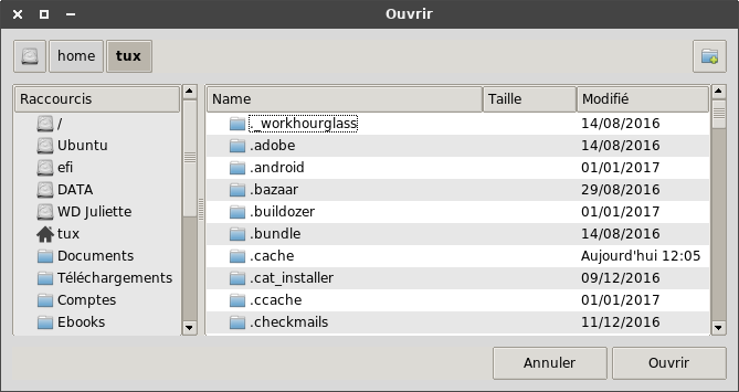

File browser-
For some reason, the linux tk file browser is not very good. I found a good candidate replacement for it
 github.com/j4321/tkFileBrowser
For implementation into usercommand file, I figured I change the open_file command here
github.com/LinuxCNC/linuxcnc/blob/3b17ed...cripts/axis.py#L2198
f = root_window.tk.call("tk_getOpenFile", "-initialdir", open_directory,
            "-filetypes", types)
change this to the new one, and any others i find
probably add something like this to the top, I think I can remove the ttk part
from tkfilebrowser import askopendirname, askopenfilenames, asksaveasfilename, askopenpathnames
try:
    import tkinter as tk
    from tkinter import ttk
    from tkinter import filedialog
except ImportError:
    import Tkinter as tk
    import ttk
    import tkFileDialog as filedialog
I have questions as to what I do with the new filebrower files....do I install it (globally?) like it says in the github using pip, or should I be putting all the files into the config folder with the usercommand , and calling on them from there? What is that called and how would I change the import to reflect that?

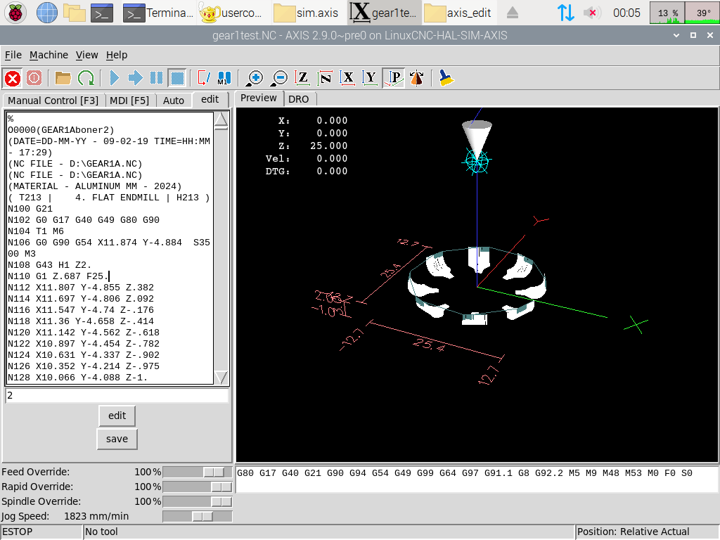

04 Jun 2022 23:17 - 05 Jun 2022 00:28 #244594 by cakeslob
Replied by cakeslob on topic Filebrowser and Gcode editor
shit i didnt explain what i was trying to do.
Trying to make embeded gcode editor, using a text widget and automatically loading the same file thats loaded into axis, and then on exiting the tab, it saves and reloads the program in axis

05 Jun 2022 23:33 #244648 by cakeslob
I have a working in progress editor tab(it looks the same as gcode tab but with broken buttons). I can open, edit and save the current file in axis. I had to do this using keybinds 1 and 2 because for some reason the commands dont work with buttons
problems:
- keybinds still work when text widget is in focus. entry widget works fine but text widget processes all keybinds, making it awful. dont know what to do about this
- from what I understand, the undo causes an issue? what if i have like max undo limit?
- doing a command on tab change, i thought this was an option for notebook but its not. axis does it somehow. trying to load the file only on tab change to edit tab, which would solve my update file problem
- doing a clean exit where it can save and reload the file into axis, and maybe close the file if thats a thing. dont know what i was planning on this one. can you do a command on tab exit some how?

07 Jun 2022 03:09 #244712 by phillc54
Replied by phillc54 on topic Filebrowser and Gcode editor
Have you tried with single quotes around the commands?
'page_switched' or 'save_editfile'
07 Jun 2022 08:35 #244720 by cakeslob
Yeah, right after I posted I noticed yours had the quotes (sending a command as a string to tcl?), so I tried it with quotes thinking that would do it, but it was the same thing ,for save_editfile at least
07 Jun 2022 18:55 #244741 by phillc54
You need to put the quotes around load_editfie as well. Basically everything in a tk.call needs to be text. The following works for me:
def page_switched(page):
    print('switched to', page)
def save_editfile():
    print('saving', s.file)
def load_editfile():
    print('loading', s.file)
TclCommands.page_switched = page_switched
TclCommands.save_editfile = save_editfile
TclCommands.load_editfile = load_editfile
rC('.pane.top.tabs','bindtabs','<ButtonPress-1>','page_switched')
rC('.pane.top.tabs','insert','end','edit','-text',' edit ','-raisecmd','load_editfile','-leavecmd','save_editfile')
