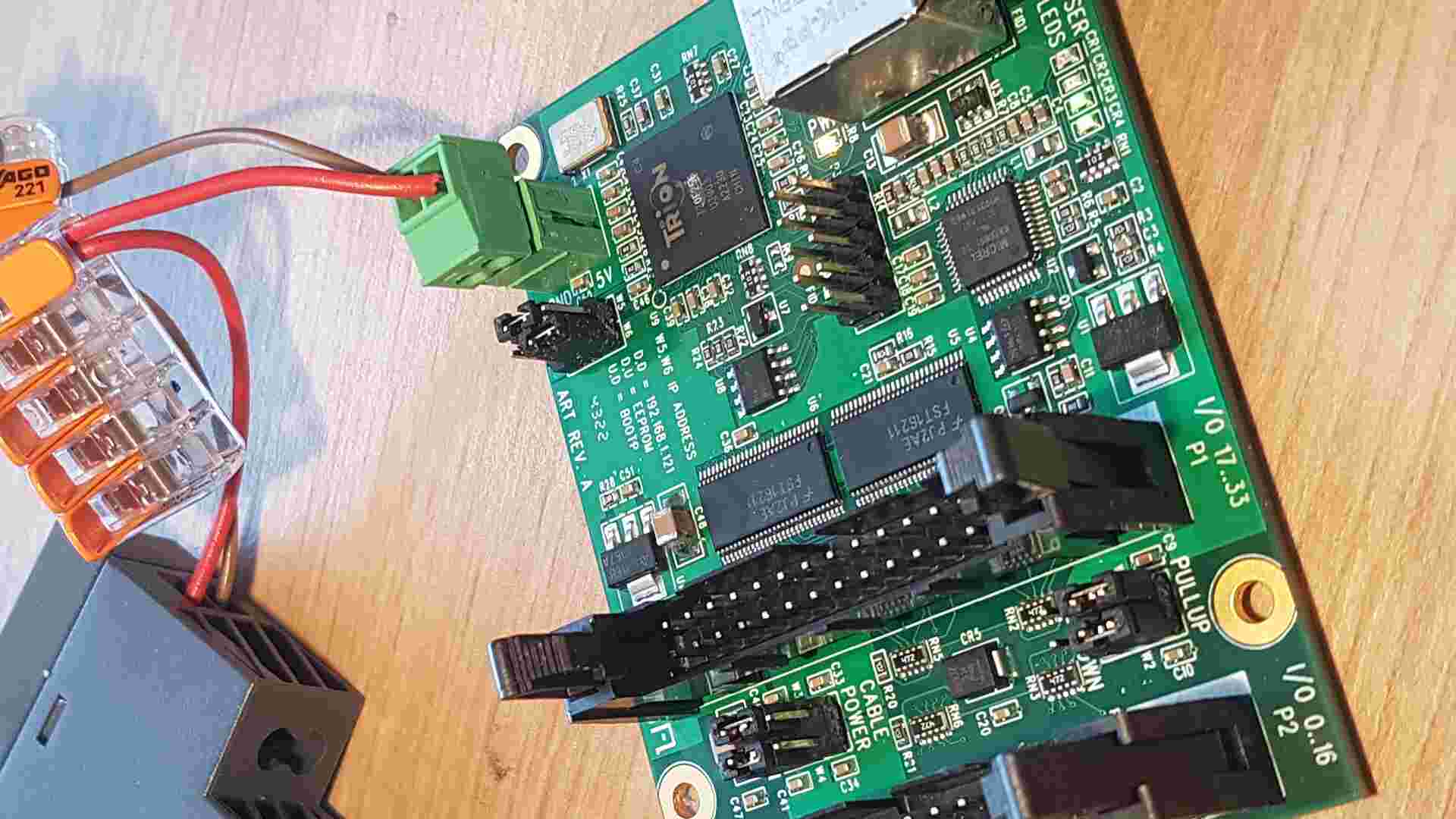

23 Aug 2025 08:24 - 23 Aug 2025 11:02 #333791
by hitchhiker
Replied by hitchhiker on topic Homing with 2 inputs/sensors?
ahhhhaaaaa...
i think i got the firmware fixed on my table/labor mesa 7i92....
to explain:
I have everytime i configurate a new machine or want to try something a mesa 7i92 for learning on my table...
i load the firmware file for the 7i96 and look into it and found the example where index on a stepgen was attached.
Download:
link to the 7i96 firmware files
then extract and look for:
PIN_7I96_StepIDXD_51.vhd
then i saw in the file:
(StepGenTag, x"C2", ClockLowTag, x"04", StepGenRateAddr&PadT, StepGenNumRegs, x"00", StepGenMPBitMask),
bingo!
i add the stuff to my 7i92 bitfile...
and tada after flash i saw this in my terminal output:
this is how it must look, right?
thanks
