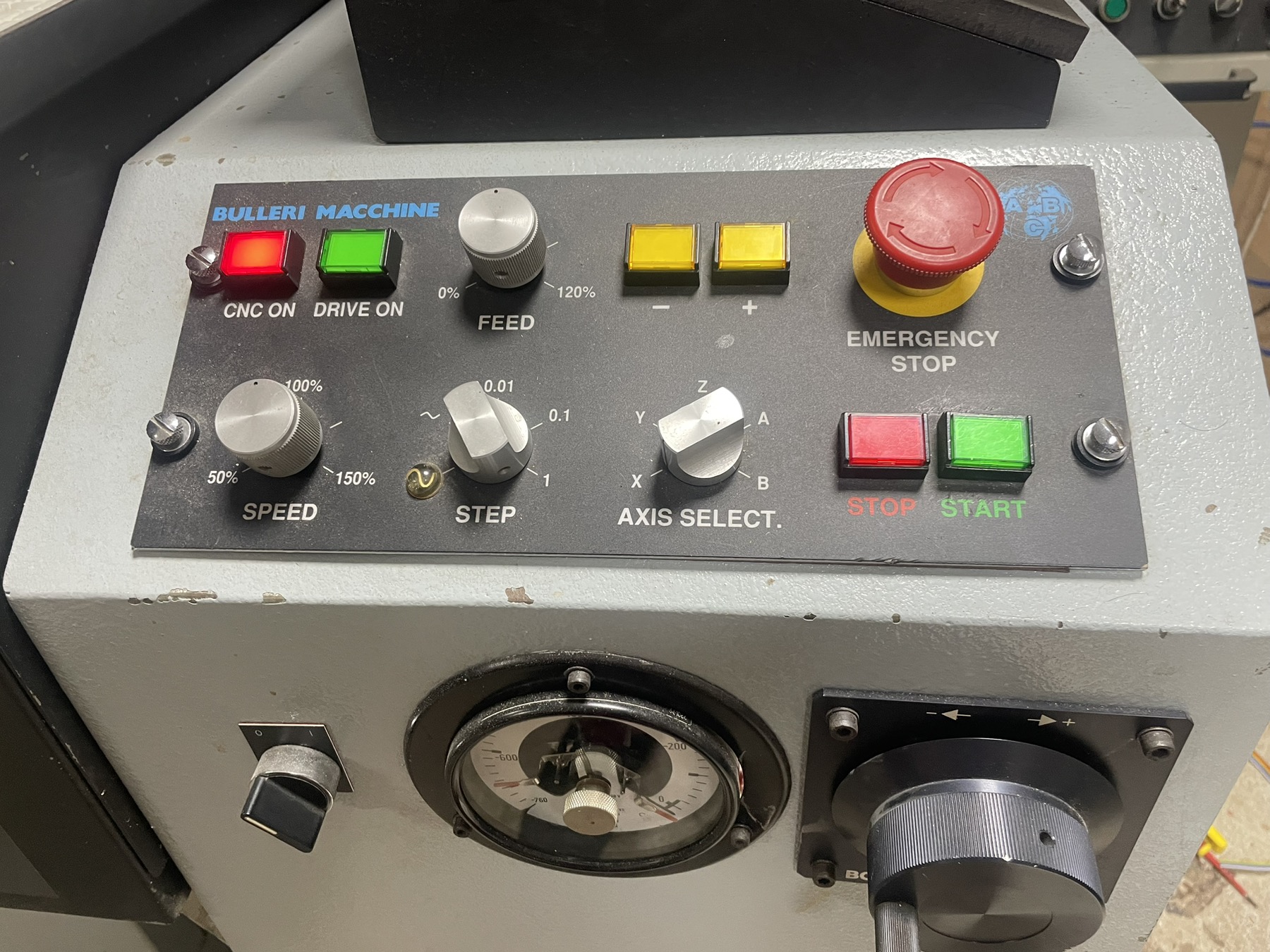

by Masiwood123
Physical buttons to 7i96s+7i77 was created by Masiwood123
..in connection with the machine retrofit #338210

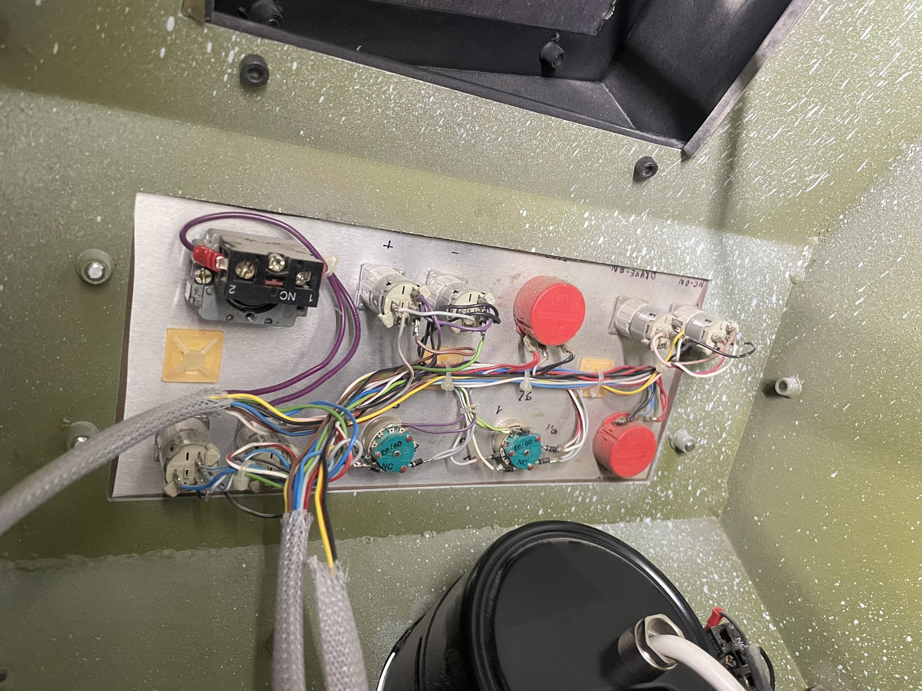

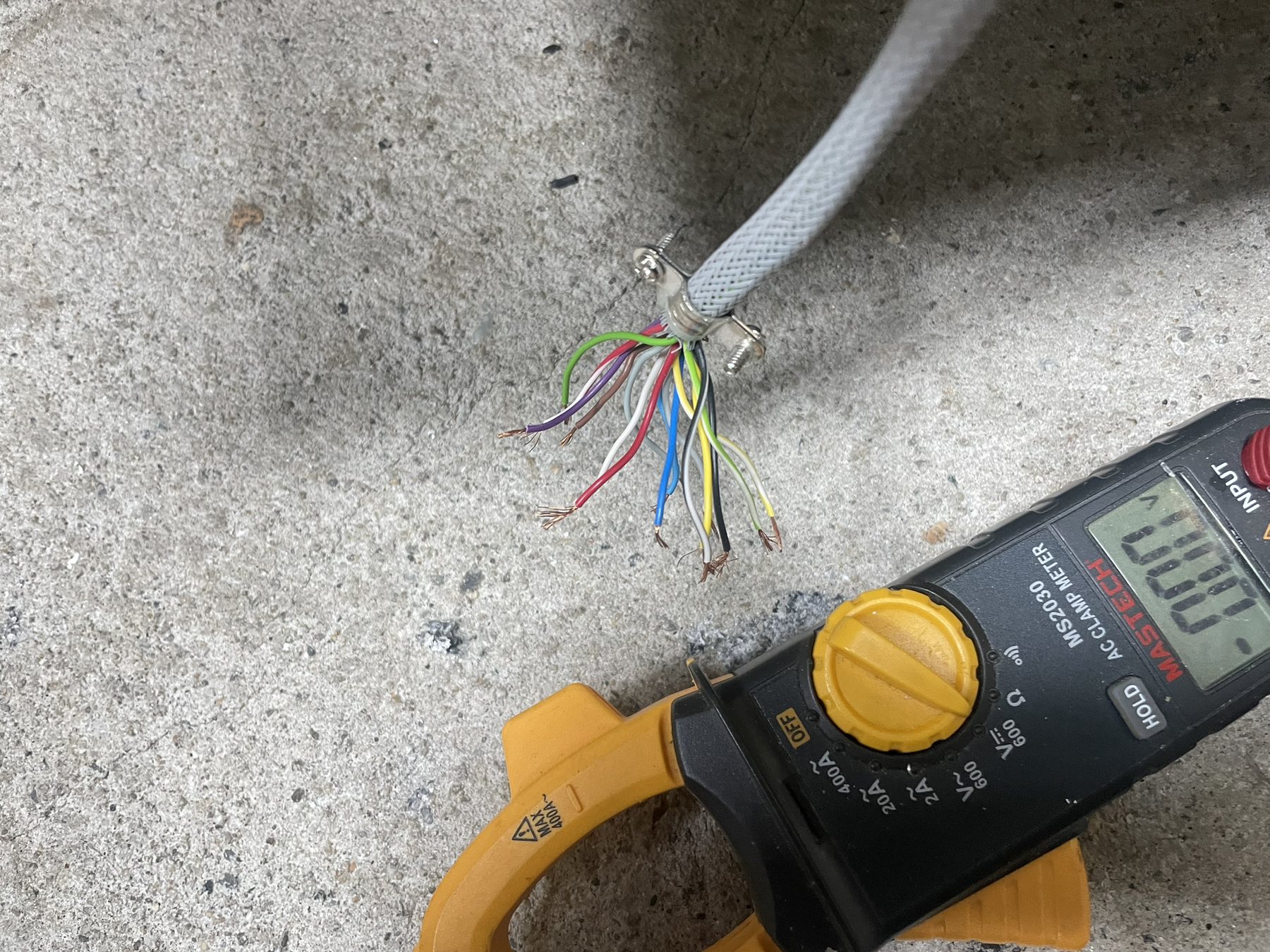

, I would like to include the hardware buttons in the configuration, also calculating the mpg. I have a lot of free inputs (all on 7i96s) and about twenty on 7i77 where I left the first three free as I understood that they are analog because of the potentiometer) now I need a suggestion, since dont have schematic for the old controller and not for the buttons, I think they are all on 24vdc including mpg. the outputs that I connected to 7i77 lit the bulbs of these buttons at 24v. should I try the configuration in terms of the mpg pendant for selector increments and mpg, and for spindle and feed override how should I connect? Thanks

2.9.0. I didn't have a 7i92 with me, so I used a 7i96s as the main card, which turned out to be better because I'm planning two additional axes later that will use steppers...now about mpg, maybe and I have an example to try...but I didn't have any experience with connecting potentiometers for feed and spindle override, and any Hal example would be valuable to me.

yes, I knew about the 7i96s, yes, I had connected two independent ones when I had a lathe that worked in sync... here I will find an example for one via the axix selector,as a pendant I think it's not a problem. My problem is that I don't know how to connect potentiometers in the hall (if the first three inputs in mode 3 are analog on the 7i77?) how can they recognize it in the hall as spindle override and feed override?
