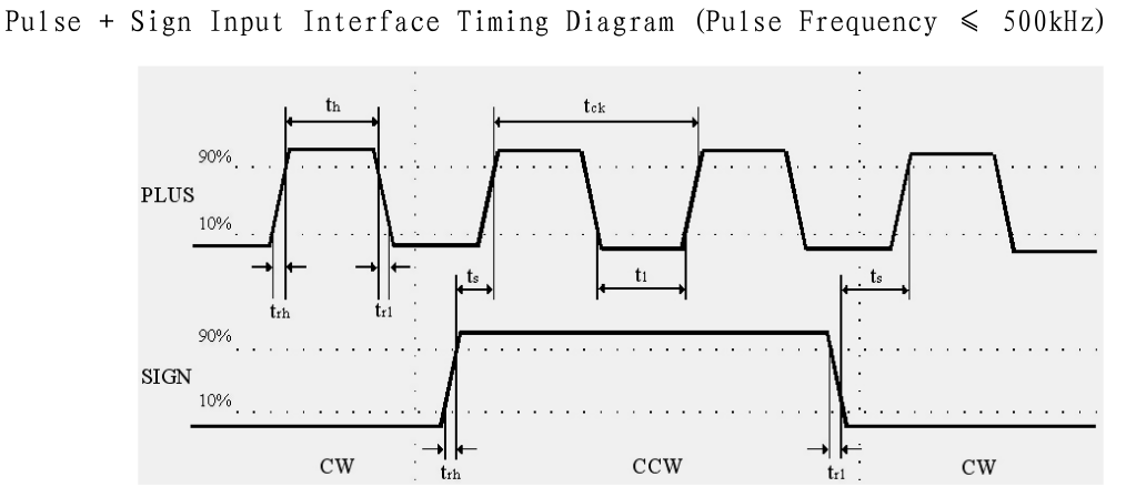

I have a servo drive (driven with differential signals & step dir) that gives a diagram with timings but i can not understand it
here is the manual at page 17 has the timings
www.vitalsystem.com/portal/cnc/motor_and..._AC_Servo_Driver.pdf

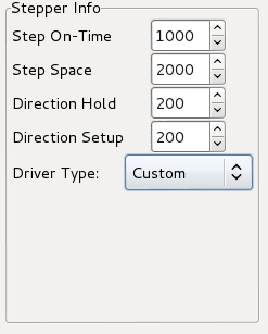

what values must insert in pncconf wizard ?
Can someone help me ?

Is possible to find someone without info from the manufacturer the optimal step on-time / step space / direction hold and direction setup ?
Is there any standard procedure of trial and error to find these timings ?
If i set to high values like 5000ns i have speed drop if i set to low motor does not work.

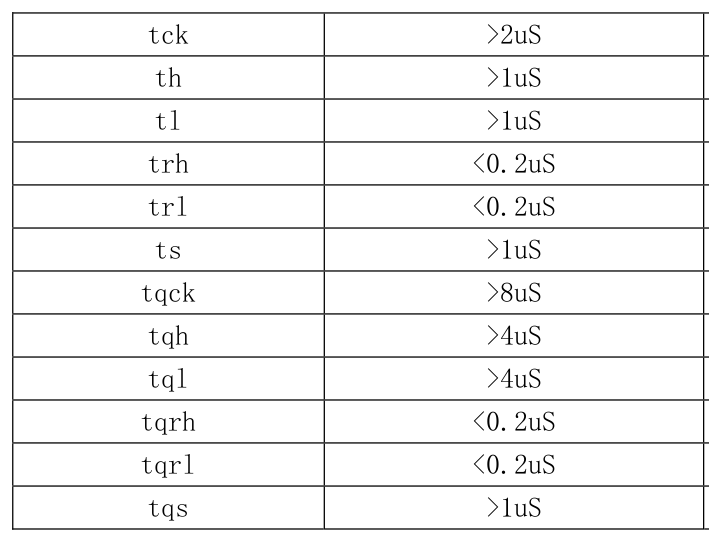

Your chart you posted has all the info you need
th = Step on time (1000ns)
tl = Step space (1000ns)
ts = Direction setup (1000ns)
Direction hold isn't expressly given, but I would assume 1000ns
If those don't work for you try doubling them, and if you still have trouble, check wiring for noise and voltage problems.

I have tested with 1000ns but losses steps.
1500ns is ok don't loose steps but i can't get speed 3000rpm (i get 1950rpm without errors) is any solution for this ?

no iam using mesa 5i24 step generator and yes to get full speed 3krpm i need 10k steps/rev
but i can not get full speed with 1500ns timmings i get only 1950rpm without errors

Maybe it is a TTL voltage problem, the 5i24 only has a 3.3v signal, perhaps this is a marginal voltage level for your drivers?
Do your drives accept differential signaling?
Perhaps Peter could recommend a better daughter card to handle the signal levels your hardware requires?

I would suggest a 7I52S for a differential step/dir + encoder interface
Note that you can get 5V signals out of a 5I24 driving OPTOs if you connect the OPTO LED anode to 5V
and use active low drive
