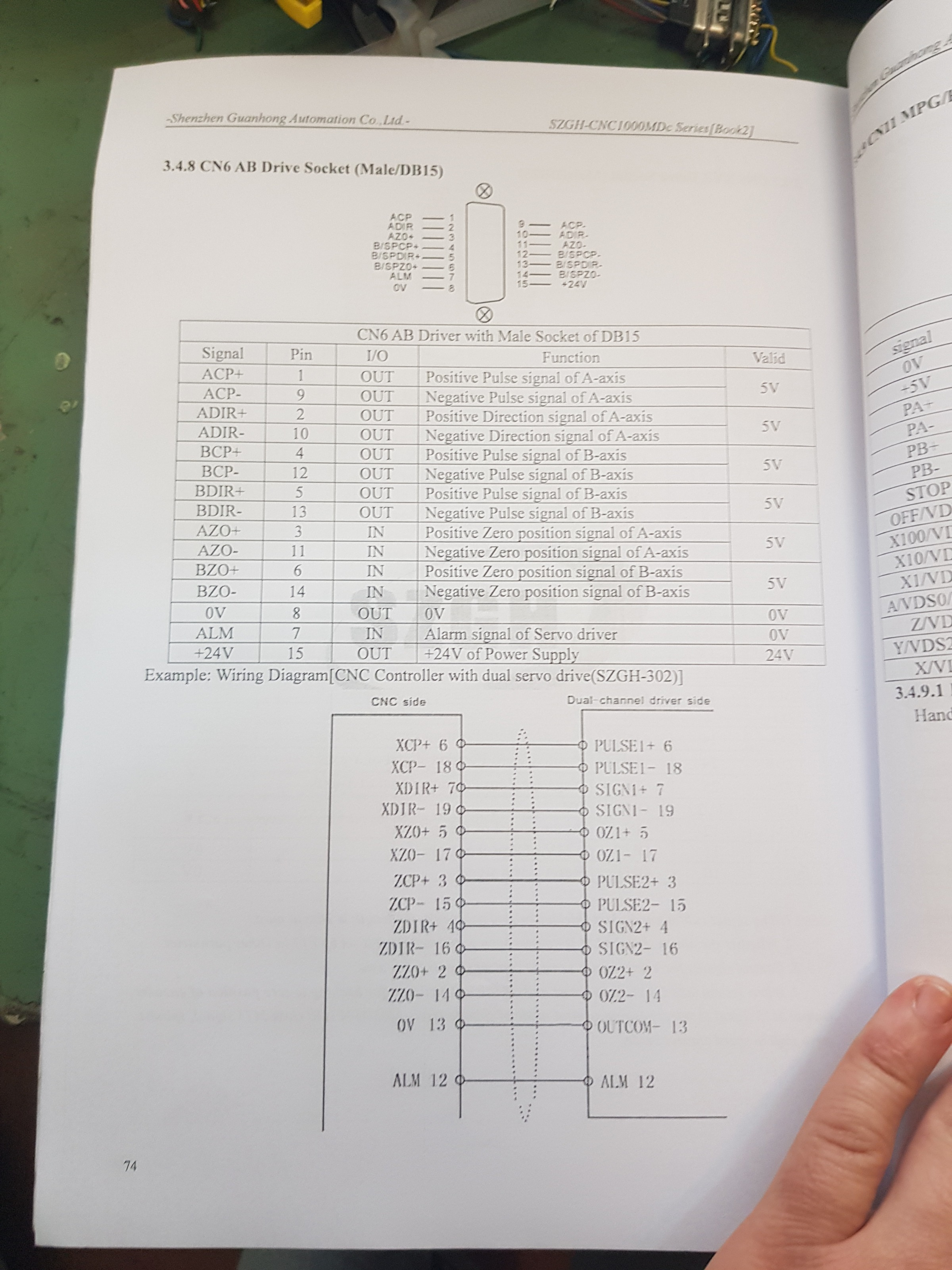

- aventtini
- Visitor
02 May 2019 09:21 #132499
by aventtini
Replied by aventtini on topic Close loop controller
This is the Servodrive
