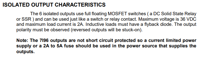

So this means I need a 2 to 5A fuse for every output I will use correct? For instance if I am using an output to control the Torch on/off with a Hypertherm Powermax 65 I should have a fuse in that circuit? Is there a recommended fuse part number (digikey) that I should use?

If you are only driving low current loads (relays,etc) a single 1A fuse for the 24V supply should be sufficient
