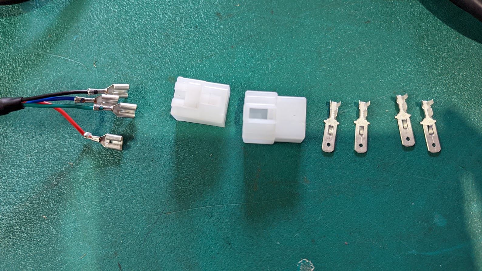

I feel your pain and want to find a solution too. On a little mill I retrofitted, I justpassed them through a cable gland that worked pretty well.
Then the next enclosure I went back to GX16 connectors but the soldering really got to me so I paid a mate who had been trained in soldering to NASA standards to do it. He did not enjoy it either.
Andy suggested the neutrik powercon connectors www.neutrik.com/en/products/power but I still see that awful word solder!
At the motor end, I have been using automotive QC connectors. These do require crimping but I was able to use a crimper I bought for about $40 from Amazon for JST connectors.
I like these because they are nice and light so OK suspended in the air. Note they are not compatible with the more familiar red/blue/yellow automotove crimp terminals (which I also use for some applications
Any Ideas, please let me know... Lets get rid of soldering!

While soldering connectors is a PITA that's not the main reason I want to avoid soldering: with the contacts carrying hundreds of volts and multiple amps, any bad connection will cause heating, which could make the solder melt and release the cable. At these voltages you really want a physical connection of the cable that is unaffected by heat.
Those automotive QC connectors look interesting. As long as their voltage rating is okay... I will keep them in mind!
