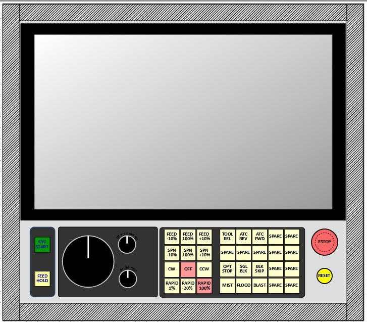

30 Nov 2022 01:20 #258065
by spumco
Replied by spumco on topic 7i84 - matrix keypad possible?
Revisiting this question as I'm working up a wiring diagram and I just had an 'uh-oh' moment...
I've got a 7i84D - sinking outputs. Will this still drive a matrix keypad? My understanding is that LCNC cycles through the outputs and inputs and looks for a state change and figures out the right key from the I/O combo.
If the inputs and outputs are both sinking, there's nothing to drive any of the pins...?
- Posts: 19899
30 Nov 2022 01:32 #258067
Replied by andypugh on topic 7i84 - matrix keypad possible?
You might be able to invert the outputs (software) and pull them up (hardware) to make it work.
But it might be easier to use the 7i73 at that point. (or buy a second one)

- spumco
- Posts: 2180
- Thank you received: 905
30 Nov 2022 02:03 #258076
by spumco
Thanks Andy.
I might as well just cram the 7i73 in the panel and use that instead of (or along with) the 7i84D.
I'm already planning to use a USB keyboard for data input, but I want an array of dedicated hardware buttons. Cycle start & feed hold will be direct I/O, but time-insensitive functions will be on the matrix.
Yes, I have a touchscreen... but I can't stand touchscreens - need some tactile feedback. And I've found that good old Cherry MX keyboard buttons are cheap, reliable, and feel great when you put heavy springs in them. 3D printers make it easy(ish) to cook up a Cherry-compatible grid panel.
Basic concept below. Haas-ish flavored fuctions.
A panel-mount USB keyboard will be mounted on a hinged swing-up thing attached to the bottom of this panel. Most times the keyboard will be flat, but if I'm doing a fair amount of editing/typing I can angle it up for better ergonomics.
