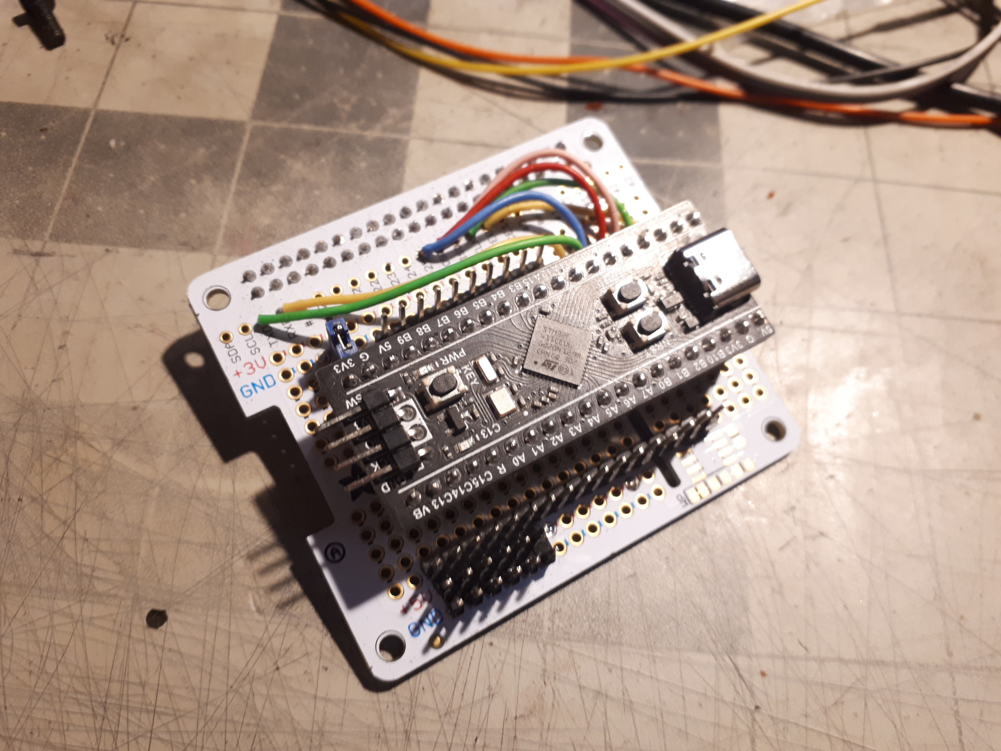

Hey, the pico branch is missing the module for encoder at the moment. Ive been looking into adding the encoder, but have not started yet because I am also not a coder.
but if 5v + $10 + RPi is your parameters, I have what you are looking for, if you are down to clown.
Stm32F411 black pill + rpi proto board.
I havent tested to much hardware yet, but if you are interested I can make an encoder version for you to test out. Dont know how high a resolution it can handle. Working on some PCB;s for this but drawing PCBs is never as fun as I think it will be.
github.com/cakeslob/Remora/tree/blackpill
STM32F446 (or other F4xx boards) Nucleo boards. These might not be $10 but I got mine for $15 CAD.
This setup I am using with 1 highspeed high res encoder, and 3 lower speed encoders. I havent done a stress test to see how high the low speed encoders can be, or how it will translate to linear scales. I have a sino linear scale I can test out later.
github.com/cakeslob/Remora/tree/nucleo_static
