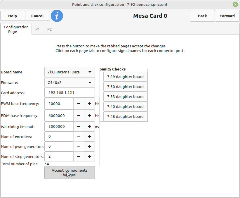

To setup pin 16 for spindle control you need to set the number of stepgens to
3 or 2 in pncconf to free up pin 16 as GPIO 5. I would also set the number of pwmgens
and encoders to 0, then hit "Accept components changes" to free up all GPIO
for any other outputs or inputs you need:
GPIO outputs need to be set to "GPIO Output" in the pin type menu:

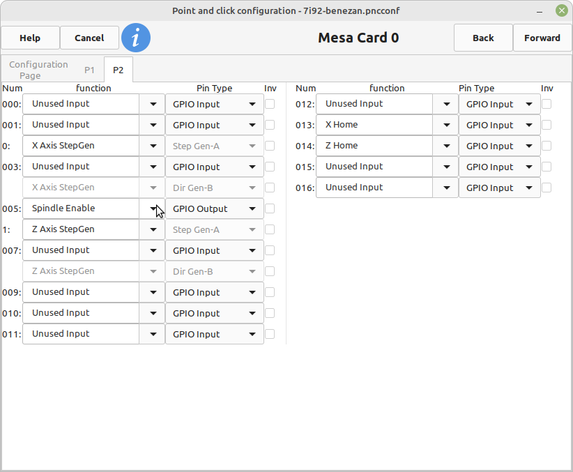

Strange. I'm attaching the pncconf file that generated the HAL and INI I posted before. When I load it, I see different screens from what you are showing. I had already set pwms and encoders to 0 and steppers to 2.
Anyway, the question remains: how do I change pin 2 (002) to be XDIR, pin 3 (004) to be XSTEP (Inverted), pin 4 (006) to be ZDIR and pin 5 (008) to be ZSTEP (Inverted)? I was thinking this needs to be done in the HAL file, but I don't see how.

I think there's a misunderstanding...
You don't need to change any pins.
If you use 7i92t_benezanx2d.bin firmware, the pins are
already correct:
already correct:
IO Connections for P2
DB25 pin# I/O Pri. func Sec. func Chan Sec. Pin func Sec. Pin Dir
1 0 IOPort None
14 1 IOPort None
2 2 IOPort StepGen 0 Dir/Table2 (Out)
15 3 IOPort None
3 4 IOPort StepGen 0 Step/Table1 (Out)
16 5 IOPort StepGen 4 Step/Table1 (Out)
4 6 IOPort StepGen 1 Dir/Table2 (Out)
17 7 IOPort PWM 0 PWM (Out)
5 8 IOPort StepGen 1 Step/Table1 (Out)
6 9 IOPort StepGen 2 Dir/Table2 (Out)
7 10 IOPort StepGen 2 Step/Table1 (Out)
8 11 IOPort StepGen 3 Dir/Table2 (Out)
9 12 IOPort StepGen 3 Step/Table1 (Out)
10 13 IOPort None
11 14 IOPort QCount 0 Quad-A (In)
12 15 IOPort QCount 0 Quad-B (In)
13 16 IOPort QCount 0 Quad-IDX (In)
