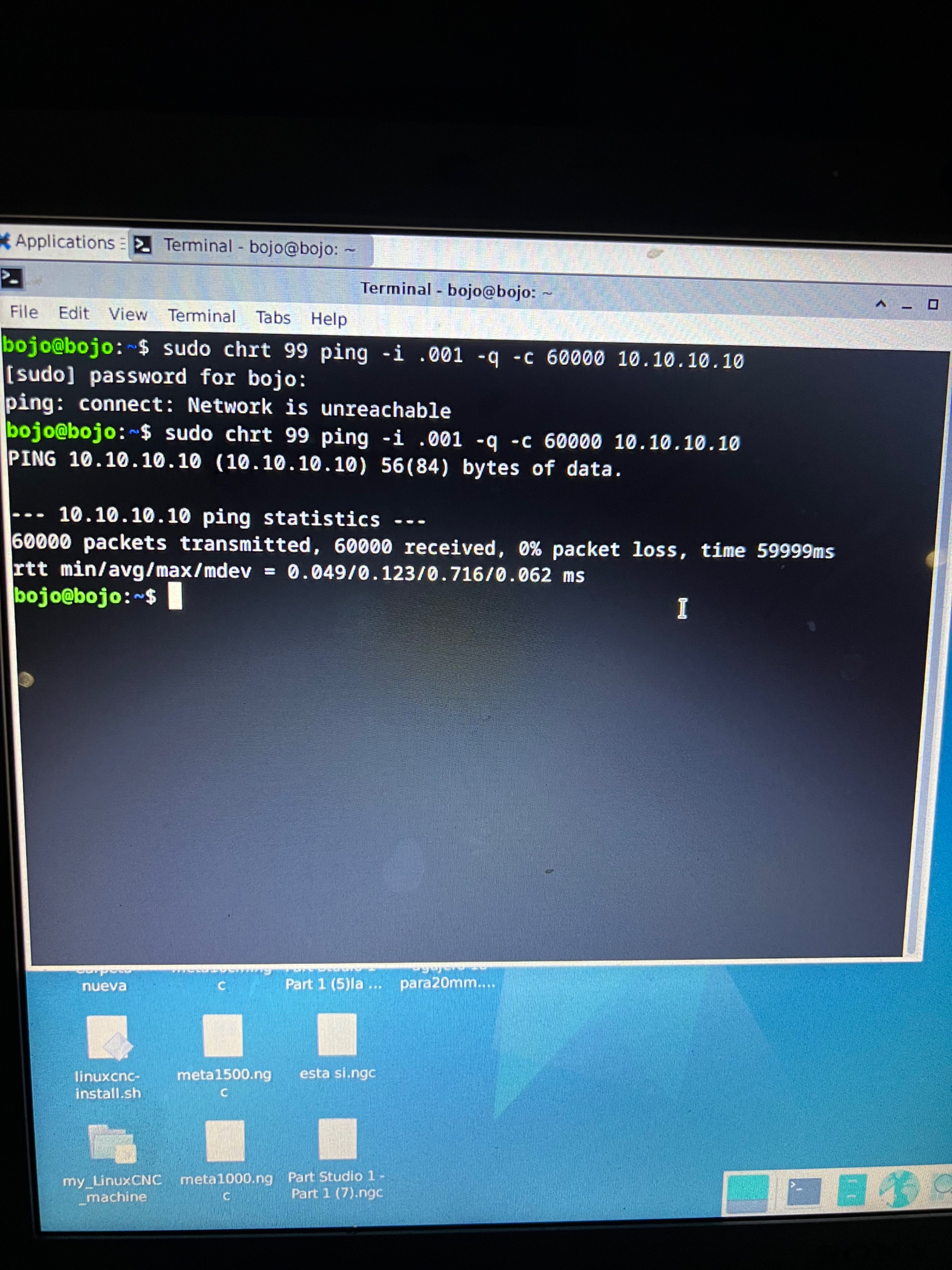

Hola, tengo un plasma CNC con la tarjeta mesa7i96s Estuvo cortando bien hasta ahora y de repente se desconecta pone que ha perdido la señal con la tarjetahm2/hm2-7196s.0: error finishing read! iter=309265 me pone esto

What PC do you have, and what is the result of:
sudo chart 99 ping -i .001 -q -c 60000 [card_ip_address]
Where [card_ip_address] is the IP address of the 7I96S (Either 192.168.1.121 or 10.10.10.10)

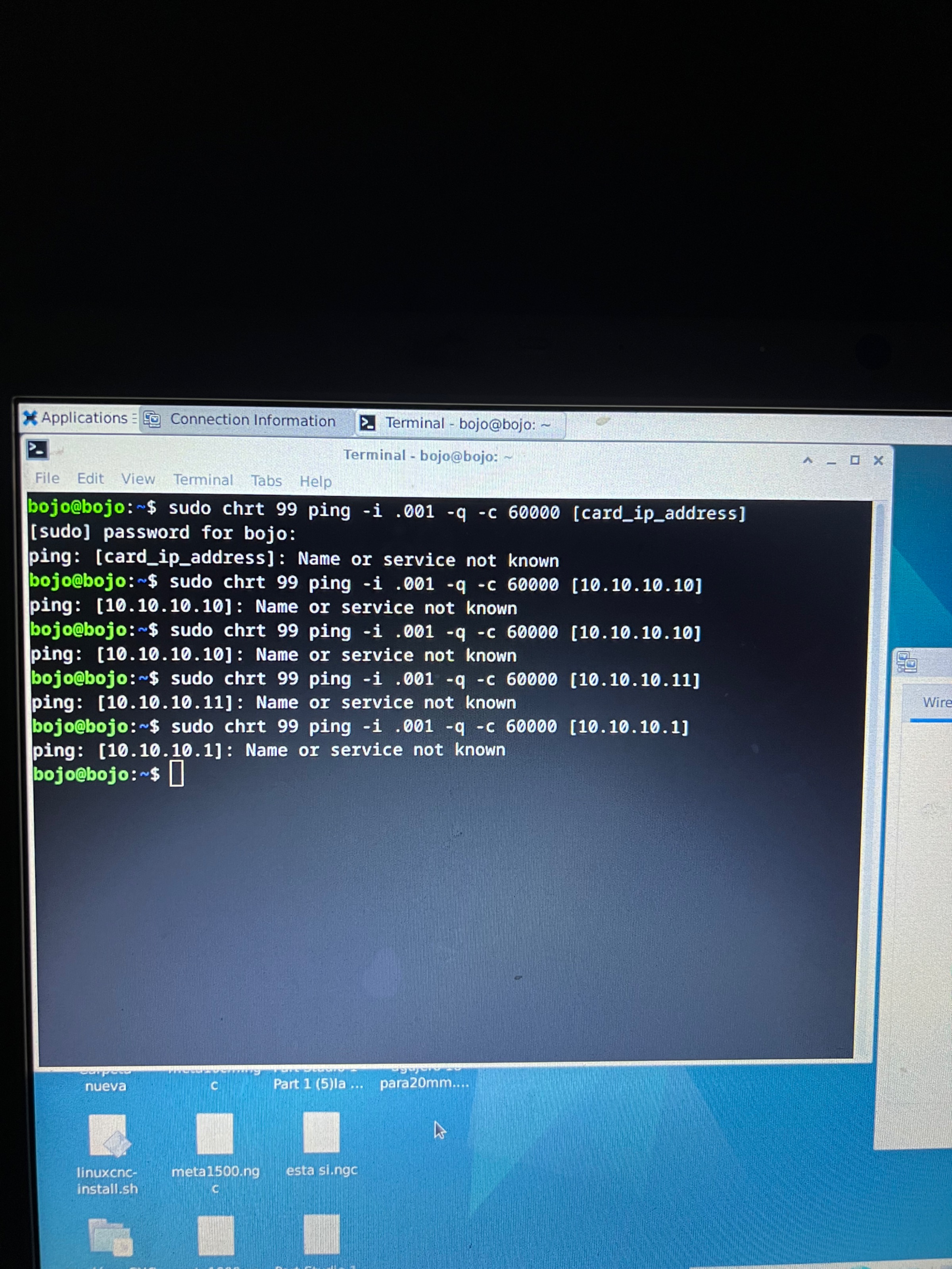

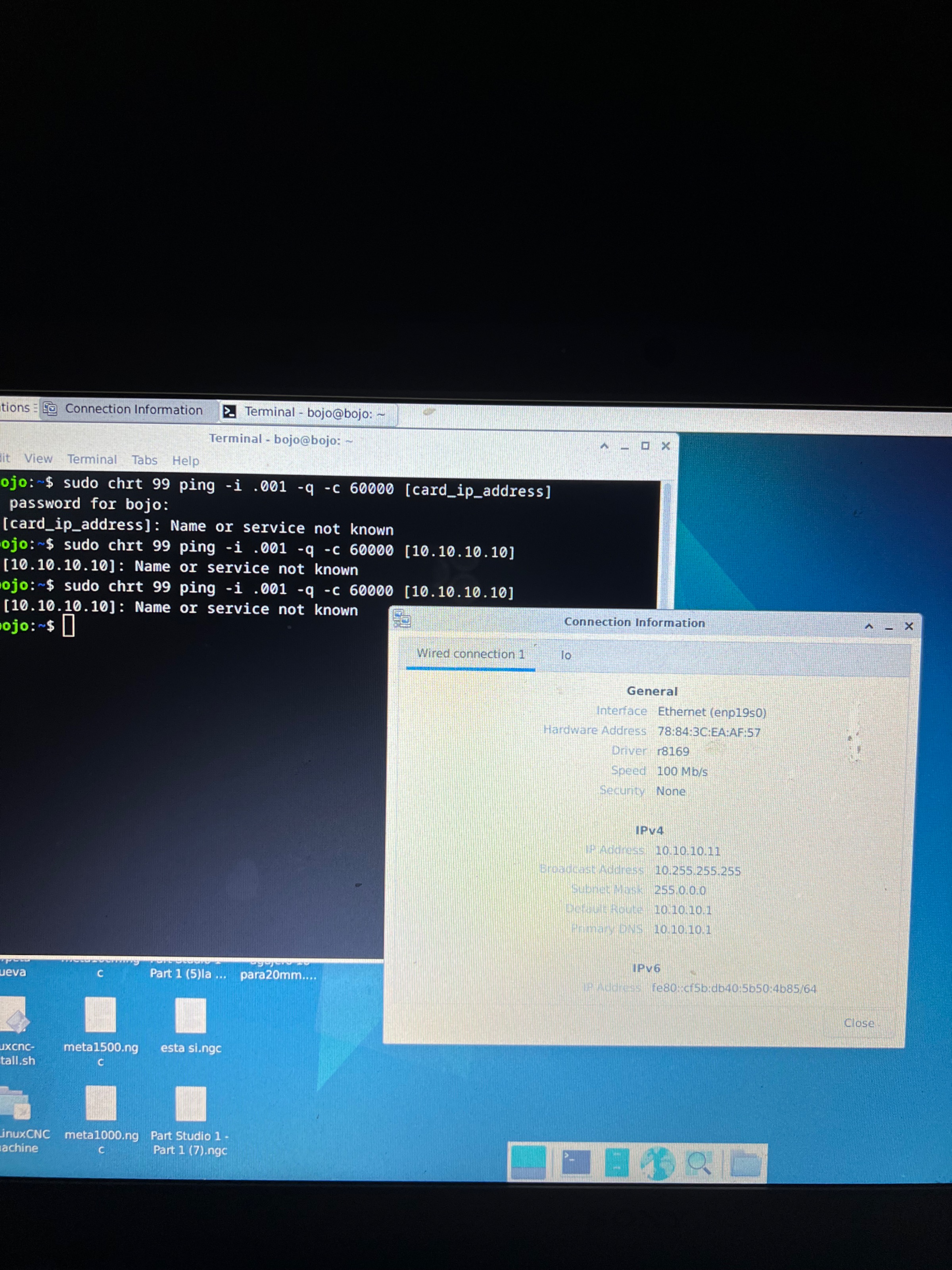

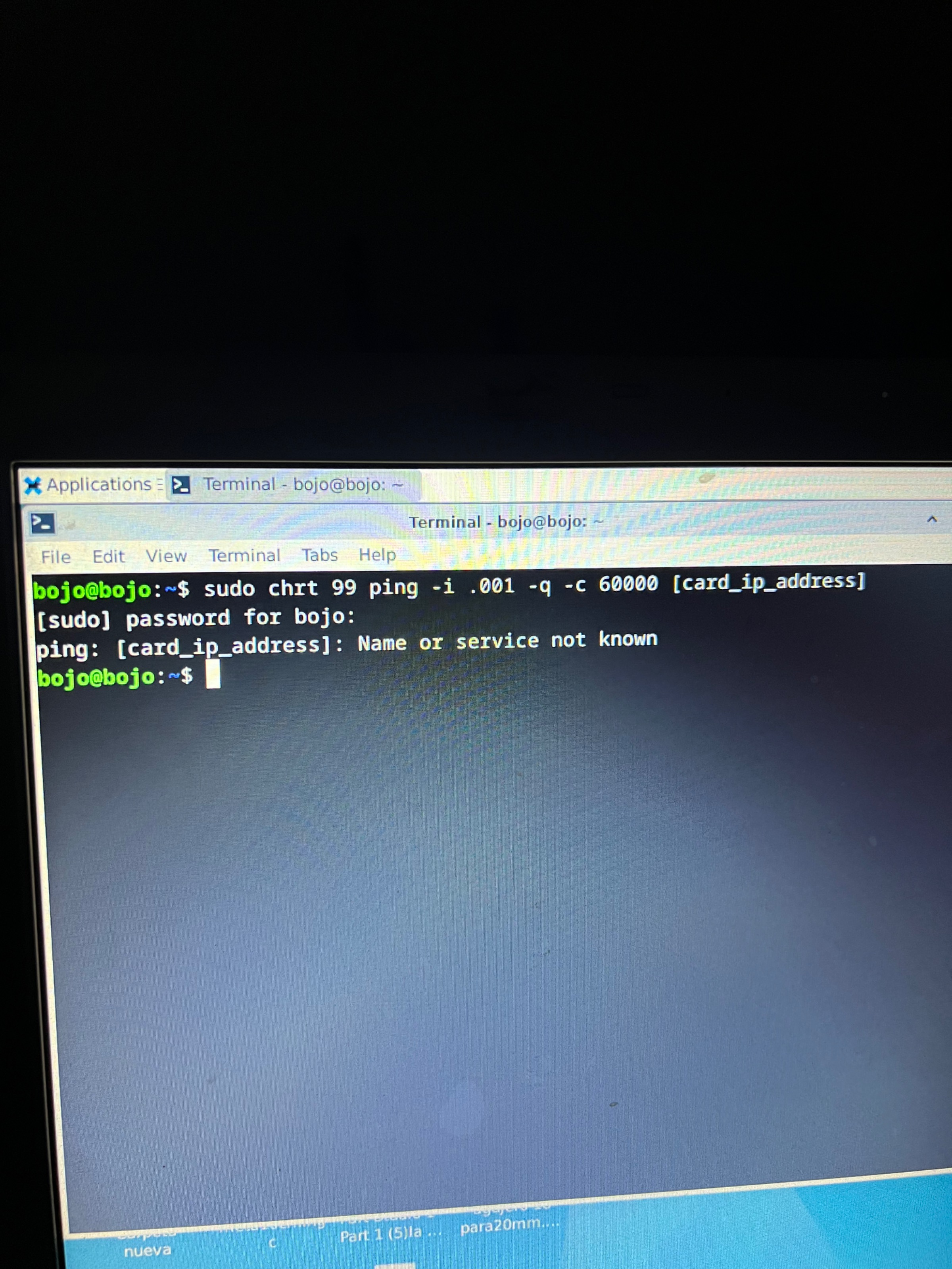

Ip address is 10.10.10.10 es un ordenador un poco viejo y la verdad no se como hacer (sudo chart 99 ping -i .001 -q -c 60000 [card_ip_address]) esto me sale not found
- Posts: 18093
- Thank you received: 5325
28 Oct 2025 17:24 #337356
Replied by PCW on topic Tarjeta mesa 7i96s se desconecta
Sorry, typo
sudo chrt 99 ping -i .001 -q -c 60000 [card_ip_address]

- Johnnysacalu
- Posts: 39
28 Oct 2025 17:39 #337358
by Johnnysacalu
Replied by Johnnysacalu on topic Tarjeta mesa 7i96s se desconecta

sudo chrt 99 ping -i .001 -q -c 60000 10.10.10.10

28 Oct 2025 18:35 #337361
Not terrible but not great either
If the PC has a Realtek Ethernet chip you will likely need to install the 8168-DKMS driver
If you don't know the Ethernet chip type you can run this script:
