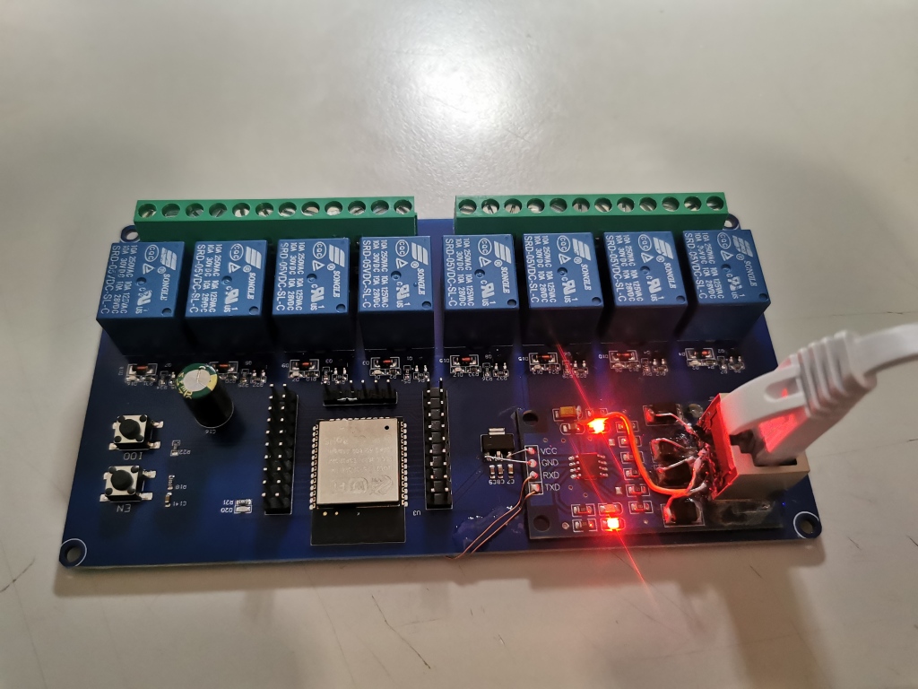

SmartSerial on cheap ESP32-8ch-Relais Card was created by meister
i modified the mesa-smartserial-device-template a little bit
and put it on a cheap ESP32 8ch-Relay board for extra Outputs.
i used platformio as buildsystem for easy use, i have also test the code on raspberry-pico,
github.com/multigcs/SmartSerial-ESP32RelayX8Board/tree/main
www.youtube.com/shorts/6ZKBH5xW8OQ
Relay-Board: www.amazon.de/dp/B0FNRH8QSN
Optional: www.amazon.de/TECNOIOT-Two-Way-Transfer-...tional/dp/B081J5R35N
Works fine with 7i92, but have still problems with 7c81 SmartSerial connector, not shure why,
maybe my pinout is wrong or problems with the TX_en stuff.
my Board with RS422 mod:

ok, works also on the 7c81 ports

Small soldered board, is it the RS422 to RS232 converter, or just a line driver?
Nice work, i do like the ESP32 due to it's versatility.

Hello, I'm trying to clone this board. Do you have any HAL file references?

7 months 1 week ago #344657
by meister
Replied by meister on topic SmartSerial on cheap ESP32-8ch-Relais Card
no, but you can see the new pins with:
halcmd show
