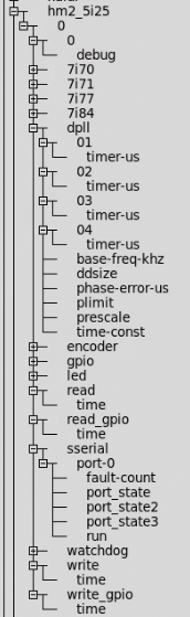

After updating LinuxCNC, it starts normally. I load it using:
loadrt hm2_pci config="num_encoders=3 num_pwmgens=0 num_stepgens=0 sserial_port_0=000000 num_pktuarts=2"
However, I have another problem: I can’t find any pins like these:
hm2_5i25.0.pktuart.0.tx-data
hm2_5i25.0.pktuart.0.tx-bytes
hm2_5i25.0.pktuart.0.rx-data
hm2_5i25.0.pktuart.0.rx-bytes
- Posts: 18118
- Thank you received: 5335
29 Jun 2026 22:40 - 29 Jun 2026 22:40 #347406
Replied by PCW on topic Request custom bitfile: 5i25 + 7i77 (P3) + 7i74 (P2) with pktUART for Modbus
The pktuart driver creates no hal pins
for modbus, you would use hm2_modbus:
man hm2_modbus
and mesambccc:
man mesambccc
man hm2_modbus
and mesambccc:
man mesambccc
