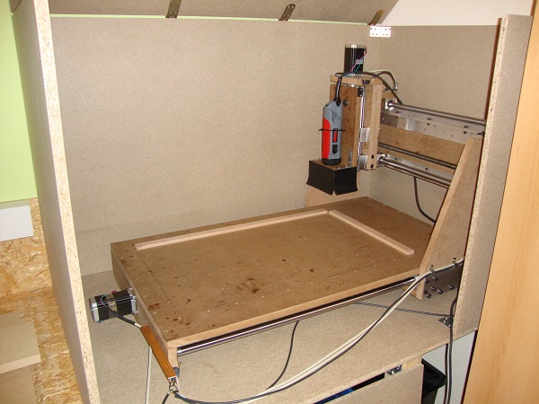

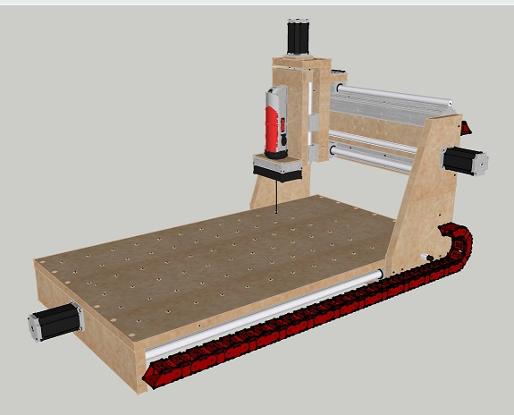

Hello all,
my first cnc router of wood (MDF) is almost finished. I used SketchUp to make the plans, this needs a lot of time, always when I thought its ready, I found something to make it better
I watched a lot of YouTube movies and read different forums threads and so i build my own cnc router step by step.
Technical specifications:
Dimensions: 1,169 mm long (46.02 inch), 760 mm wide (29.92 inch), 743 mm high (29,25 inch)
max. travel way: X-Axis 750 mm (29.53 inches); Y-Axis 450 mm (17.72 inches); Z-Axis 140 mm (5.51 inches)
used travel way: X-Axis 720 mm (28.35 inches); Y-Axis 420 mm (16.54 inches); Z-Axis 140 mm (5.51 inches)
supported rails 20mm (0.79 inches) on all axis
trapezoidal thread 16x4mm on all axis
reference switch: X- and Y-Axis (inductive proximity sensor switch); Z-Axis none
limit switch: Y-Axis 2; Z-Axis 1; (X-Axis same as reference switch)
Nema 23 stepper motors
Kress 1050 FME-1 milling motor
I'm using SketchUp v8.0 with SketchUCam and Estlcam8, and last but not least LinuxCNC
After 2 month engineer (including watching YouTube movies, reading forums, looking for software,...) and 2 month building I milled this week the first time

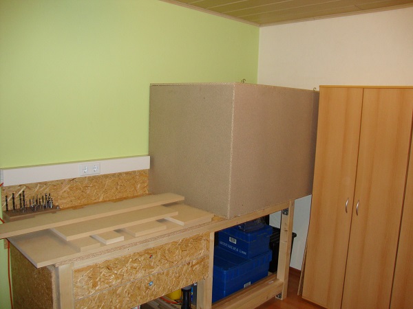

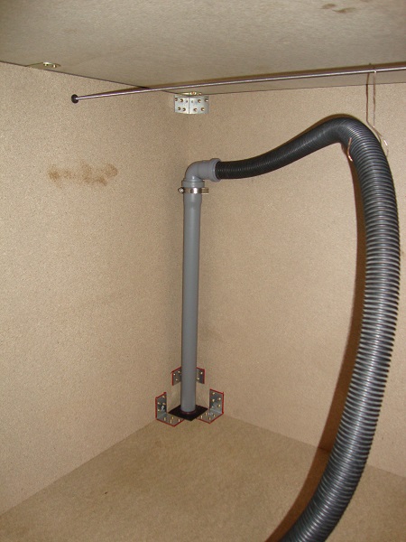

. I was happy to see the machine working, but I also was frustrated about the noise. I live in a apartement and don't want to annoy my neighbors. So I started to build a box around my router and consequently I have to build a dust extraction too.

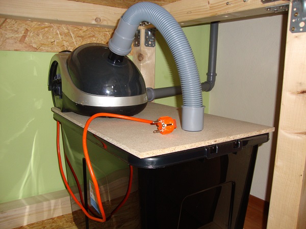

The box is almost finished and only dampening materials / insulating is missing. Because the router is now in the box, I have to build the dust extraction, that's it for the next week.

As for the noise, you can change the spindle to a silent one, but as soon as it starts cutting the noise is back, so not much joy there.
Since you already have an enclosure in place, just get some sound dampening in, it might just get it to usable levels with the closed doors.

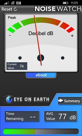

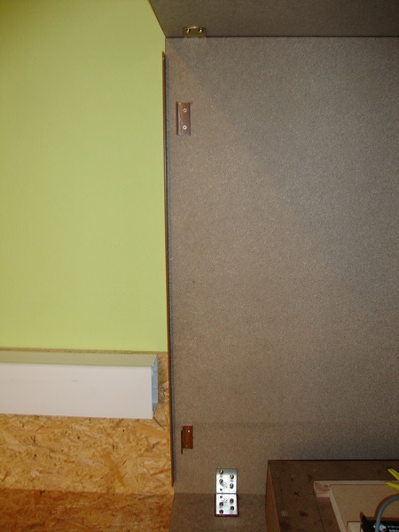

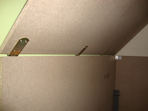

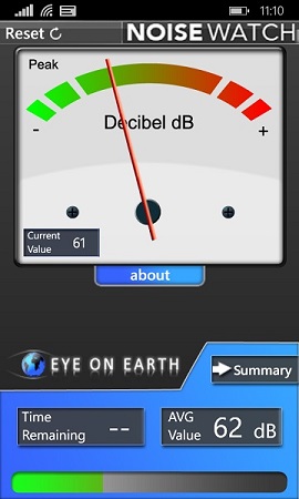

Kress company documentation says sound pressure level 78 dB(A) and noise power level 89 dB(A). My phone app decibel meter says the same, 77 dB(A) without cutting and box open, 62 dB(A) without cutting and box closed.
@tommylight: you're right, the most noise is coming from milling, not the milling motor itself. I'll make some insulating / sound dampening materials in it the next days to reduce the noise.
motor on, box open:
motor on, box closed:
Tomorrow I'm at work again and when I've finished the work, I'll take a professional decibel meter with home to measure the noise.
Yesterday I ordered 2 energy chain at ebay, i need it because the machine can't move in the box without cable mess
My project the next week ist to finish the box, building the dust extraction and the cable chain.
pictures following...
motor on, box open:
