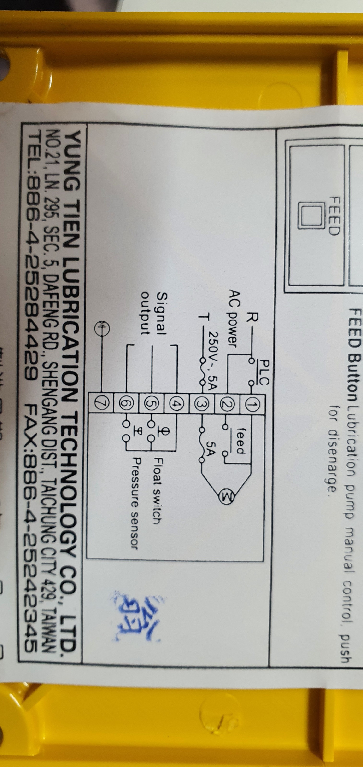

Thought I get some advice/feedback as my electrical skills are very basic.I have an oil pump for my CNC slide ways which I plan to hook up to my MESA 7i76E. I want to switch the pump on when I am running an oiling routine prior to machining (or manually whenever I think it is good). I bought already a 24V DC / 240V AC solid state relay and plan to run a power cable together with a 24V signal cable to the pump. I think it all is pretty straight forward, however, I am confused about the attached Chinese wiring diagram which I found inside of the pump.I believe ‘T’ is the live connection and ‘R’ is the neutral connection. Assuming this is correct, they suggest to switch the neutral side (be it the relay or the feed switch). To my knowledge this seems NOT to be recommended with general household appliances. electronics.stackexchange.com/questions/...-is-switched-neutral
I am currently considering of rewiring the inside of the pump that the switches are on the live side of things and before the fuse. Does that make sense?

R and T are 2 phases of an RST 3 phase system, so both are live.

Autsch... I knew there was something obvious missing.
Looks like this thing is no use for me as i only have 240v single phase.
Or is there a 'non-expensive' way to make this 2 phase 220V, 50Hz work on 240v single phase?

It should work with 240V, of course if the pump is rated for 220-240V.
In this case, cut the live wire.

Ok - so my initial line of thought wasn't wrong to rewire it and effectively making 'R' neutral?
It seems the max i can input is 250V AC according to this drawing but description says 220V. This is the pump:

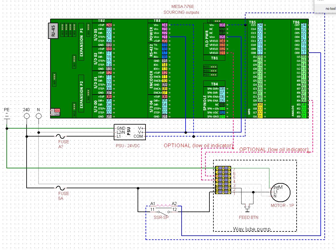

I'm shamelessly procrastinating on my own LCNC project, so here's a diagram of what I think you're after
NOTE - you did write that you're using a 7i76E, not "ED". Those are sourcing outputs and I've drawn it as such. If you're using an "ED" the 24vdc connections will be different.
PS - there are some examples of lube pump control using Classic Ladder in the CL sub-forum. Generally controls based on a timer that counts while some 'axis-is-moving' signal is on, plus a manual override to prime it.
- The pump is a 240VAC single-phase. It can be powered by
- single 240v conductor + neutral (your arrangement), or
- by 120v + 120v conductors and no neutral (US wiring)
- Break the 'hot' line with the SSR ("R") and treat "T" as the neutral.
- Note - not a fan of SSR's in certain applications as they tend to fail closed (on)
- Should be fine here however as long as you've got a real estop contactor or main disconnect on the machine.

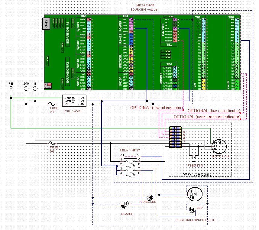

- My preference would be to use a DPST or DPDT mechanical relay, and use the second set of contacts to trigger a pilot light. Would make a nice control panel trinket, and is a good indicator of when the pump is powered with zero LCNC programming required.
- Contact #1 - 240 pump power
- Contact #2 - 24vdc to a yellow "LUBE ON" lamp
- Hot line goes to terminals #1 & #2.
- #1 is switched with the SSR by LCNC using the 7i76E output
- #2 is always-hot, permitting local pump control using the "FEED" button on the pump assy.
- Neutral is internally fused
- Optional
- There's a float switch indicator circuit internal to the way lube assy. Feel free to connect that to an input on the 7i76E so you can trigger an on-screen message to refill the pump.
- These look like dry contacts, so should be fine with the 24VDC to/from 7i76E. But leave disconnected until you power the pump and verify there's no voltage at those terminals.
- Extra-optional, not drawn
- Connect terminal #6 to another 7i76E input and you can have a pump over-pressure alarm
