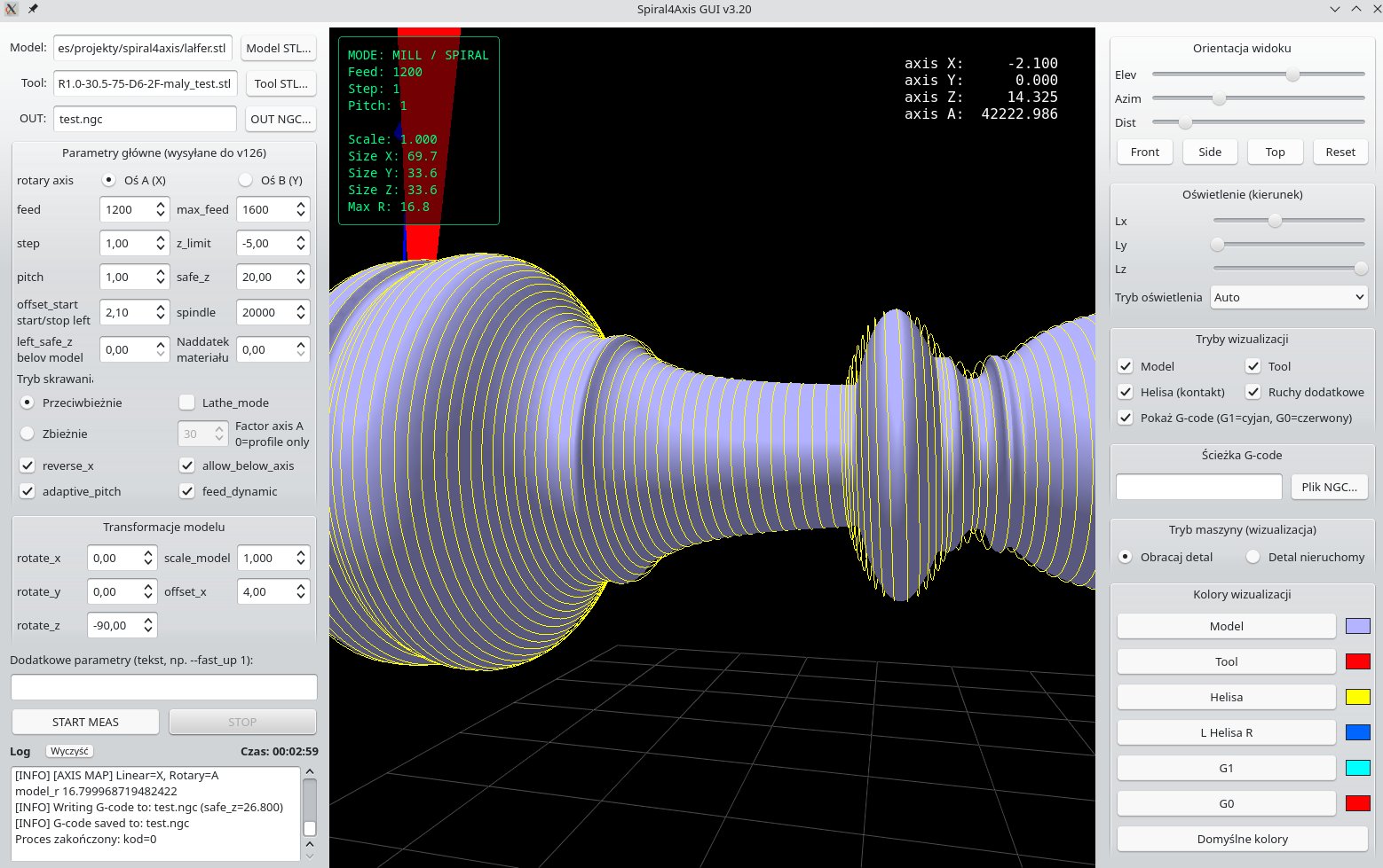

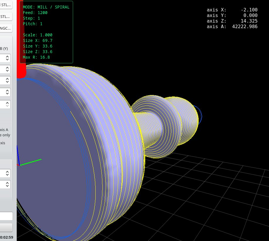

I also use DeskProto, and it's impossible to configure it the way you want. One axis, either X or Y, is always static above the rotation axis, and in that case, you won't be able to create undercuts.
I recently created my own program that could move in both X and Y simultaneously, but so far I haven't succeeded (with a helper, of course). One cool thing I managed to achieve is variable milling density, depending on the slope of the milled slope, so that on flat sections, the milling isn't too dense, but on steep slopes, it's not too sparse. I haven't seen this in other programs, although I haven't seen everything. The program works well, but it won't create undercuts. Maybe someday I'll resume working on true four-axis machining.
