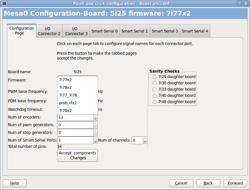

5i25 + 7i77 + 7i64 was created by BruceLayne
First, thank you to those who helped me get my first LinuxCNC retrofit conversion this far. It was mostly the usual suspects. You know who you are. :) I was having trouble getting PNCconf to configure the 5i25, but this info fixed that.
www.linuxcnc.org/index.php/russian/compo...ew&catid=39&id=21670
Now I'm able to read and write the inputs and outputs on the 7i77 that I'm using for the main panel I/O and servo control, as well as most of the I/O on the 7i64 that I'm using as the remote I/O.
The problem I'm having is that PNCconf is autoconfiguring as a 5i25 with two 7i77 boards. It seems to think the 7i64 is a 7i77, so I get configuration options for 24 inputs and 16 outputs and some PWM outputs that aren't on the 7i64, and I'm not getting all of the 7i64's 24 inputs and 24 outputs, which I need.
PNCconf gives me "sanity check" options for 7i29, 7i30, 7i33, 7i40 and 7i48. It initially had the 7i33 option selected, but I deselected it. The firmware pull down list under 5i25 didn't offer 7i77+7i64, so I selected 7i77x2, so I guess that's why it's giving me two 7i77 boards. Am I out of luck until someone creates a firmware XML for 7i77+7i64?
Here's the PNCconf screenshot. The Smart Serial 3 tab is the two banks of 7i77 digital I/O that are actually part of the 7i64, and Smart Serial 4 is the 7i77 PWM outputs, that map to I don't know where on the 7i64.

24 Jul 2012 04:49 #22365 by cmorley
Replied by cmorley on topic Re:5i25 + 7i77 + 7i64
Here is how to get what you want.
on the mesa I/O - config page set the number of encoder to 6 and the number of sserial channels to 3 and press 'accept changes'
this gets rid of the second 7i77 board components and allows them to be GPIO (you will see that on the connector 2 tab)
Now on the connector 3 tab look for the smartserial # 2 combo box. left side second box down.
select the 7i64 board and a tab will appear - 'smart serial #2'
This is the tab to configure the 7i64 board.
This will work as long as you have the current bug fixes available from builbot or by compiling yourself.
If you don't you will have to wait till the next bug fix release which is supposed to come out soon.
Chris
