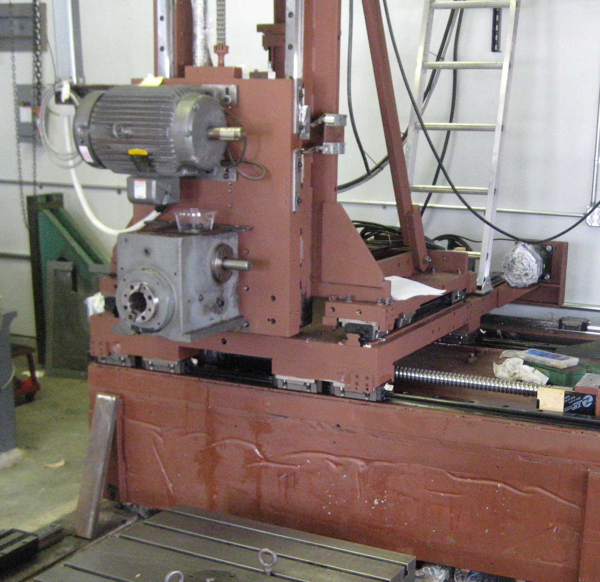

I downloaded some firmware, per previous posts on this forum, but I am not seeing the exact combination of boards that I am using. Would someone kindly point me toward the correct firmware, or suggest alternate boards to use on the pncconf wizard.
I am completely new to linux and would like to concentrate my learning efforts in the right direction.
I have a 3 axis mill with brushless servo motors and a MPG. I bought 5i25, 7i85 and 8i20 at the suggestion of the tech guy at Mesa ,over the telephone.
I would like to get one axis working,for now, and worry about the fancy stuff later.

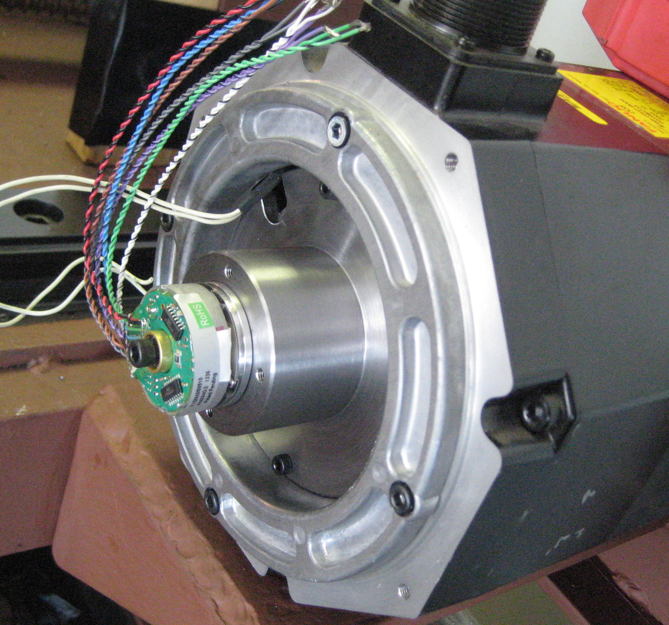

- johns00056
- Posts: 114
- Thank you received: 3
06 Mar 2014 20:45 #44494
by johns00056
Replied by johns00056 on topic firmware 5i25,7i85,8i20 brushless servo drive
The encoder has commutation channel for an 8 pole motor. I replaced the original Fanuc encoder with a Danaher, Dynapar series f15 2048 ppr. and index pulse. It cost about $210.00. I only bought one. If it works I will get 2 more.
I did see a video, on the enc- users- request e-mail list , of someone using a standard fanuc encoder but I have no idea of how they did it.
- Posts: 23527
- Thank you received: 5005
06 Mar 2014 21:11 #44496
The 8i20 takes a rotor angle and a current value from LinuxCNC. These numbers need to be calculated by the bldc HAL component.
www.linuxcnc.org/docs/html/man/man9/bldc.9.html
Ideally bldc will use the encoder feedback to give smooth, sinusoidal commutation, but it can't do that without a startup position reference. It can get this in a number of ways.
If you look at the documentation above you will see that "bldc" can accept either conventional Hall signals, or the special 4-channel Fanuc system.
So, you should be able to use the original Fanuc encoders and save some money.

- johns00056
- Posts: 114
07 Mar 2014 03:48 #44511
by johns00056
I think that it would be way too complicated for me to try and use the Fanuc encoders. I can"t even figure out how to use the ini file that PCW kindly sent me, in another thread.
I did use one of Pico Systems Fanuc encoder converters to run one of the motors on the bench , But that was three years ago and it seems that I have forgotten everything that I learned about linux at that time.
