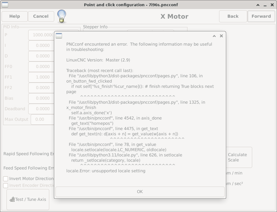

Hello All,
I am trying to connect a Mesa 7i96s on a new installation.
I do not have much experience with Linux.
Running 6.1.0-40-rt-amd64
This error comes popping up, can any one give me a reason why this is happening?
Thank you,
Antony Manuel.

Looks like pncconf will not work with your locale setting
You may have to temporarily set the locale to en_US to work
around this issue.
around this issue.

Also, UTF-8 locale is used by LinuxCNC, i think, but i never checked, i just set all my computer to en_US and UTF-8 and never have issues.

Yes the hack works, I had to reinstall with the new settings.

AFAIK, it's just a pncconf issue.
Another option is to use MesaCT
