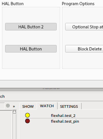

So I'm struggling with connecting a QPushButton to HAL using Dynamic Properties to define the HAL pin type.
This is my current code that creates the HAL pins and they show up in halshow but I'm stumped as how to make the button clicked (or other signals) to change the HAL value.
def setup_hal_buttons(parent):
    for button in parent.findChildren(QPushButton):
        if button.property('function') == 'hal_pin':
            props = button.dynamicPropertyNames()
            for prop in props:
                prop = str(prop, 'utf-8')
                if prop.startswith('pin_'):
                    #print(prop)
                    pin_settings = button.property(prop).split(',')
                    name = button.objectName()
                    #print(name)
                    pin_name = pin_settings[0]
                    pin_type = getattr(hal, f'{pin_settings[1].upper().strip()}')
                    pin_dir = getattr(hal, f'{pin_settings[2].upper().strip()}')
                    setattr(parent, f'{prop}', parent.halcomp.newpin(pin_name, pin_type, pin_dir))
                    getattr(parent, f'{name}').toggled.connect(lambda: getattr(parent, f'{prop}').set(getattr(parent, f'{name}').isChecked()))
    parent.halcomp.ready()
For some reason only the last button found with a Dynamic Property of function is toggling the pin in halshow. I gotta be missing something simple...

01 May 2024 14:23 #299467 by JT
Replied by JT on topic Connect PyQt Button to HAL at runtime
Adding a couple of debug prints I can see that both buttons and pins are unique.
<PyQt6.QtWidgets.QPushButton object at 0x7ff158ceea70>
<hal.Pin object at 0x7ff15c8d95d0>
<PyQt6.QtWidgets.QPushButton object at 0x7ff158ceeb00>
<hal.Pin object at 0x7ff15c8d9210>
                    #print(prop)
                    #print(name)
                    print(getattr(parent, f'{name}'))
                    print(getattr(parent, f'{prop}'))

02 May 2024 12:56 - 02 May 2024 12:57 #299548 by JT
Should I make the connection between the button and the HAL pin in a different manner?
I've tried a few things from the link above and while this works on the last button it still does not work on the first button found (only 2 buttons).
getattr(parent, f'{name}').pressed.connect(lambda num=n: getattr(parent, f'{prop}').set(getattr(parent, f'{name}').isDown()))
getattr(parent, f'{name}').released.connect(lambda num=n: getattr(parent, f'{prop}').set(getattr(parent, f'{name}').isDown()))

02 May 2024 13:38 - 02 May 2024 13:43 #299550 by JT
Well lambda be damnda I think this will work.
getattr(parent, f'{name}').pressed.connect(partial(utilities.hal_pins, parent, getattr(parent, f'{prop}')))
getattr(parent, f'{name}').released.connect(partial(utilities.hal_pins, parent, getattr(parent, f'{prop}')))
# the function
def hal_pins(parent, hal_pin):
	hal_pin.set(parent.sender().isDown())
JT

02 May 2024 14:25 #299555 by cmorley
Replied by cmorley on topic Connect PyQt Button to HAL at runtime
getattr(parent, f'{name}').pressed.connect(lambda parent=parent,prop=prop,name=name: getattr(parent, f'{prop}').set(getattr(parent, f'{name}').isDown()))
I think this strange looking code should work too.
The following user(s) said Thank You: JT
