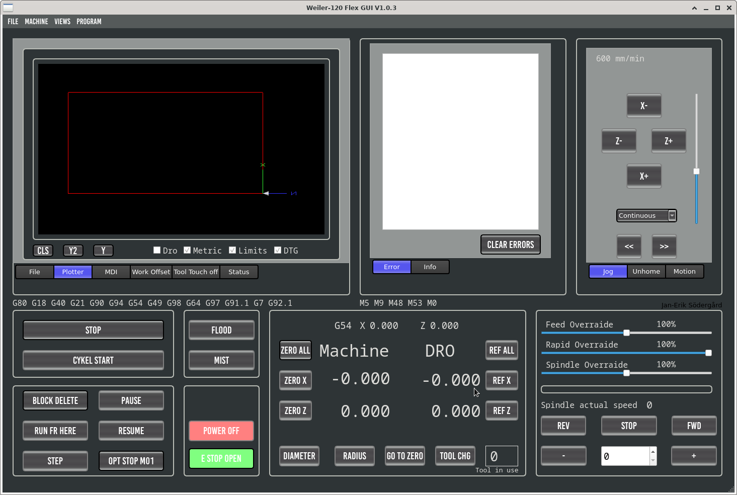

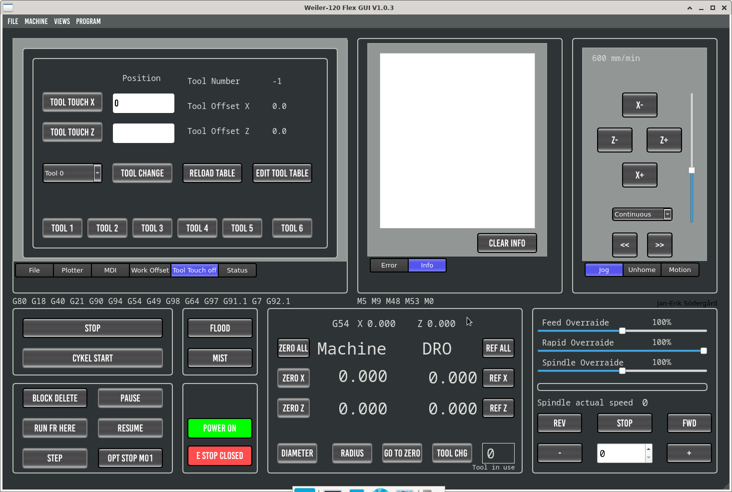

As I understand it, it is only possible to use one touchoff_le and one tool_touchoff_le in Flex gui. I want to use
a touchoff_le and a tool_touchoff_le for each axis is it possible?
Have made a Flex gui for the lathe but the plotter view is up side down how do I get it changed.
Like the Flex gui for its simplicity to make a nice looking gui.

Right now you can have a tool touch off button for each axis but the line edit to enter the touch off value there is only one.
What is your use case for needing multiple line edits?
Can you post a screen shot of your gui?

Do you have LATHE = 1 in the [DISPLAY] section?
I'm looking into why the plotter does not show the correct view for a lathe like Axis does.
The Diameter/Radius checkbox works with LATHE = 1.
JT
JT

I see what you mean about the tool touch off and that makes sense. I'll see about adding that in the morning.

You can also change the work touch off it should also be one for each axis
