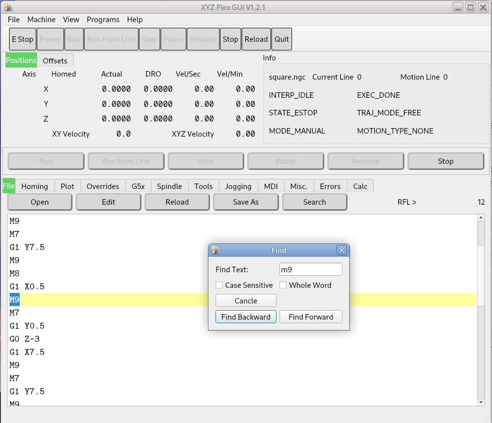

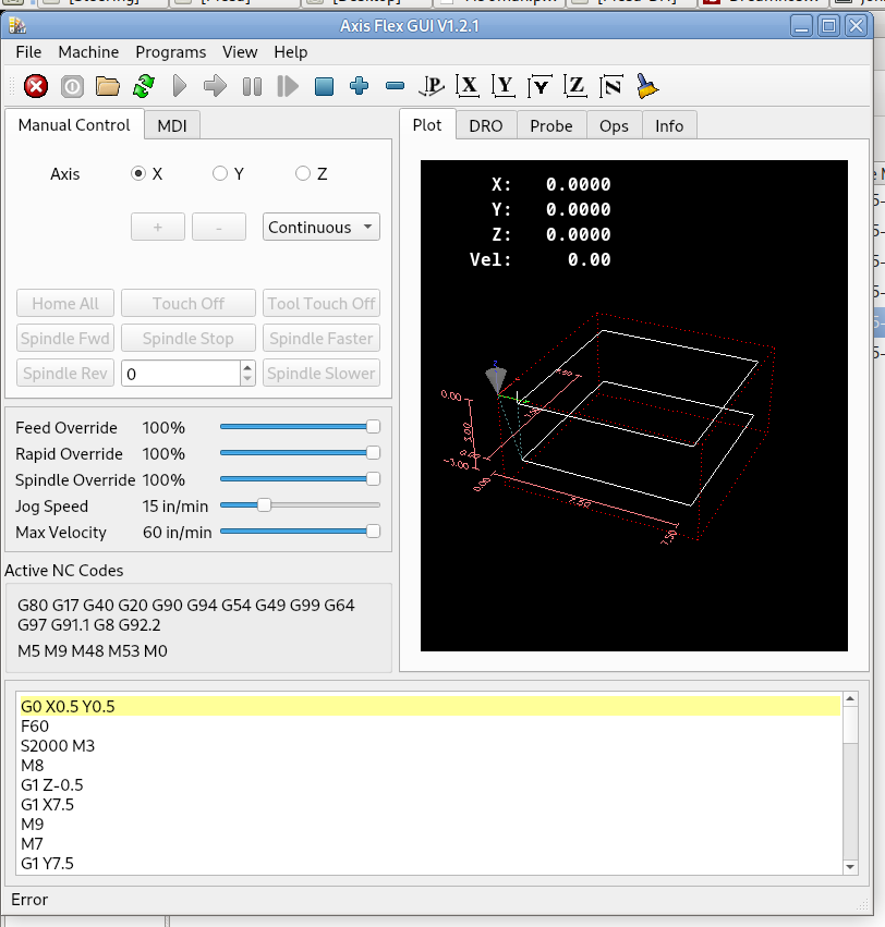

Excellent! I just got my new mill converted to LinuxCNC, and was thinking that maybe I should tackle the gui before going too much further. Did a search to see how you were doing, and look! A new release.
I like the idea of starting with an axis-style gui -- after all, it's what I'm used to.
Looking forward to giving it a try!

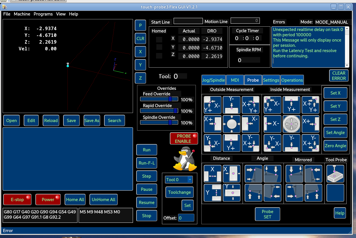

Replied by pgf on topic Flex GUI 1.2.1 Released
Gave the new axis-like UI a spin this morning. Looks and feels good. I noticed the buttons (e-stop and machine-on, in particular) don't have the 3D "I'm pushed" look when they're pushed released. A small thing, but there's no other visual way to tell the state.
I need to come up to speed on modifying these UIs, so I can make changes and flesh it out. (I know, I know... watch the videos.
) The big missing piece for me right now is a probing/touch-off screen. My current probing setup is pyvcp, so clearly it will need to be redone. But I'll bet you already have fully functional probe screens just waiting to be dropped in.

Replied by JT on topic Flex GUI 1.2.1 Released
The Touch Probe 3 example has full working probe routines that you can drag and drop onto your gui.Gave the new axis-like UI a spin this morning. Looks and feels good. I noticed the buttons (e-stop and machine-on, in particular) don't have the 3D "I'm pushed" look when they're pushed released. A small thing, but there's no other visual way to tell the state.
I need to come up to speed on modifying these UIs, so I can make changes and flesh it out. (I know, I know... watch the videos.) The big missing piece for me right now is a probing/touch-off screen. My current probing setup is pyvcp, so clearly it will need to be redone. But I'll bet you already have fully functional probe screens just waiting to be dropped in.
