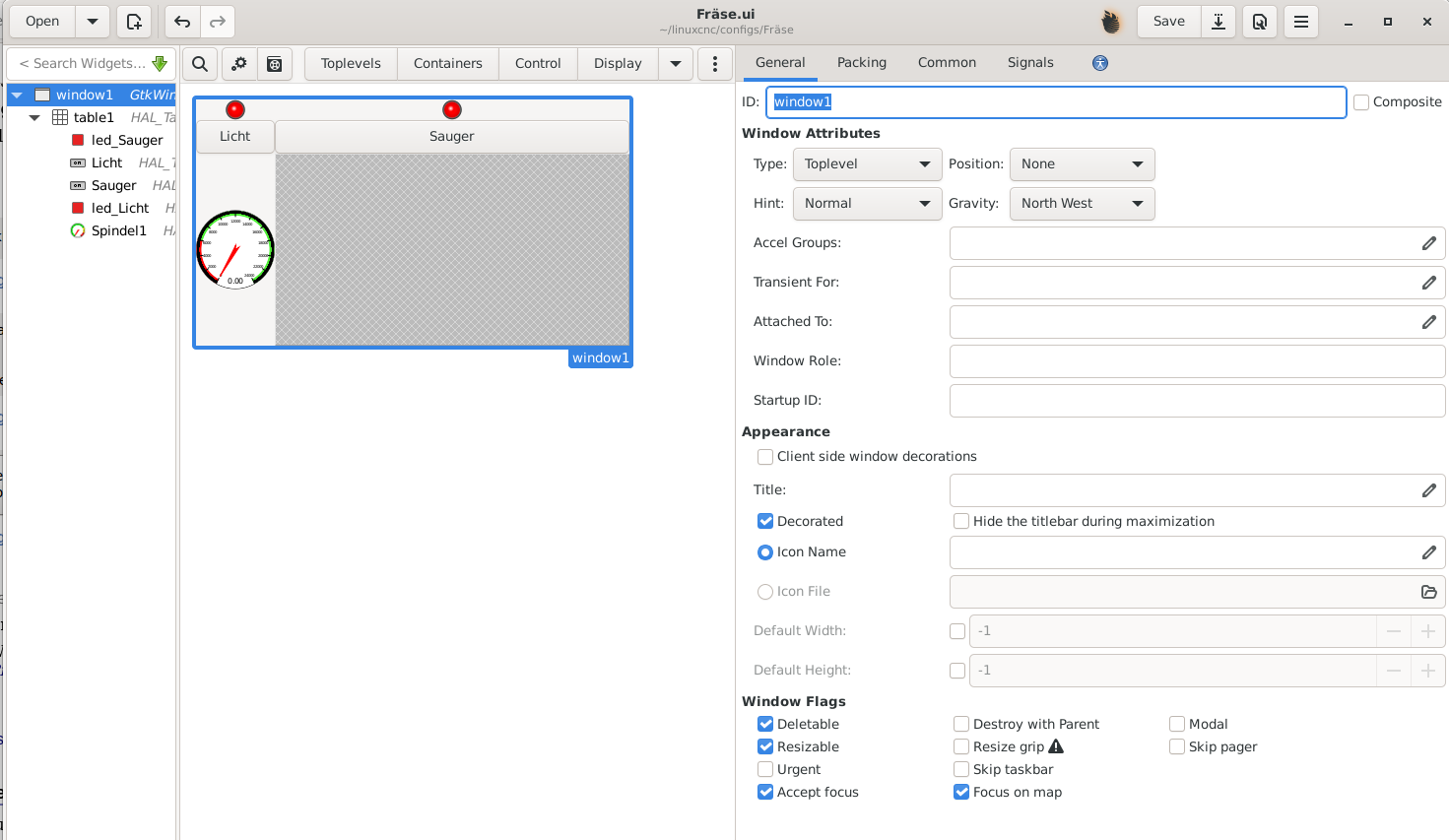

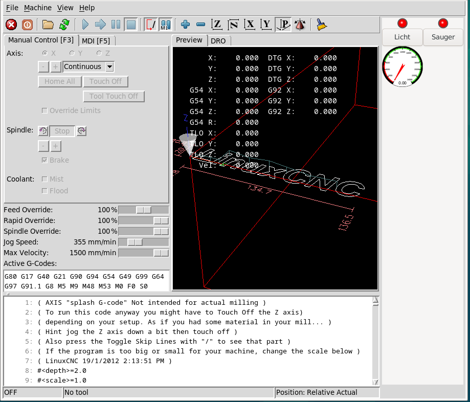

Hello,
i created a small ui with glade with two leds, two buttons and a Hal_Meter. How can i enlarge the Hal_Meter? Attached is a screenshot of my main window.

Try a different layout with a 2-element V-box with a 2-element H-box in the top box.
I think that your meter is being constrained to be same width as "Licht" as it is in the same column.

Thanks, that works
